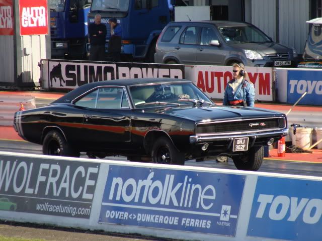

I have experienced something like that when I didn't have enough stall speed or rear gearing 3.91 gears.Brutus wrote:How's that work Mick?Mick wrote: Higher top end mph is sometimes down to wheel spin
Mick
Comparing my runs with and without slicks;
With slicks my 60fts were better but ET and MPH were down despite the slicks being 2 inches taller.
On the BFG radials my 60fts were worse but it picked up mph and a better ET.
I think the wheelspin and slightly smaller diameter tyre was getting me up the power curve better and gave me higher rpms up the second half of the strip.
