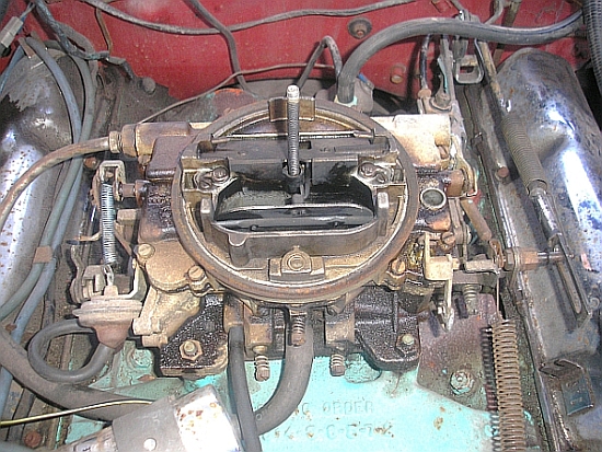

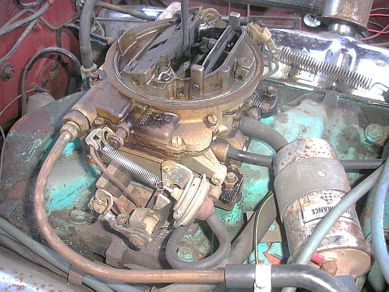

Can anyone tell me what make and model carb this is please?
Is there a rebuild kit available for it or, would I be better off just replacing it with a new carb. if so, what's the best carb to use?
The current set up is a 383 with 727 auto, all standard.
TIA
TIA

its one of the carters that Edelbrock based their performer AVS carbs on
came in 500 650 (2 small and two big holes) and 800 cfm (4 bloody big holes)
but not a big as you get in the ones with the plastic body and its not one o them
good carb
no joints or gaskets below the water line
no diaphragms to blow out
jets and rods and springs
tuning kits £40-50 from real steel and others
good carb

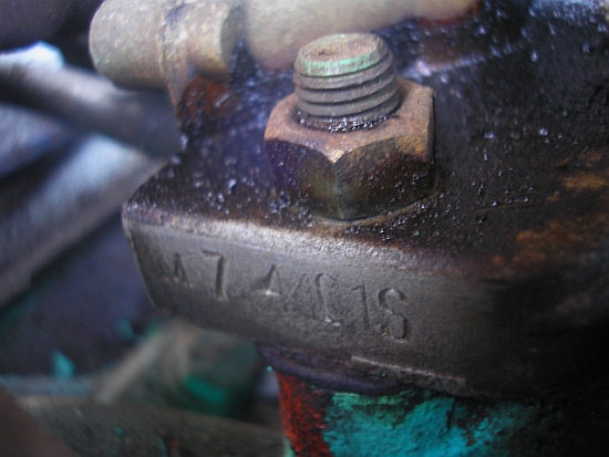

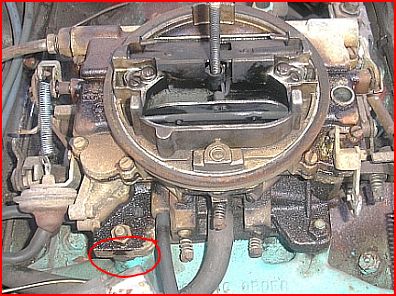

4401 AVS " 383 This one

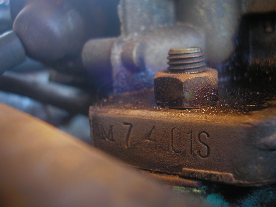

Thanks VGVIP, had a look and took a couple of pics, it looks as though the number is "M7 4401S", at least as far as we can make out it is.
If anyone can confirm or advise differently, that would be great.
