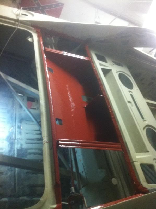

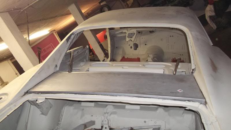

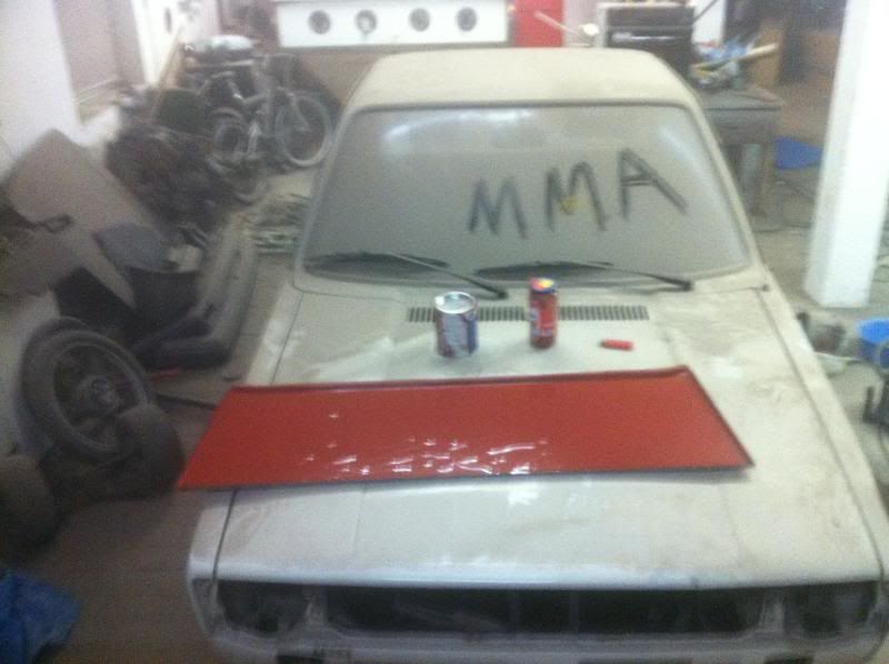

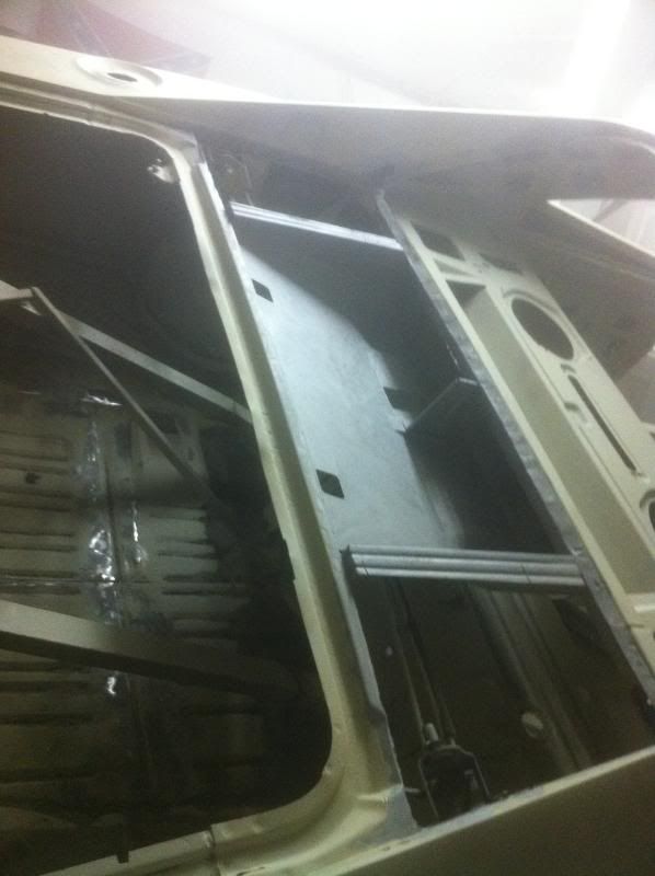

So cut out sail panel new panel from year-one good fit (thanks sinny)

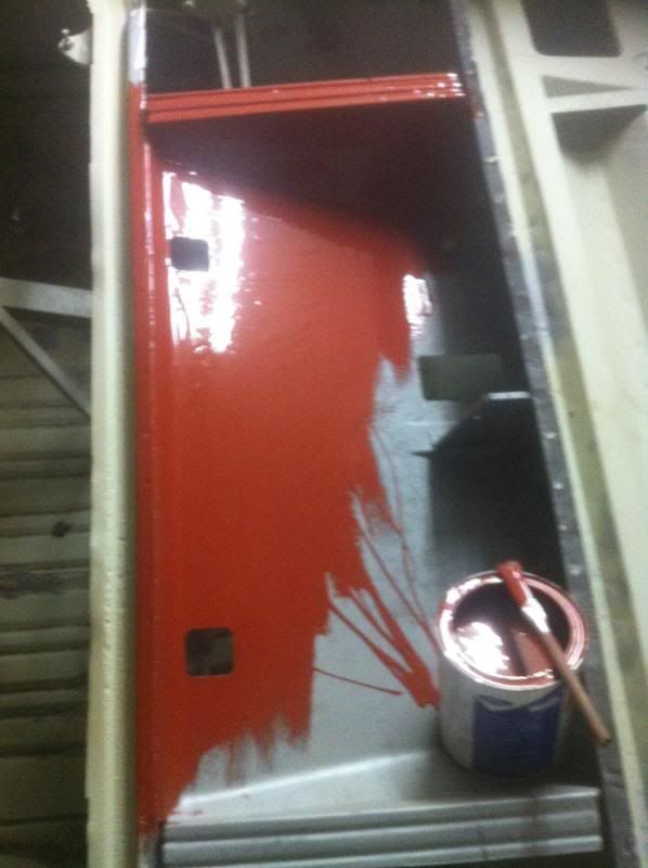

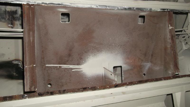

Under panel another panel it had suface rust
so i thought ahhhh give that a little blast wont take to long just quick so not to much sand everywhere
Well
Dont not ever ever sand blast outside of a sand blasting tank.
It went everywhere
and i mean Bananarama! everywhere
I think i have sand behind my eyes
and inside my girlfriend
10min to blast hours to clean
Kev im sorry but the new camera that was 10meters away is now full of sand and wont work (tw@t) so we are back to poo pic for the mo.
Also gave everything a coat of red
Learning :oops:
