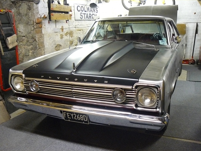

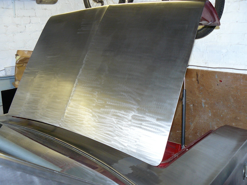

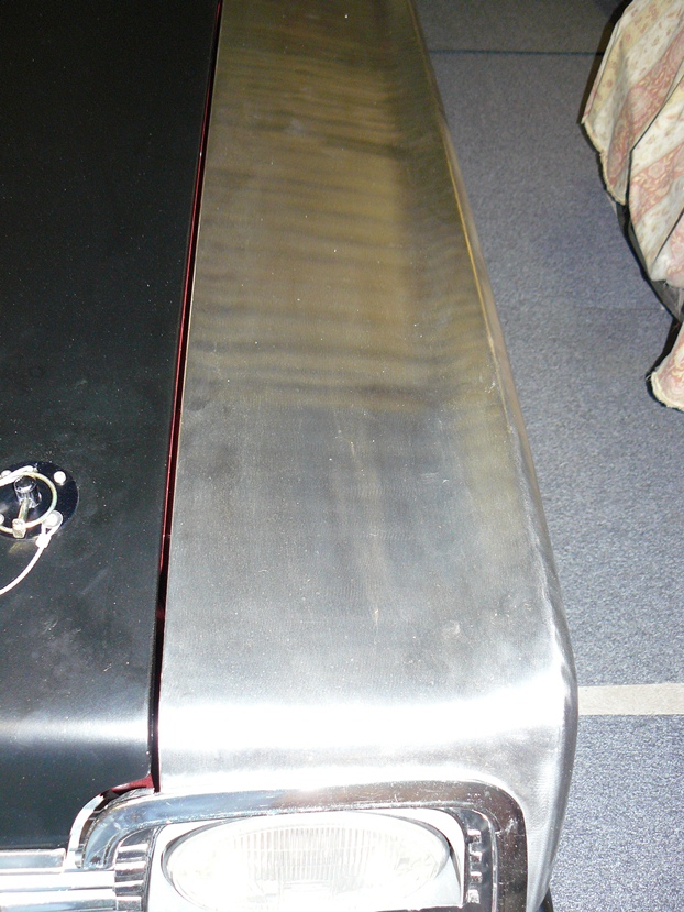

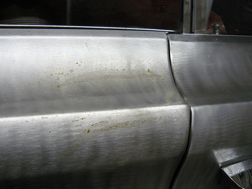

Took the car out for a hoon yesterday. Was out in the rain for an hour. Parked up in the garage still wet and today, apart from where I'd cleaned off some bird crap the whole car is still shiny bare metal :thumbright:

Car looks great Paul!

Have to say Paul, that Cowl Scoop suits that car 8-) 8-)

Spary it on, apply lightly with paper towel. Let it go off for a couple of days. Its then dry to touch, just leaves a light sheen. Re appply if a) rust appears
b) water stops beading on it.
Spary liberall into/onto underside and chassis
Dave81, if you look under the front wings on the Dart I'm sure you'll see dark patches where I sprayed Gibbs on there as well as elsewhere.
It's not a miracle worker, but its good insurance.
If you have good paint, use good wax, not Gibbs!
