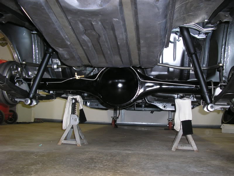

you may find that the 7.25 didn't have a breather on it, mine didn't, just a bolt.
As you can see on my axle I've run the 7.25 brake lines just fine, the block lines up with the breather hole in the axle, it really was a straight swap over

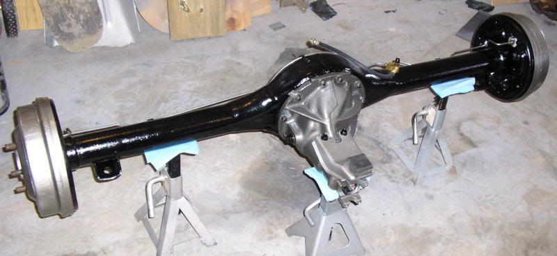

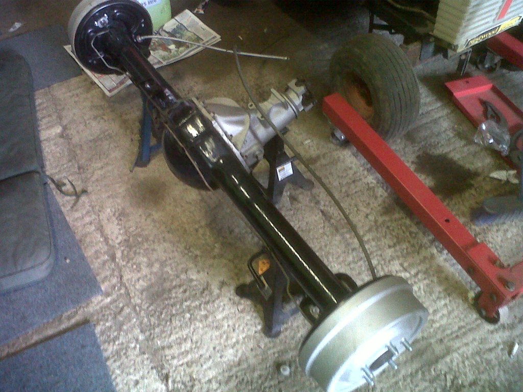

You can make out the brass block in these photos from a build on my message board.
I think some years the brass block was part of the flexy hose. Other years it screwed in.
These are the bits...
brake splitter block.JPG (12.16 KiB) Viewed 991 times
axle vent bolt.JPG (12.93 KiB) Viewed 991 times
