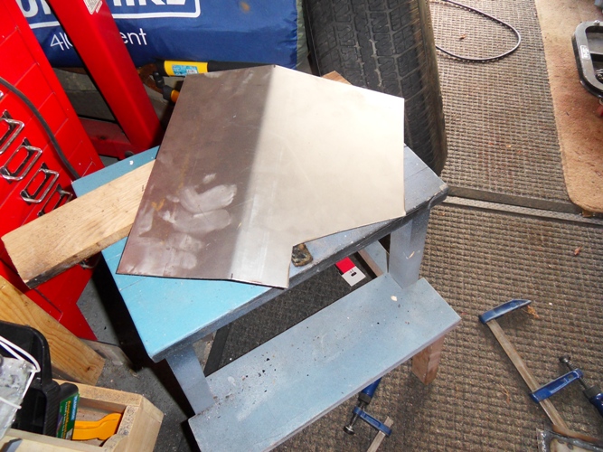

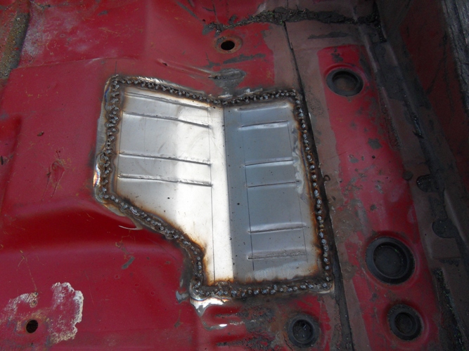

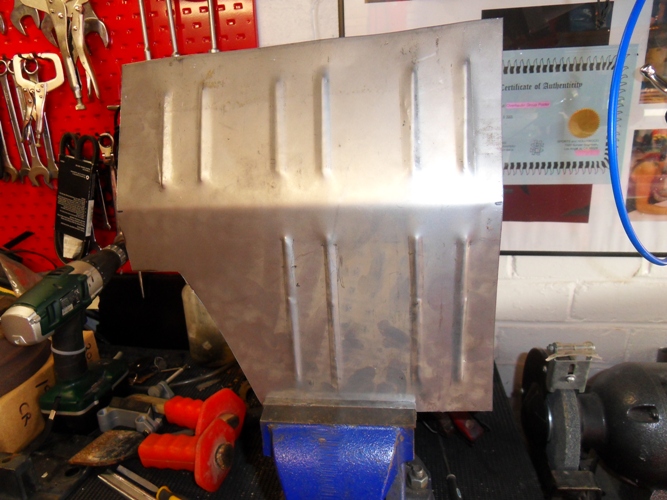

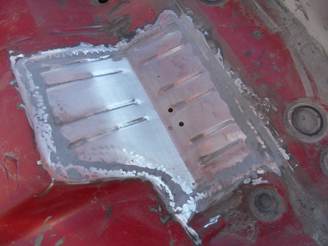

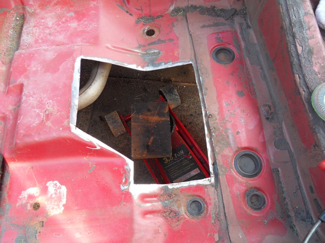

Right... the learning curve got really steep this morning. Tried, unsuccessfully, to weld in the patch panel I made up. Nightmare to be honest and was a mistake, at my level, to try to weld in along the bead line. Turned the floor into a culinder along that edge :roll:
Back to the drawing board and decided to cut a bigger section out with flat edges. Bigger repair but much easier for me to tackle. Made up a replacement panel and welded it in before work this afternoon. Certainly not very neat or pretty but solid and should tidy up ok with the sanding disc tomorrow. It is perfectly flush at the weld...the black isnt gaps its like a sooty deposit. The welds had little flames on them that sooted up. Not sure what that is as I cleaned all the edges up before welding??? Should clean up though...God bless angle grinders!!
:D
Cheers Steve :thumbright:

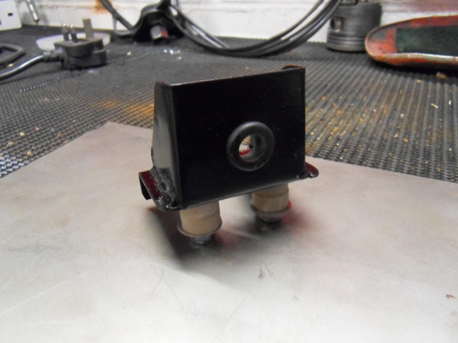

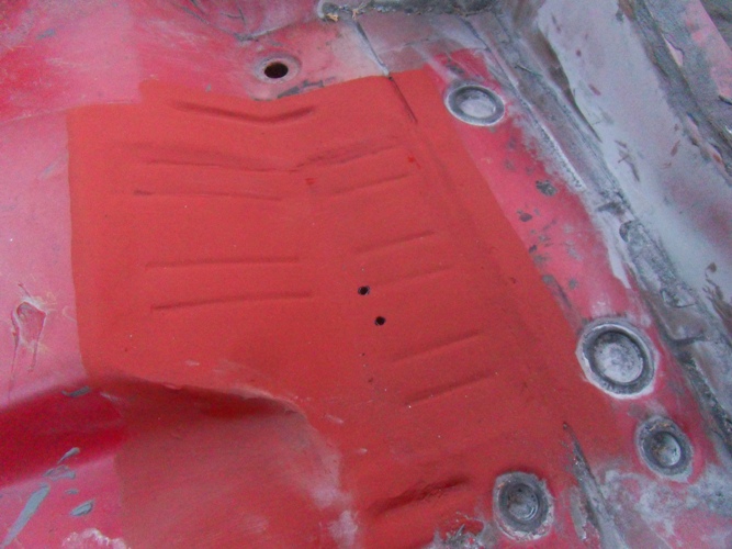

....welds in floorpan smoothed out today and drilled for parking brake cable bracket. Primed and undersealed. Will fit bracket tomorrow.

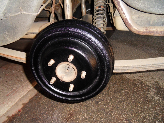

Had a break from grinding etc and gave the rear brake drum the once over. Cleaned the shoes, cylinders etrc as well.
Cut out the drivers side lower rear quarter panel ready to make up new one tomorrow if the weather is ok....

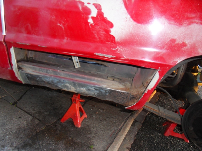

rear lower drivers side quarter cut out...

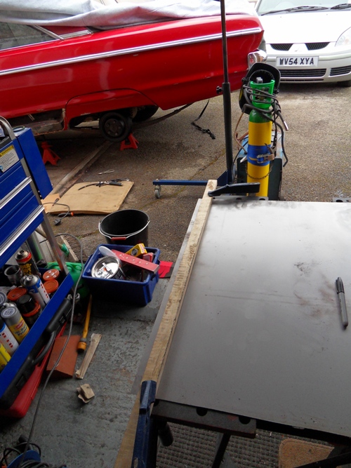

Had quite a productive end to the week today before the rain set in...

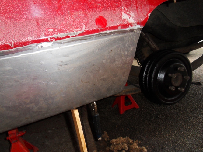

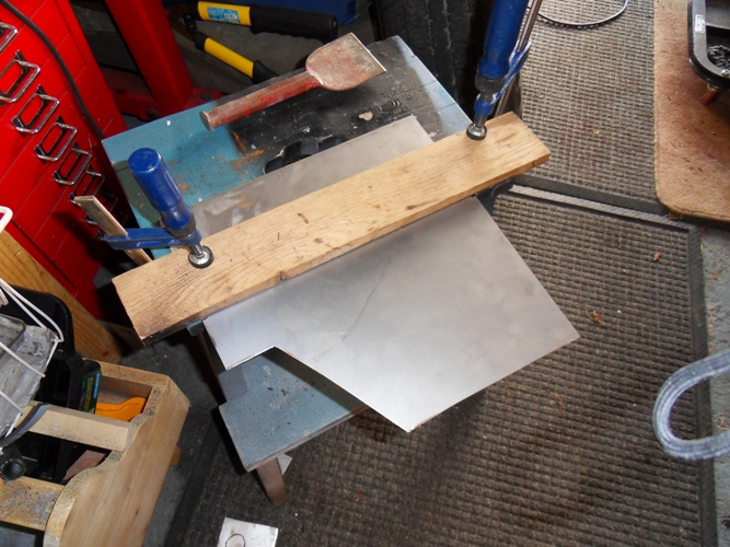

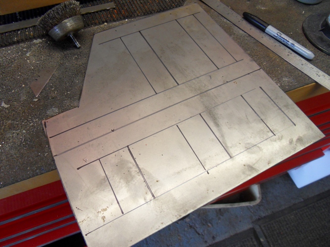

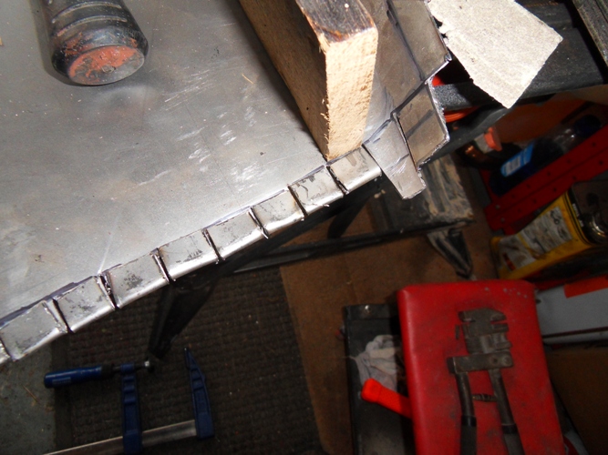

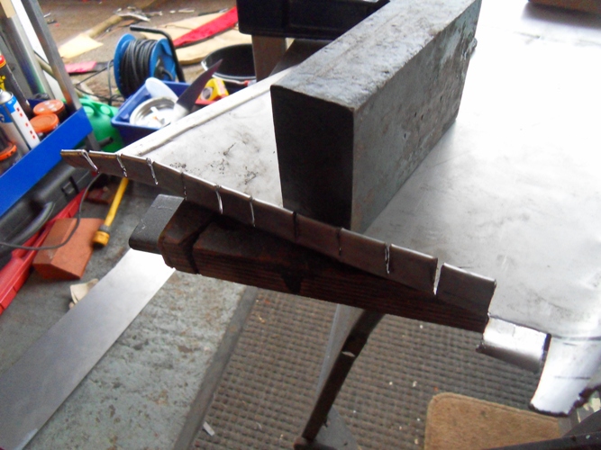

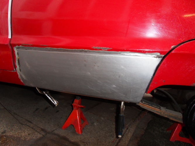

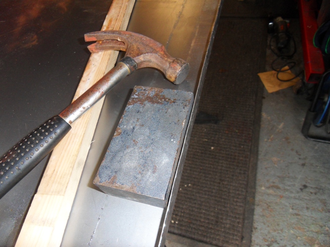

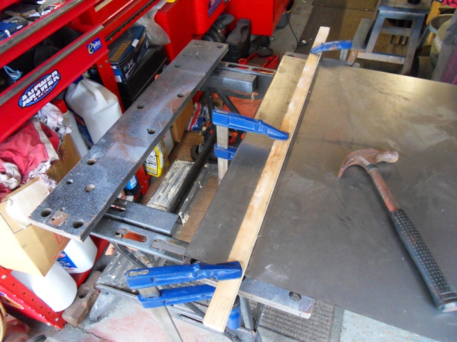

Made up a drivers side quarter patch panel as the original repair area was showing signs of rot....
Made same as the pass side but wasnt able to save the rear lip unfortunately so the panel incorporates it. Fits ok but I havent got the lower rear radius quite right so will have to fettle it. Next job is to weld up the sections on the lip with a thin plate behind it then grind it smooth before fitting. It looks messy but its the only way I could think of to put the lip in and still be able the curve the panel to match the body line. Should be ok when its welded up in next few days. Off Thursday so hoping to get it fitted then...I paid more attention to getting the lines straight this time and the fit is better.

Contour of the rear arch looks really good in the last pic Steve.
