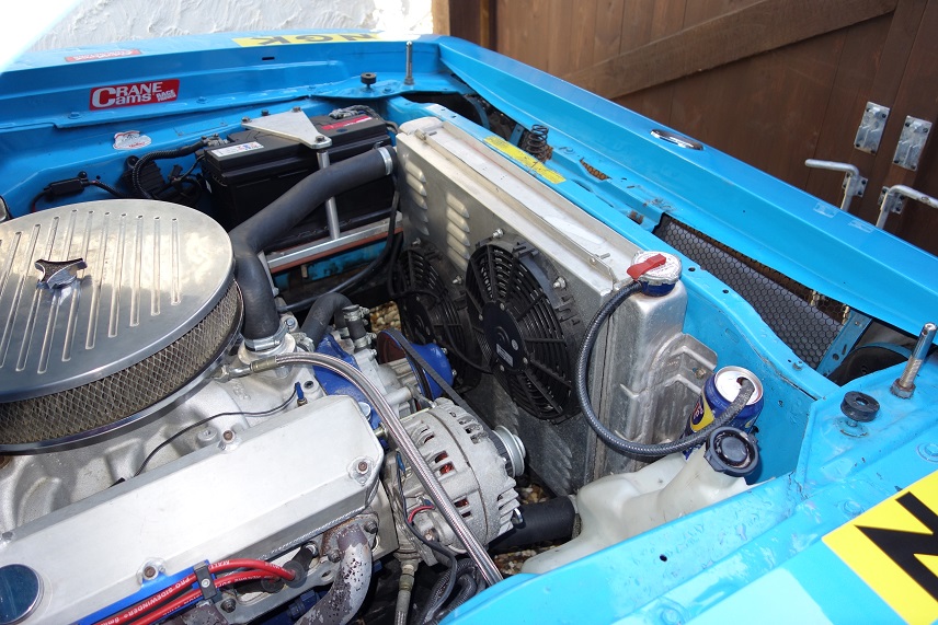

This is my set up 2x12" fans Ali rad and shroud run off a thermo switch that has a temperature probe that sits in between the veins of the rad, I have a switch I can over ride it so it is on permanently if I want
*MMA-609*
"Built to be driven!"
Why me??? :banghead:

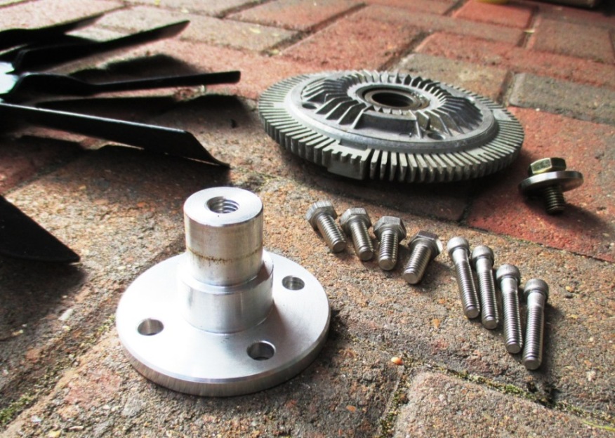

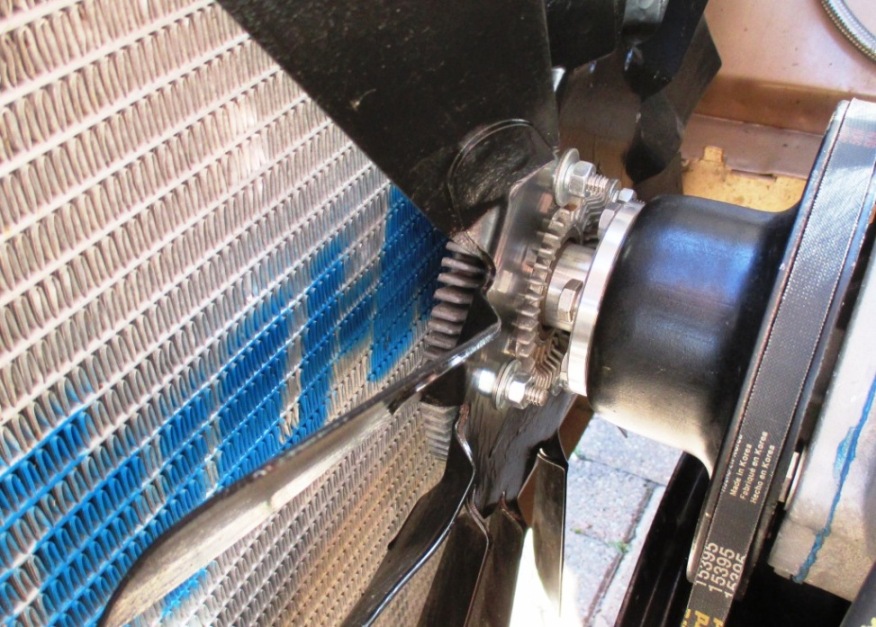

I wanted to fit a viscous fan, however that requires cutting of the slam panel in an A Body / BB car. To overcome this I have fitted a Jag XJ6 viscous coupling. TrevD made a adaptor although I did have to search about a bit for a left hand bolt that secures the coupling to it.
It works a treat ;)
