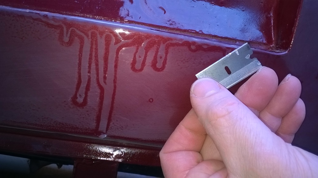

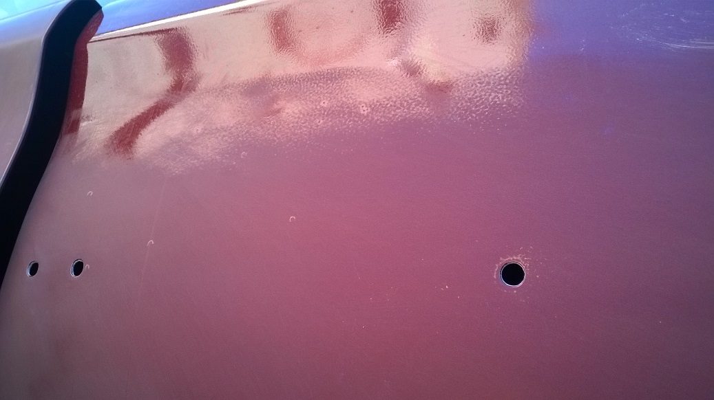

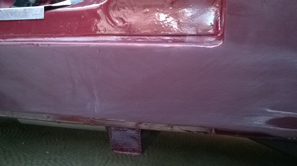

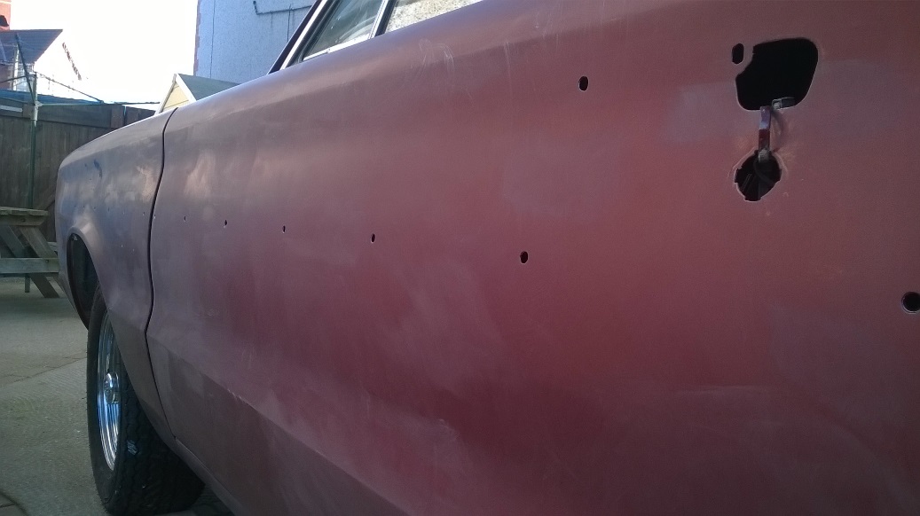

As I've been cracking on I thought I'd share some pics :D
1. What it looks live after the first pass with 1200. Some orange peel still visible and the little tell-tale circles where the dust spots were.
2. One flank lovely and flat.
3. Trimming the top off a run.
4. VERY careful sanding with 600, then 1200 results in the run gone (this is rare, most of 'em we broke through the paint!)
Tomorrow I should get the last couple of panels done. Then we need to touch up the break-throughs and few small flaws and it's buffing time :thumbright:
