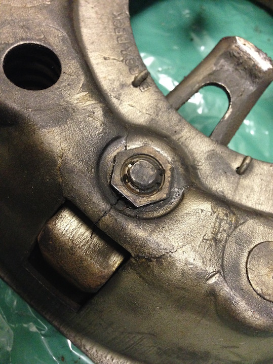

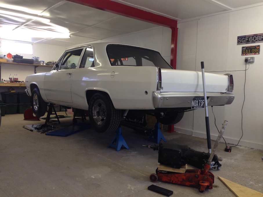

Clutch thrash. Cover had fatigued around all 3 levers, otherwise all good. Clutch looks recent, no makers name I suspect the cover is a rebuilt one. New clutch going in next week. Found a new flywheel in there as well as the pivot and throwout arm, can't believe the amount of new parts I've found on this car.

Good that you found it before you gave it the beans.
What's it like working on a car a stone's throw from your house?? ;) ;)
Posts: 14459
It's brilliant Pete, I can't tell you how much of a difference it's made.

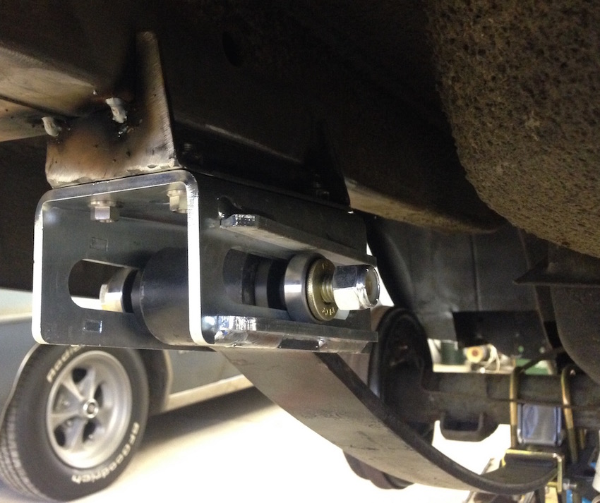

Started finishing off the rear spring relocation this week. I fitted the boxes for the front mount into the chassis rail a couple of years back when I did the chassis ties and left the rest of the job until now. Calvert sliders replace the rear shackles, as this would have lowered the car an inch, I had to incorporate a spacer into the mounting bracket to keep the ride height the same. Once tacked I'll check to make sure I've allowed enough rearward movement before I finish welding them up.

Whats the advantages on this setup Blue verses standard shackles?
