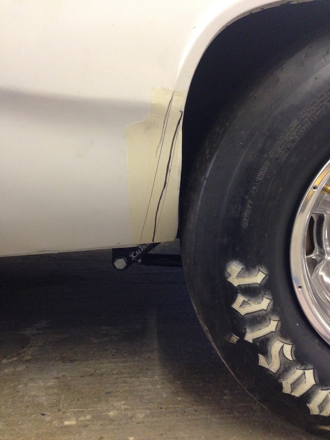

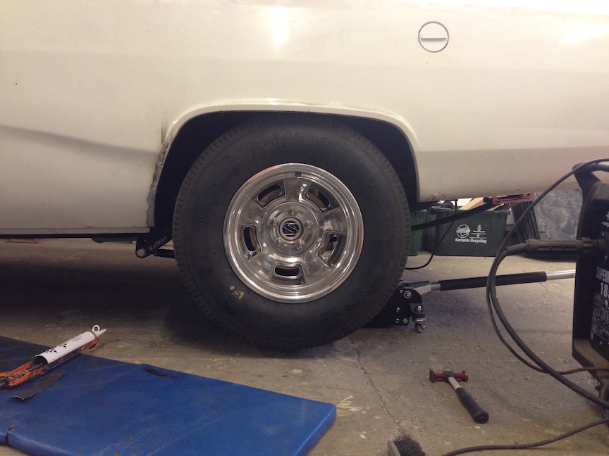

Tyre clearance at the rear is tight so time to deal with that.
Street tyres would be OK but you have to have space for slicks to grow in diameter as RPM increases.

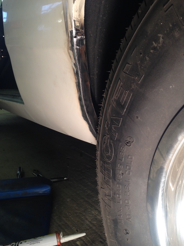

I like to see 1.5" to 2" clearance and I didn't have that at the front edge. After a bit of trial and error and a few goes I got a shape I was happy with.
Made a cardboard template to get the other side the same, took a deep breath and had at it with a cutting disc.
Welded in a new return, trimmed to shape and it's pretty much done. I'll do the other side Tomorrow.
I'll trim the rear edge a little to even things up when I do the rust repairs on the lower 1/4".

Pete wrote:Good progress.
The interesting aspect for me is whether the gap will be the same on the other side, given Ma Mopar's legendary build quality.
It's not but I'm measuring from the tyre so it will be when I've cut it.

The line you cut looks bang on...
