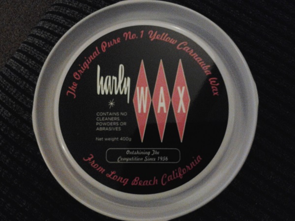

Was over at AndyR's house last week as he was prepping his Fury for the Nats. It was gleaming and he told me he used 'Harly Wax' to finish her off.
I ordered some off the interweb and it arrived today. Its a yellow carnauba wax and must be good as its from Long Beach in California.

Harly Wax is very good as long as you pre wax the car with something else as theres no abrasives in it all, it wont even remove a dried raindrop from the car, ive often used it on dark coloured cars, you can keep building it up and end up with a really deep shine

Gotcha Andy....I plan to use a clay bar first then this wax.... would that work ok??

You probably still need a pre wax or cleaner wax to take off any water residue from the clay baring, the Harley Wax won't lift any dirt off
