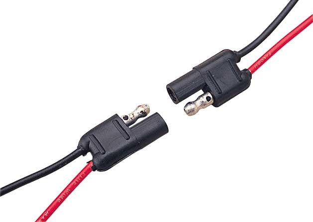

this is worth a check as i had a break inside the rubber block to the distributor, had nothing on cranking but would fire as you brought the key back and sometimes a backfire and then other times fire straight up !!
mopar wiring plug.jpg (24.98 KiB) Viewed 4377 times
keep it mopar !

I bet that took some finding, Jim. Thanks, I'll check that too
challenger
Posts: 881
Post by challenger »
it certainly did !! replaced everything electrical, then took whole engine bay loom out to check every wire at diff points
keep it mopar !
