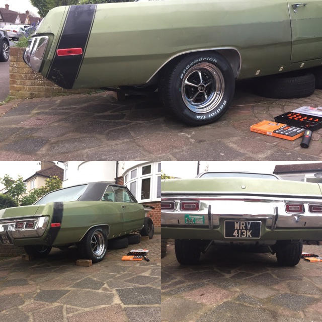

Will do, I was planning to get them from there. I'm going to see if I have some tyres at work in the size I think will fit, push the cardboard wheel into them and slowly lower the car until the tyre barely touches the floor and check the clearance. I think based on my measurements 225/65/15's should work
This is on my 72 Dart Currently:
205/65/15 Front
235/60/15 Rear
Reality is with most Mopars the Diff is not centered.
235s fit perfectly without rubbing.
On the one side im sure I could have got a 255 in but not on the Passenger side.
The wheels are 15x7 in Steels with 4" BS.

My Dart ended up with exactly the same - Or I too could have run 1 x 255 and 1 x 235!!!

Dave I like the stance of the dart, thanks for posting the picture. I made a cardboard tyre tonight as well 235/50/16 and the clearance looks spot on so I think my decision has been made!
Thanks for everyone's help, input and advice.

Post by rossk »
Well they fit, and I think they look pretty good!!

Posts: 22176
Good news! 235's??? ;)
rossk
Posts: 199
Joined: Wed Aug 31, 16 1:27 pm
Location: Watford
Post by rossk »
Yes Pete, 235/60/15
