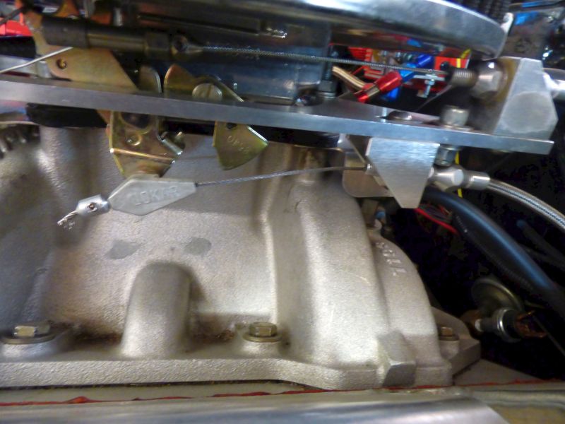

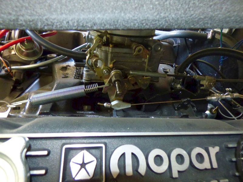

Post up some pics of your set ups if you can ,I have them on two cars one I used a throttle bracket,and throttle cable ,and kickdown from Lokor , and the other I modified some stock parts to make it work , they work great for me

Thanks for the pics Drew.
Went out and road tested this morning. Kick down was a bit drawn out so adjusted cable to get more tension and an immediate improvement. Kickdown works fine as it should.
Jobs a good 'un. :thumbright:
