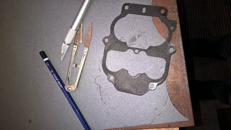

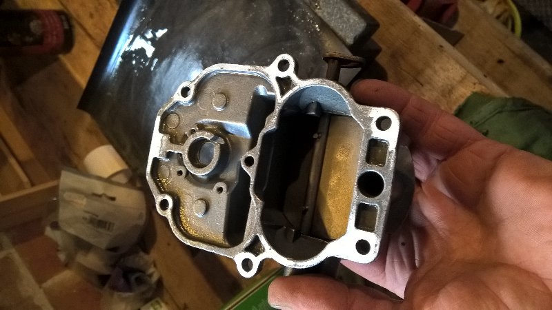

I've found the cause of a persistent leak on the carb- the cover was badly distorted from over tightening.
Some careful twonking with a hammer and a home-made gasket fixed it
Sorry about the upside-down pic as usual ...

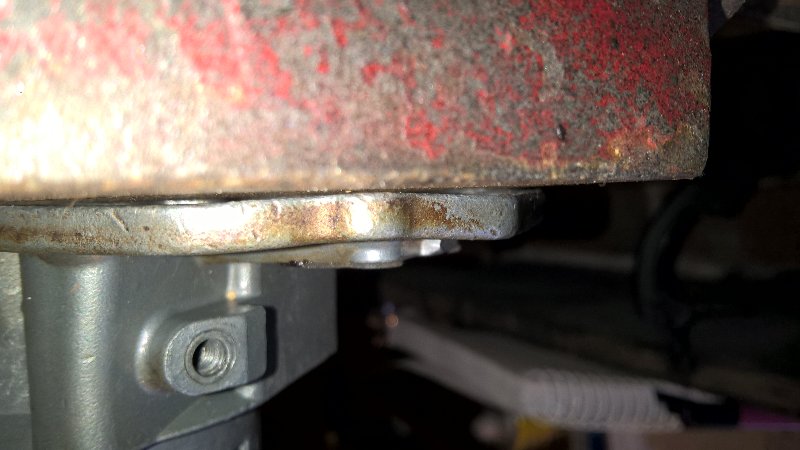

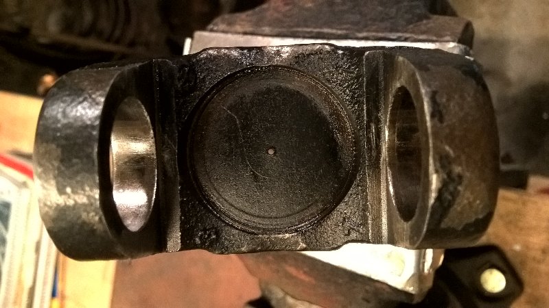

I've had a persistent leak from the back of the trans for months and it's been driving me nuts. I've replaced the rear seal 3 times and it keeps coming back!
Well I looked under Dusty earlier and noticed that the yoke where it slots into the trans was bone dry, rusty even, but the fluid was dripping from the uj! I just pulled the prop and found a teeny hole in the middle. Is this supposed to be there? I'm guessing it's to relieve pressure as the shaft slides in and out, so why is mine leaking fluid? Like a pint every couple of weeks! Will I do damage if I bung the hole up?
- WP_20180315_20_05_26_Pro.jpg (142.56 KiB) Viewed 5261 times
Re: db's 1970 DODGE A108 Sportsman van
Well the leak has stopped! How bizarre.

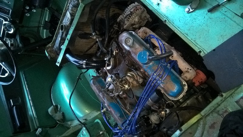

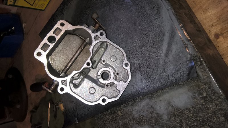

Today I took the doghouse off to knock off a few jobs. Very glad the engine is indoors, it was bloody freezing!
I took the distortion out of the carb top with wet n dry on a granite slab. New rocker gaskets, new rad top hose, new ht leads. Tomorrow I'll patch where the sound deadening has been melted by the exhaust, and see if I can get at the heater matrix which I think is clogged up as it does bugger all!

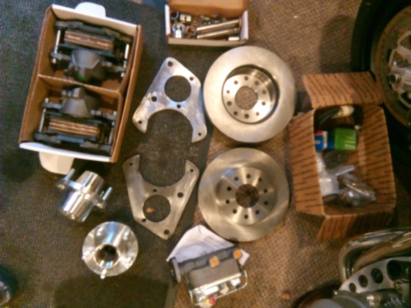

I bought this disc conversion last year but with the Belve fire, etc, I've had no chance to install it.
Well, as soon as the rain stops, it's happening!

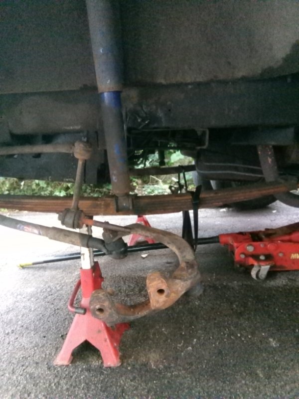

I'll replace the kingpins too while the front end is apart, a mate has offered to help- he's done a few so he knows what he's doing.

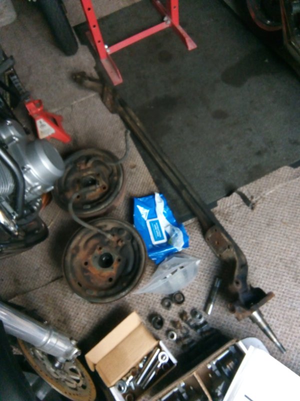

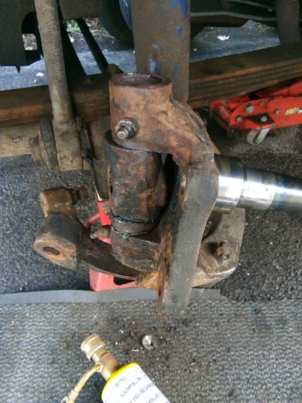

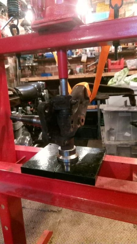

Spent most of today stripping off the drums, hubs and trying to shift the kingpins. One wasn't too bad but the left one is proper seized. I've had to take off the axle and have it set up in my press ready to get serious on it's ass.
