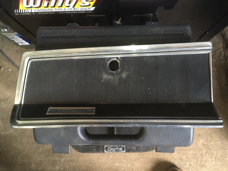

Want to retain the Matt finish on the black and not sure where to start on the silver, whether to paint or not.

What paint have folks had most success with for restoring dash bits?

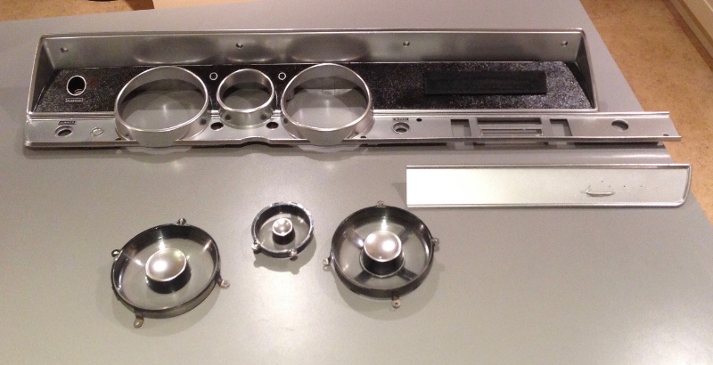

I painted all mine last year as some bright spark thought it would be a good idea to paint everything gloss black
After a million hours masking I nipped down to that well known automotive supplier The Range for some Plasti Kote aerosols. For the silver bits I used the brighter shade of wheel silver and the chrome got a coat of their "chrome" spray, which is really just a very bright silver, looks acceptable to me. I'd use matt black for your black bits. I cleaned and keyed it with a washing up scourer & the wife's toothbrush and hot soapy water before masking it.

Cheers both. It’s the chromey plastic coating I’m most puzzled by, but that sounds a decent option.
