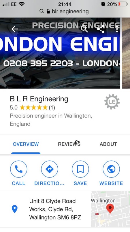

Andy, give Russel a call his very close to you.
- 510B377F-860E-4705-B373-F57B894A284F.jpeg (116.82 KiB) Viewed 4167 times
