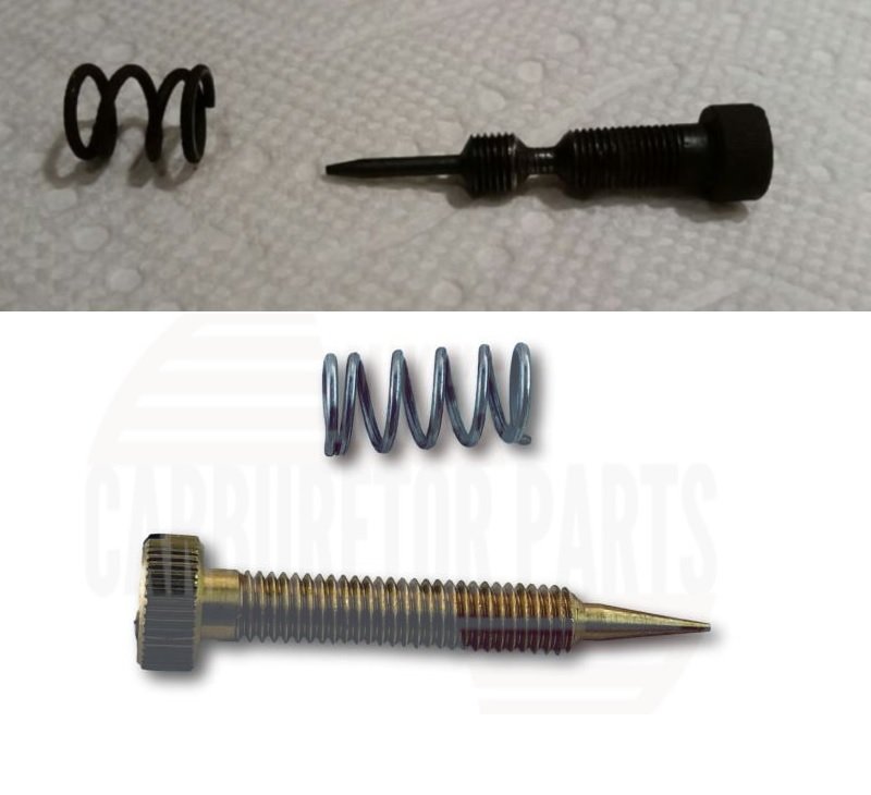

Yes this is what I did when I bought the new Chinese carb as advised by, you Dave I think? :read2: But as I said had some issues with user error. I swapped the idle screws but didn’t check the sizes, there are two different types of idle screws on these BBD carbs and yes I put the wrong ones in the Chinese carb. Resulting in way too rich mixture and Bananarama! running :banghead:
The issues I have been having have been downto those two bloody mixture screws, that now I understand do the low speed running as well as the idle.
I found two vids on YouTube yesterday that are really useful that helped me understand more about these carbs and how they work, so last night and this morning on the commute to work, I adjusted the mixture screws all the way in then out ¼ a turn at a time and I nearly have the car running great!

ahhh it will be a difference in taper i guess....
same stuff happend on webers as well
1.5 turns from 1 year changed to 2.5 turns on a later carb with a different taper and smaller threads
yes and Idle mixture is used for idle and off idle running
the vacuum sucks the rods down at idle and just off idle to bring in 1 mixture for transition into main circuit and when the throtle opens and the vauum decreases the rods ping up to the narrow section making more space in the jet for full power main circuit
but at idle vacuum is highest and the majority of the fuel for running comes through the idle mixture circuit
don't be alarmed if 1 mixture screw needs to be slightly different from the other. less of a THING on a v8 but defintly a thing on a six cylinder
depends on your intake and where under the carb the lowest vacuum is felt from each cylinder the 2 barrels of your 2 barrel carb do not necessarily see the same demand

Yes the idle screws are different to each other, but as you can see from picture the idle screws are completely different, Ive fitted an old carb now that I cleaned out and checked over all is well now.
That cheap chinese carb was part of the problem along with the timing being out was the problem, Car is running well now.
