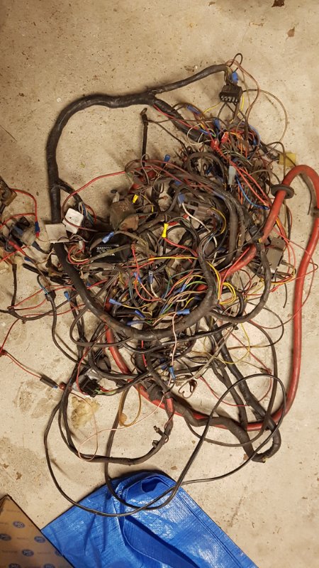

Time to replace my wiring so my investment doesn't go up in flames on first start! [-o<
My plan is to get a mopar wiring loom / harness kit. I have an auto electrician who can fit it for me.
I'm seeking advise on how many circuits to get and which kit to buy.
Circuits - I have the original (in a mess but makes a rough template for lengths) but I don't know if it had sufficient number in the first place.

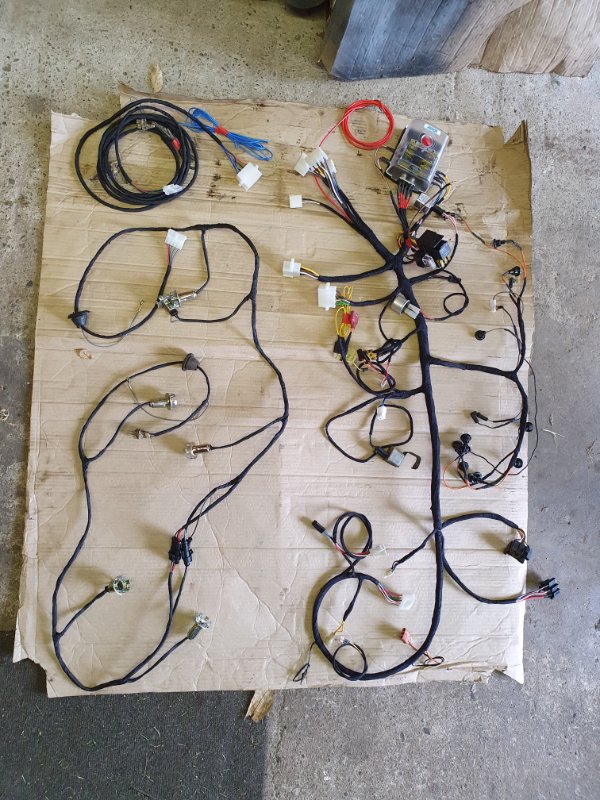

I made my own using a factory wiring diagram but also factored in the UK indicators etc. Used "vehicle wiring products" up in Derbyshire for most of it, Rockauto for the lamp holders and ebay for odd bits when vwp didn't have what I wanted.
Posts: 7551
Re: Wiring loom / harness
Well done, it looks a lot neater than the old one. Should have no risk of a fire now. =D>
