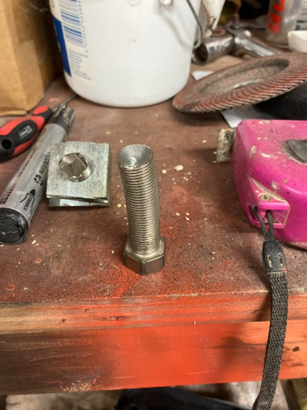

I rebuilt all my front end suspension a long time ago but never adjusted anything ..Today i thought i would raise the ride height so the engine when installed would not bottom out ...well it did not go according to plan ,the adjusters that were still slacked right of would barely move and i noticed for the first time the front suspension was solid ie hardly any movement ...alarm bells rang as i knew instantly i had done something wrong .. so straight onto the bat phone and tell Blue the issue ...He diagnosed i had chuffed up buy not having the lower control arm at its lowest position whilst installing the bars . ...I did not want to hear i had to take it all apart and start again but the weather was bad today so i made a cup of tea and started the task ....It went down hill very quickly as the bars were jammed in ,never had to force them in so what went wrong ???any ways broken torsion bar removal tool and an adjuster,,,,,, life is just so peachy sometimes

The bolts on the removal tool let go Pete ,its all apart now so hopefully it will go back together right ...I dont recall having a problem installing but i did use a jack to lift the lower control arm up to get the torsion bars in ...Which i understand now is wrong the lower control arm should be as low as possible and the bar should go in fairly easily ,with the adjuster fully backed of . Parts ordered sit back and wait ...It was never going to be easy was it ??

I am impressed that you managed to break an Adjuster - never managed that in 30 years, pray tell me your secret technique....
pete walton
Posts: 1402
Re: torsion bars
Post by pete walton »
Its all about hammer size LOL, a large solid mass at speed
