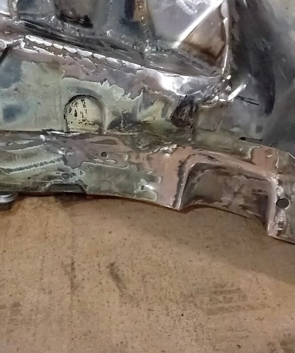

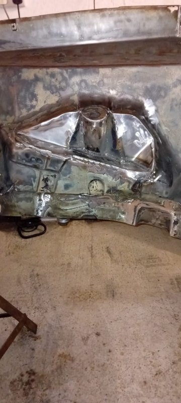

We have cracked on today, and made great progress.
Off Set provision for the Brake Master Cylinder.
Inner Fender Mashup competed.
Expensive After-Market "K" Frame carved up for more clearance too!
Brake Master Cylinder Mount.jpeg (51.6 KiB) Viewed 14197 times
Pass Side Fender Fabrication completed.jpeg (58.41 KiB) Viewed 14197 times

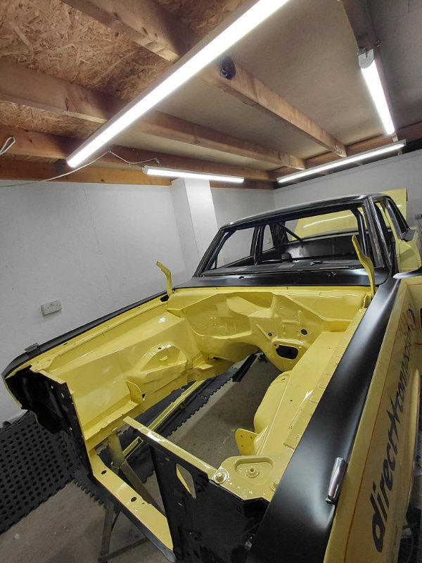

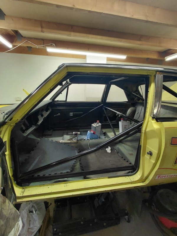

To paraphrase another member "Let's go racing , it will be fun, how hard can it be??"
WhatsApp Image 2026-02-28 at 16.02.17 (2).jpeg (75.03 KiB) Viewed 2100 times
WhatsApp Image 2026-02-28 at 16.02.18.jpeg (89.02 KiB) Viewed 2100 times
WhatsApp Image 2026-02-28 at 16.02.17 (1).jpeg (87.46 KiB) Viewed 2100 times
WhatsApp Image 2026-02-28 at 16.02.17.jpeg (83.82 KiB) Viewed 2100 times
