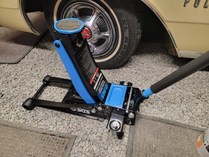

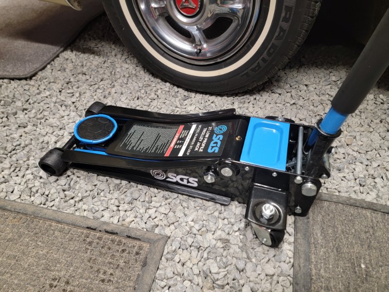

Ive just bought this jack as this thread and my dodgy current jack prompted me to. Fantastic value, appears to be really good quality for the money and came less than 24hrs after I ordered it.
https://www.sgs-engineering.com/sgs-3-t ... gIlvPD_BwE
Posts: 1440
Re: Raising car on 4 axle stands
Looks good Steve, might get me one of those.
Does it lower smoothly?
Posts: 7599
It does Stu, so far Im really impressed for the money. My old one was a nightmare to lower. As soon as I turned the handle it would just drop like a stone. It also very slowly dropped when the car was up so I had to be quick getting the stands under it. This one is very smooth and precise. Ive obviously only had it a couple of days but so far so good. It is very heavy so more of a garage jack than one you can just take in and out of the car :thumbright:
