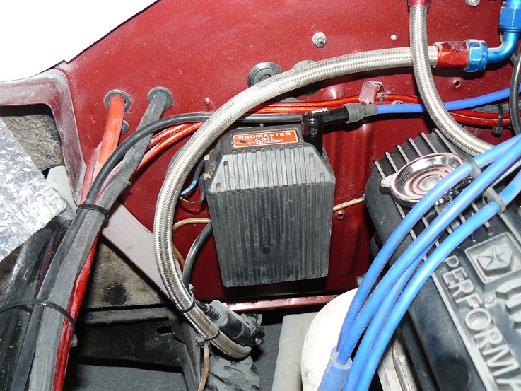

I just spent the last few hours making a new stainless bracket for the new Mallory coil and you can't even see the damn thing :?
New coil.jpg (215.84 KiB) Viewed 1206 times

Currently trying to decipher the wiring so I can graft in the Mallory unit. This may take a while.

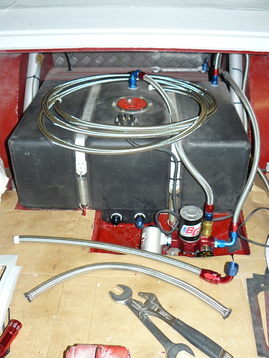

Still not tackled the ign but I'm replacing ALL the braided hoses due to the original crap stuff failing.
Renewing fuel hoses.jpg (209.34 KiB) Viewed 1366 times
