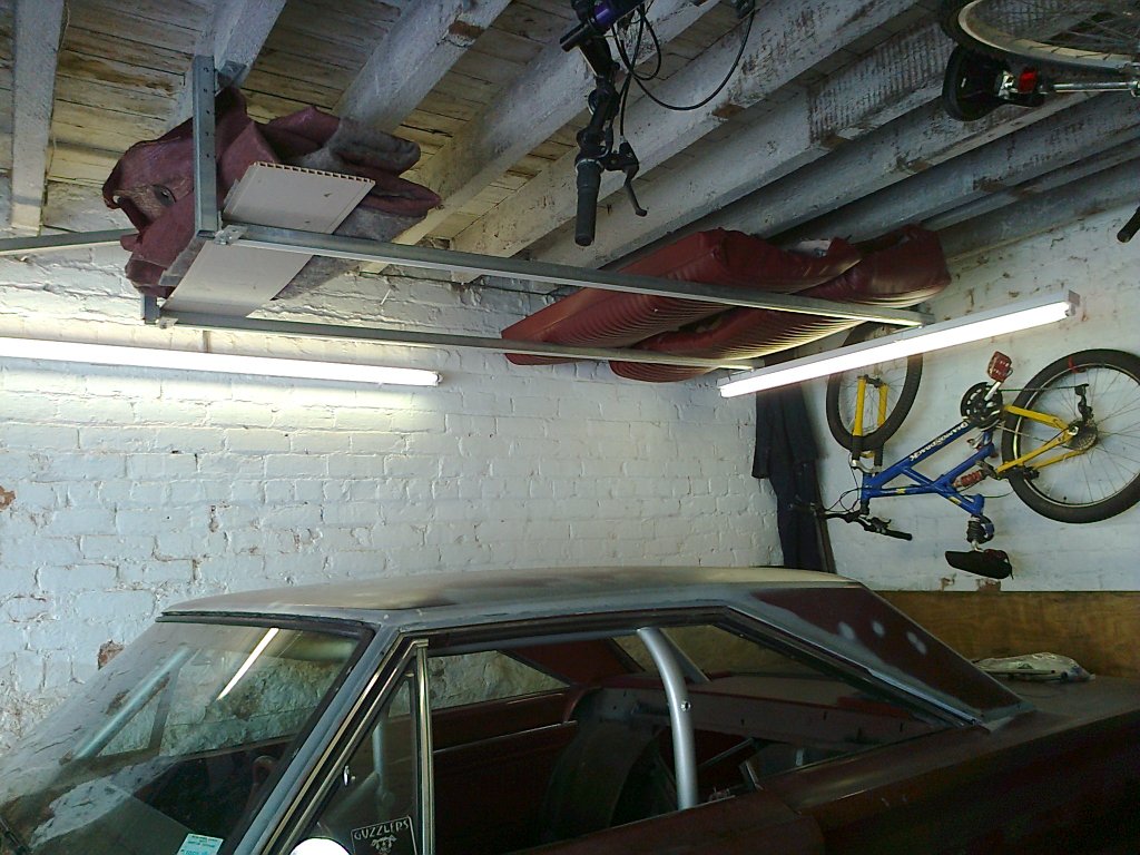

Well my lovely spacious new garage is now full, shoulda got an A-bod :roll:
So- i came up with a neat storage set-up for my seats, carpets, etc

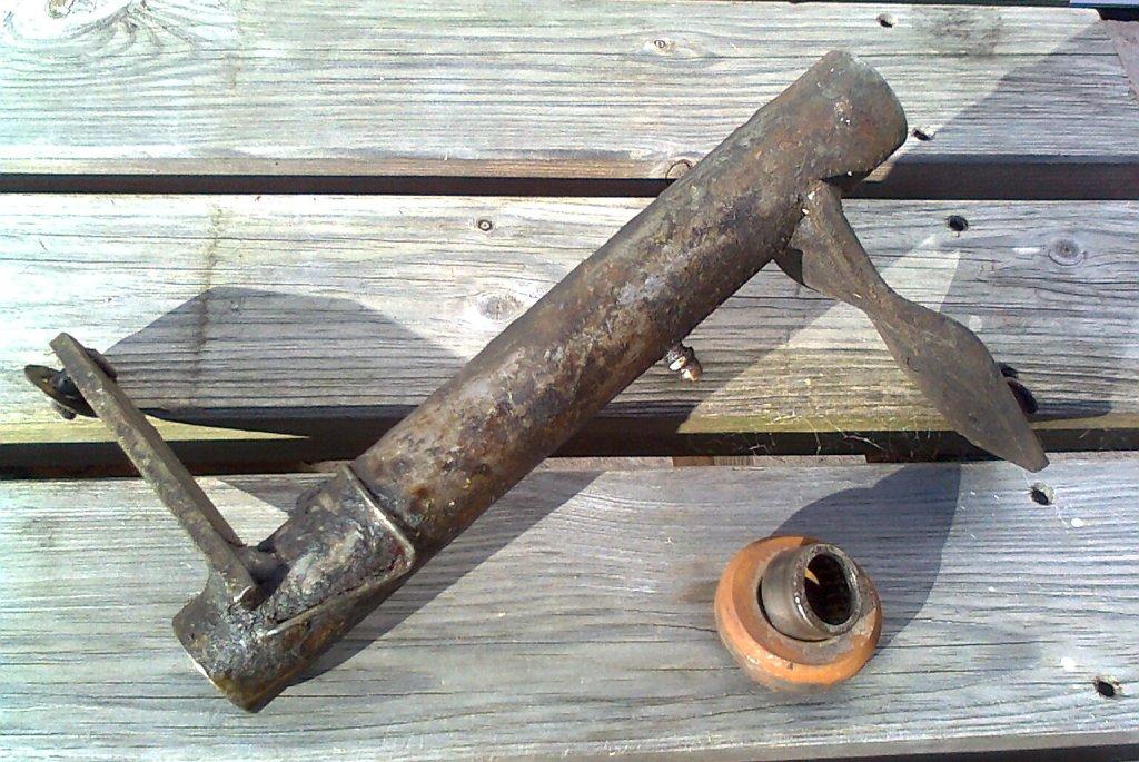

I got the parking brake lever assembly fettled and fitted. You can see the release lever is 'tweaked' to clear the roll cage.
I did a bit of internet research to figure out the cable routing- turns out i have one bit of roll cage outrigger in the way so i'll have to drill through that. Also i'll need to make a new plate to secure the rear cables as the stock one means they'll foul the ginormous tyre. Then i just need the rear cables to complete the job.
Also, i found my Z-bar and crank end spacery thing and bearing. See- i knew i had 'em somewhere!

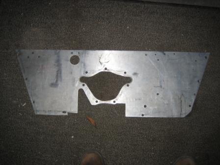

MOTOR PLATE:
No inner wings so this will just bolt to the chassis rails.
I'm thinking a plywood mock-up (or 2 or 3...) then 8-10mm ally plate?
I have a motor plate (pic below) which i may be able to mod, haven't had a proper look yet.
ANY tips and hints (and pics) greatly appreciated
