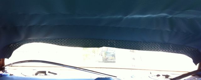

Th essential thing is to start at the rear. I made a couple of wire retainers that would tie the rearmost bow to the rear window frame. This then allowed me to pull the headliner forward without the rear bo rotating over.
OK, so i wanted to do headliner despite it being a bit of a bugga by all accounts. I sourced new headliner bows from Dante's and the headliner via Summit. Finally opened the box to find wrong headliner last summer. complained to Summit but they wouldn't refund any shipping costs. The headliner was 3" too short and the some of the bow sections would not line up. I put it back in the box.
Time passed
Decided this was the week to have ago, atrial fit and as the headliner came with spare material my miss offered to sew an extra section to lengthen the headliner.
so, onto the trial fit.

The design to mount the headliner at each end is excellent. Multiple small spikes exist under the window trim. So I stretched the headliner forward and realised the front two bows were not going to line up with their holes. Out with the handy drill and create new bow locations without actually drilling through the roof. With all bows now correctly spaced I stretched the headliner to the front screen to see how short it would fall.
I managed to get just 5mm stretched onto the front spikes. Bingo, its going to fit after all
5mm is all you need!

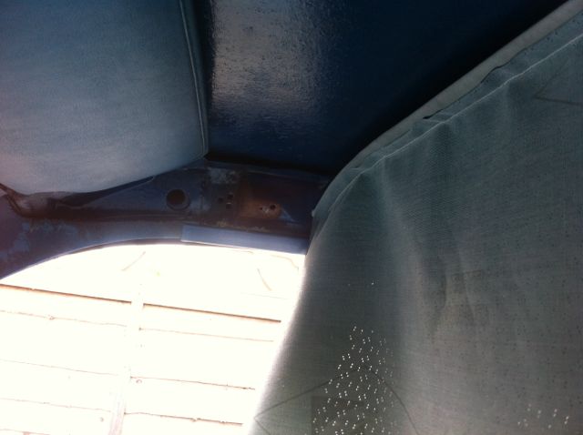

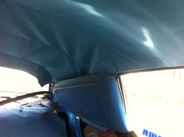

With full tension now in place I attached the rear screen section and turned my attention to how to fit the headliner along the sides by the door frames.
This is much harder as there are no attaching spikes along the door frames. I used a quite brilliant headliner glue (ask me if you want to know, its in the shed now ) and bulldog clips. This worked well, but things got really tricky under the C pillars. Whatever I did i ended up with ripples that were near impossible to remove. Probably spent 3 hours in total trying to get something respectable done here
- tricky corner.jpg (33.71 KiB) Viewed 6045 times
- trouble in the corner.jpg (34.2 KiB) Viewed 6045 times

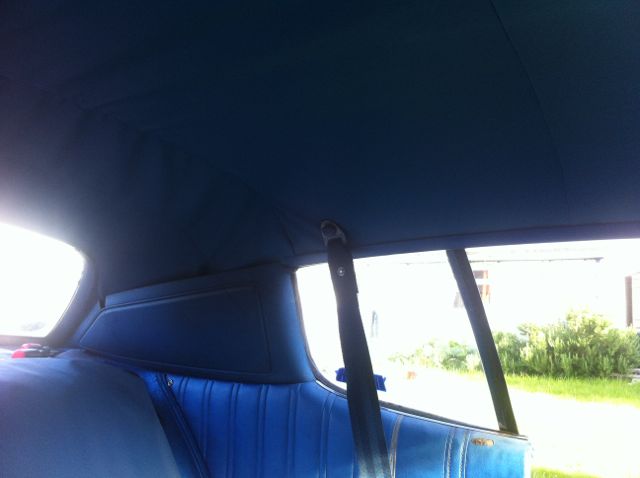

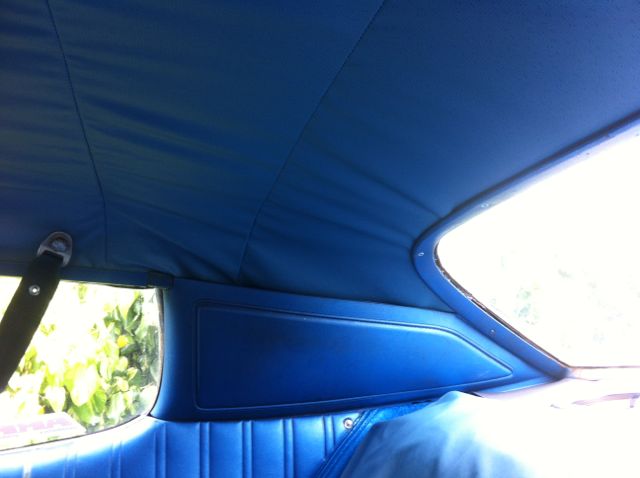

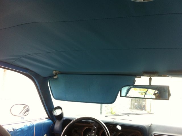

in the end I did best as I could. I have only tacked the liner down below the C sail panels so I can return to it if I need to once its all settled down.
The remaining pics show the finished article.
Don;t be too critical
as the light really exaggerates the ripple effect. These are already diminishing somewhat since I took the pics as I understand that the vinyl will shrink with the car left i the sun.
Took me about 10 hrs but that includes multiple measurements because the headliner was wrongly supplied.
Whole interior looks much nicer now and brings a bit of light into the car.
Well worth the effort
Now for installing those TTI headers..
