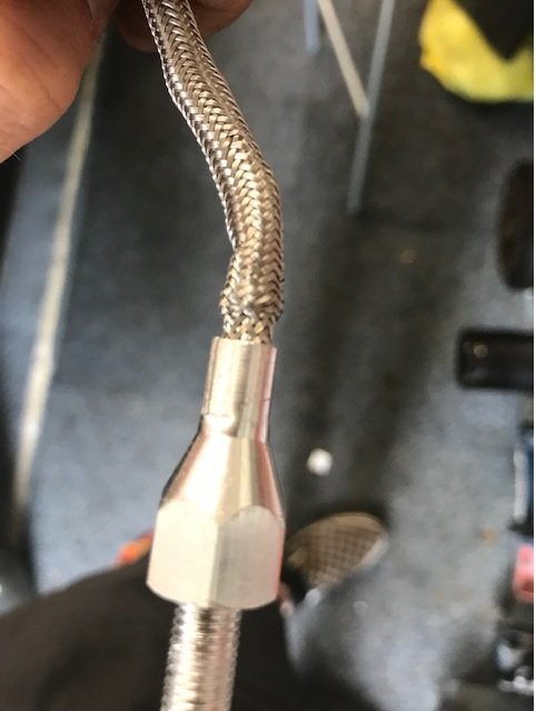

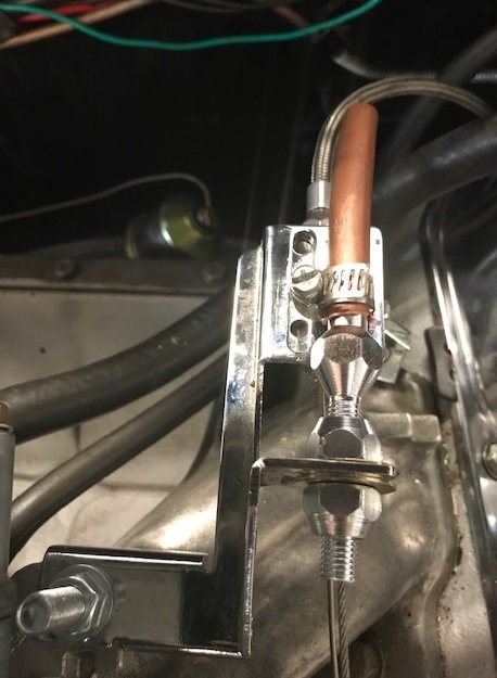

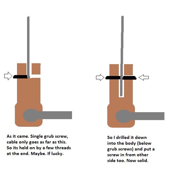

OK, you've all earned some pictures. Fans of 'Redneck engineering' you are in for a treat.
So - throttle cable. With the best will in the world the throttle cable from the 50 years ago small block just didnt reach. I lashed it so it would run but it was a stretch. Ordered a generic to replace it (or rather bought a generic as it was in stock) - looks like a lokar - happy days. (or so I thought).
What a piece of junk. It has no structural integrity and camp resist compression. So the first one I trimmed, fitted, fettled, got it nice. First time I pressed my foot on the cable and it just 'crimped'. Never seen anything like it - result, slack cable, 1/4 throttle. grrr. I managed to get it straight enough to work and then the 'carb joiner' popped off. (balljoint thing). On investigation the cable only went as far as the grub screw (not beyond) so there was nothing to hold it. (see diagram).
So I assumed it was a dud, got another one, gave it more length, drilled the grub-scrww-cable-end so it went all the way on. Happy days. Then I pressed the throttle. Crimp. See photo. Cable simply 'compresses'. It might as well be made of cheese.
So (and here is the redneck bit). I've got the remains of two throttle cables. Two lots of all the hardware. A length of cable which would do it but even if I crimp ends on it would prob collapse again. It occurs to me if I can 'force' the cable to follow a route it wont crimp. So I decided to take a piece of 10mm copper tube, trim a length of braided cable shield long enough, and use the copper pipe to 'hold' the new cable in place. Here are the results - and its magnificent. As a result it follows a set route, doesnt catch or bind and most importantly WORKS. Coupled with the freshly drilled balljoint I can have some confidence.
What I actually neeed of course is the 'real' mopar cable (or the mancini replica) but I need this running in a week - I am out of ordering time. This'll do it...
So - happy days. I know its unorthadox, but its only silly if it doesnt work !

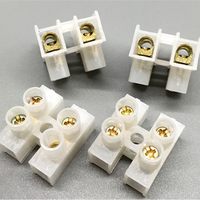

I did exactly the same thing years ago !
Also you can cut open a cable terminal block and take out the brass bit for some added cable security on both sides.
One thing to note is ensure your engine earth is in very good condition or the copper tube will glow when you crank and crank as it such a good conductor.... been there burnt foot

Yes, I popped a couple of those connectors in the mobile toolkit...
