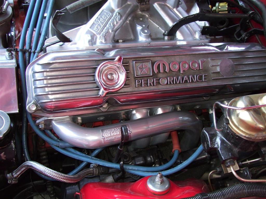

Didn't notice they were loose until I fitted the headers. I was expecting them to be tight with the paint in there but they ran in by hand easily.Mick70RR wrote:Dave, you should have Helicoiled those loose threads while you had the heads off. You could still do it but it but it would be a struggle with the heads on.

i know your views with studs dave, but at least with the stud it does seal the thread in the cyl head, as you know all ive ever used is studs on mine, to remove headers i either have to put 2 nuts on them and wind them out like a bolt or remove engine mount bolts and raise the motor, yes its a pain in the arse but this way ive never had one leak or come loose. also as you see in the pic ive cut the studs down small as poss so i dont have drain the water removing the header, with you having manual steering surely you have more room than me and maybe able to remove the header without raising the motor, just my

It is something I will try if all else fails.
I resist using studs because my 2-inch primary pipes make it pretty tight.
Even without studs I have to jack one side of the engine up at a time to move the headers enough just to get a socket onto the head bolts. I badly scrape the headers and steering every time.
On the passenger side (where my leak is) I have about 5/16ths between the pipes and the inner wing. But even tighter is the torsion bar. The pipes are only just clearing them (couple of mm) which makes manovering the headers pretty tricky. Although with the engine jacked up high this side does in fact drop out of the way easier if not competely (I need to remove the trans dipstick tube to drop them right out of the way).
Again the passenger side inner fender (and primary pipes) get scraped badly every tme i move the headers. Studs would make it worse without a doubt.

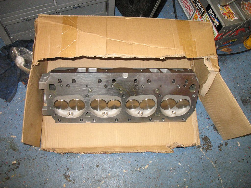

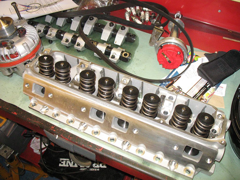

Well the car may be sold in principle but I still have to fix it and make sure it is running well for the new owner. It's the least I can do.
So it will be off with the old ported iron heads and on with a pair of stealth heads. These will be used in "out of the box" condition as they flow as much like this as my old ported heads.
I will only be fitting the matched valve springs for my camshaft and lapping the valves in. The rockers will need a little adjusting on the shims to center them exactly on the valve tips and I will need a new set of spark plugs as these heads require long reach plugs.
The big job will be removing the pistons and having the quench domes on the piston tops machined down. I can't remember how far they protrude above the deck but I need them to be flush with the deck so that with the gasket in place I will have 40 thou quench space in the head.
