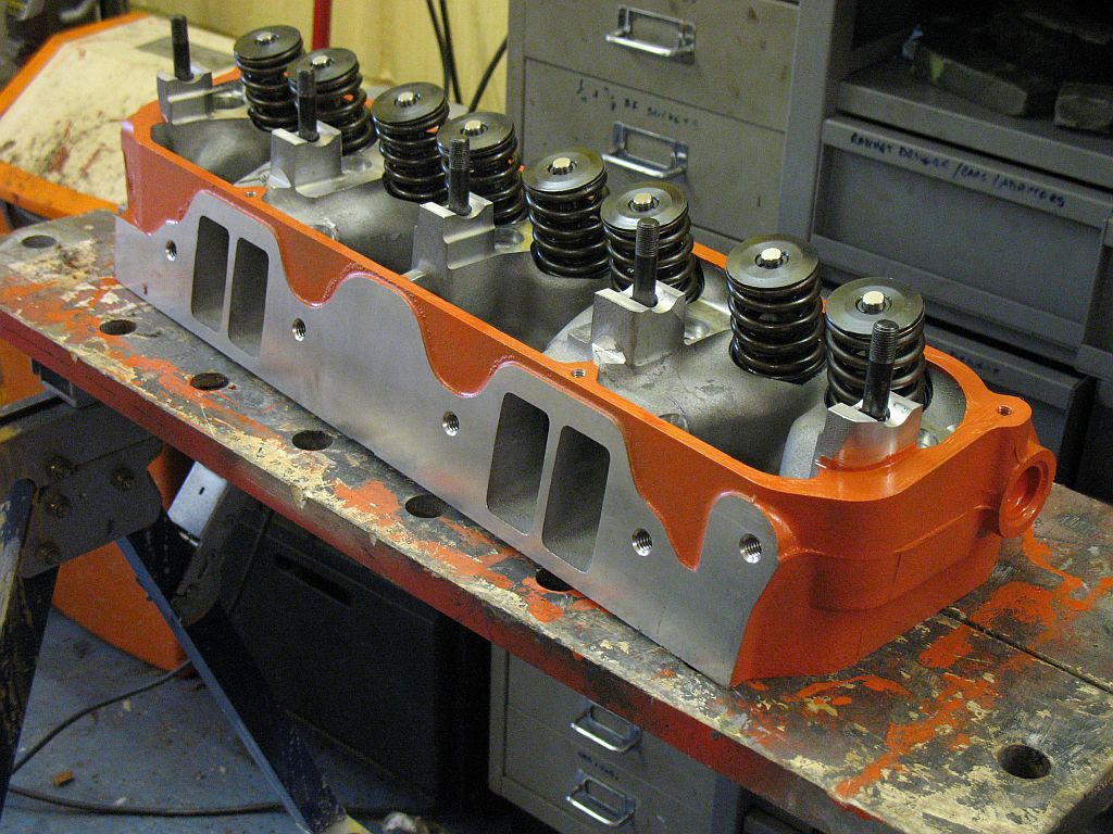

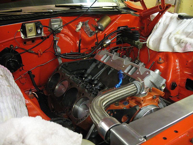

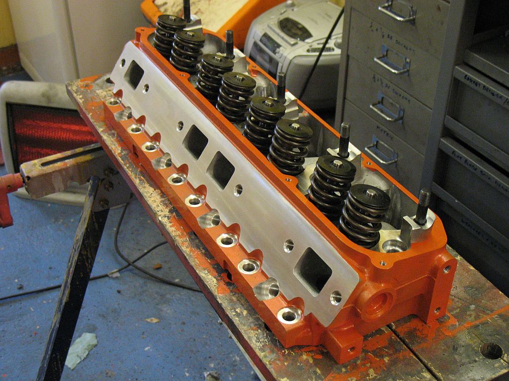

Pistons are back in the block after being "adjusted" to clear the new heads. Head is placed on block without gasket in this photo to double check clearence between pistons and head. I gave it 1 thou clearence to get 40thou with the gasket.
Pushrod clearance took a lot of grinding work because my pushrods are now a) slightly on the short side and b) fitted with 1.6:1 ratio rockers.
These heads really need 1.5:1 ratio rockers and pushrods on the long side to save you a lot of hassle. Probably still need some work even then.
I didn't want to be grinding in the garage because of the dust so have only be able to work outdoors at weekends when the weather was OK.
It should go together very quickly now though.

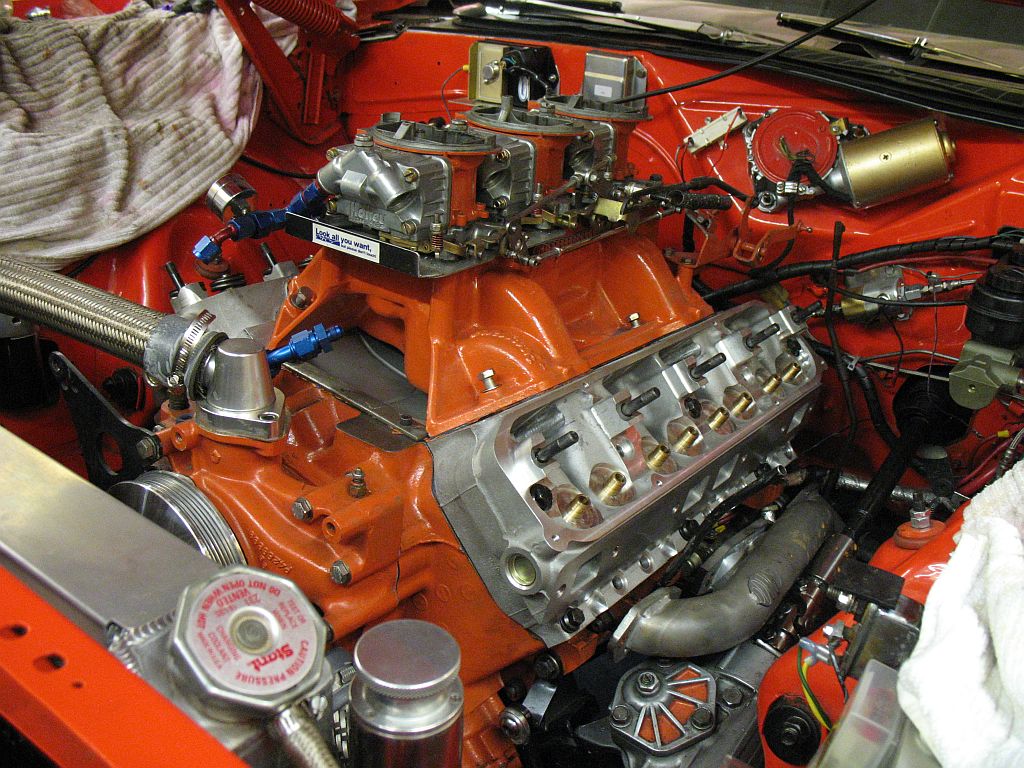

Trial fit to make sure intake fits OK without machining for the thick gaskets.
