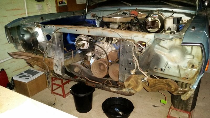

When looking at the engine bay all the shiny stuff is let down by its surroundings.......So add some bodywork/paint to the mix and my simple rad replacement is now a front end breakdown:
Lots of trial fitting and new mounting holes/routing holes have been drilled:
Sand all surfaces down and add black paint on the mounting plates/fan/pulleys. Primer on the rest of it:

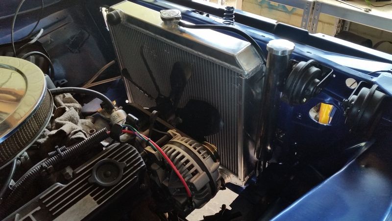

New Rad/Expansion tank, Oil cooler, Headlight Earths, relocated horns and re-attached slam panel:

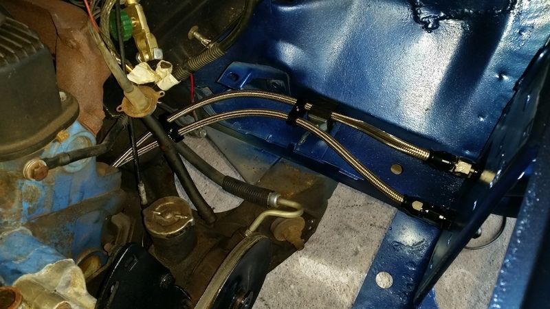

Thanks to the guys on here and my Q&A's.........Cooler Hose routing:

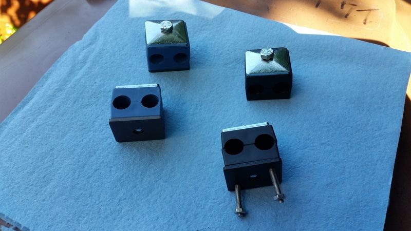

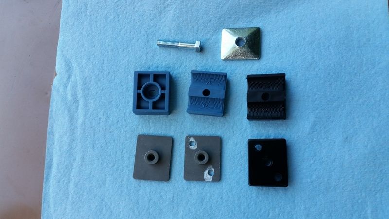

Hose clamps (thanks for the assistance Will).
These are supposed to be welded to the frame (not got the tools), so decided id rather have detachable mountings.
Just my luck that the design of these, is that the have recesses in the base.......
Good 'O...............I prefer neat and tidy so i'll go with hidden mounting bolts.
M4's fit perfectly if you get the holes in the right place.
I also don't like multi-coloured cars so painted them black to tie in with what will eventually be Blue/Black combo:

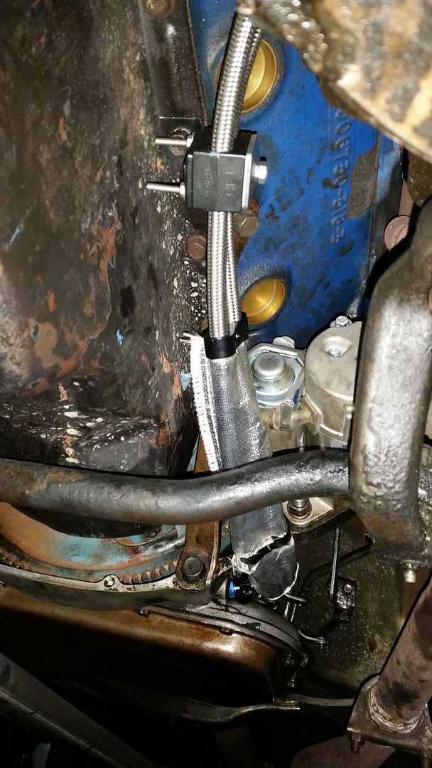

As suggested by Blue :thumbright:, I made a bracket and supported one utilising the oil pan and one of the mounting bolts (also added heat reflective covers to the feed and return lines):

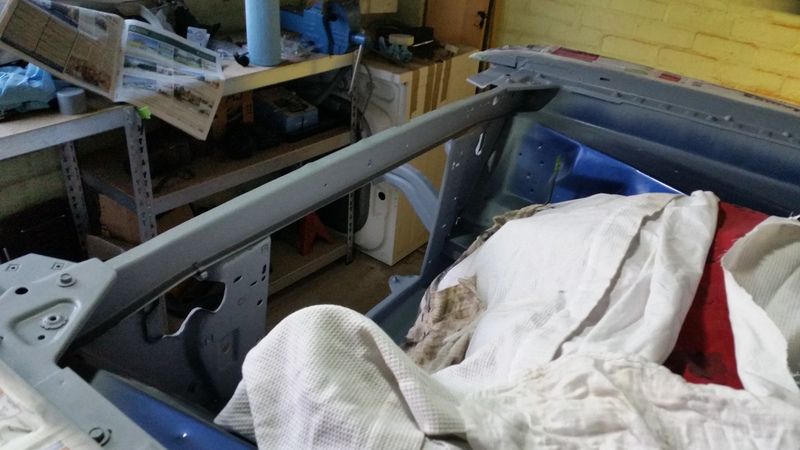

Rad support panel c/w bulkhead fittings:

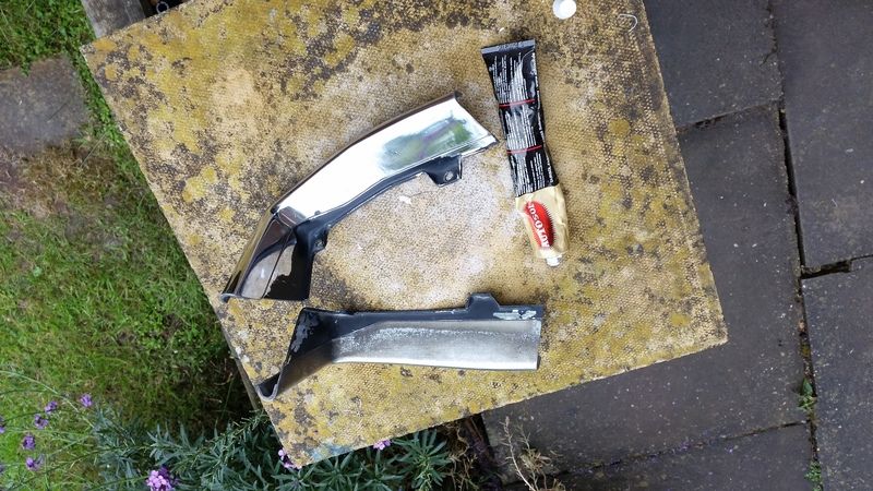

Bit of Autosol on the chrome (before and after pics):

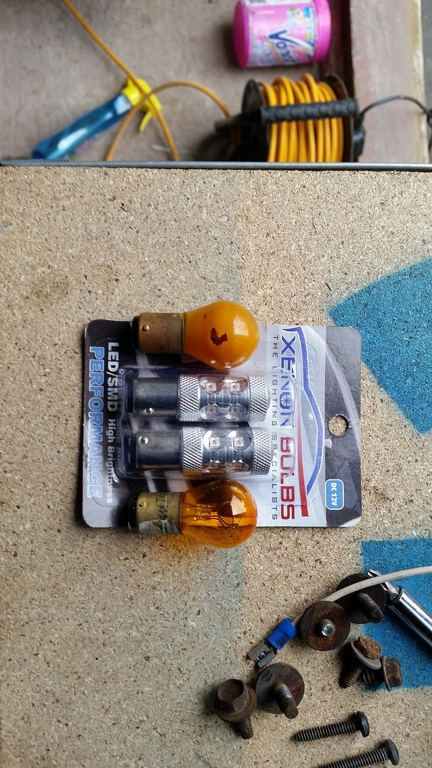

I also hate having orange bulbs behind clear Perspex (indicator covers on the 72), so I've gone with LED replacements:
Less current draw, but may be an issue without resistors (indicator flashing speed)......Bananarama! it! I'll find out in the next few weekends.

You might well have an issue with the indicators ability to flash using led's, you'll need a zero or low resistance flashing unit. Similar to this on the bay of fleas
http://www.ebay.co.uk/itm/3-Pin-DC-12V- ... 35ebda27b3
