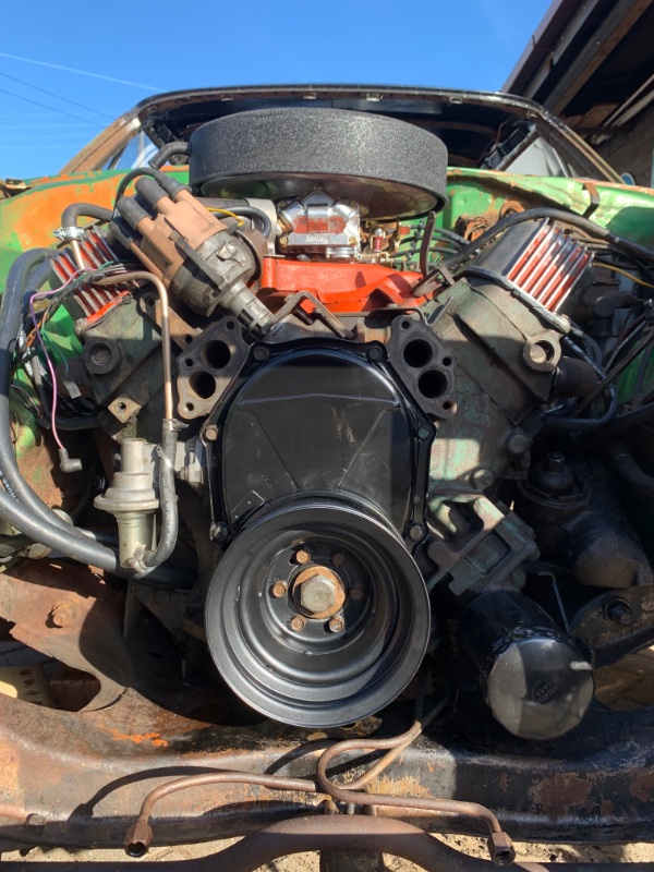

Another Holley fan here, simple carbs that you can get parts for anywhere. I prefer double pumpers, completely mechanical in operation and the maximum of tuning options for sharp throttle response. To learn how to set up timing and Holley carbs, this is very useful https://4secondsflat.com/products/tuningtowin.html
Re: Restoration thread 1969 St Albans charger
My personal advice is not to cut corners on carburation, especially with an old one.
It will have you chasing your tail for faults, and those carbs (whilst simple in construction) are not easy to diagnose and tune.
All the internal channels will be furred up and corroded and will not function as designed out of the box.
We have an ultrasonic cleaner for such purposes, but I still do not like the basic design, and feel you can do a lot better.

I was planning on doing some engine upgrades during body and paint part of the resto. I was planning on pulling the engine and taking care of any tuning and upgrade plans when I pulled the engine for paint which I’m hoping to get to by April next year. I just want to get it running so I can move it around, up ramps etc just for now as I still have a little welding and protecting to do underneath. I will definitely be upgrading the carb and have been researching to find something suitable. I have found a 650 Holley that I was planning on but now will look into Double pumpers and see if the particular carb I was looking at is inline with your recommendation, thank you @ blue.
I have so much to learn with carbs honestly I have no experience, and my knowledge is VERY limited so all the advice is very much appreciated and welcomed.….

Thank you mate. Sound advice, as ever.Pete wrote: Sun Nov 21, 21 12:43 pm My personal advice is not to cut corners on carburation, especially with an old one.

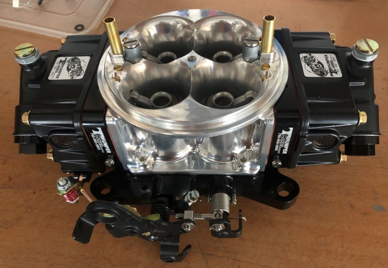

Blue. Show me your carb-porn acquisition.
At the risk of a thread hijack, this is my custom built billet carb for the Barracuda..

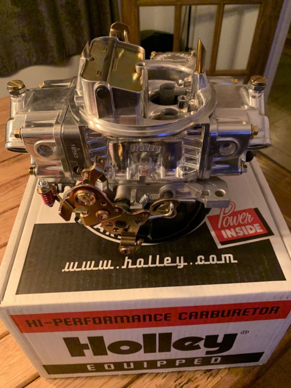

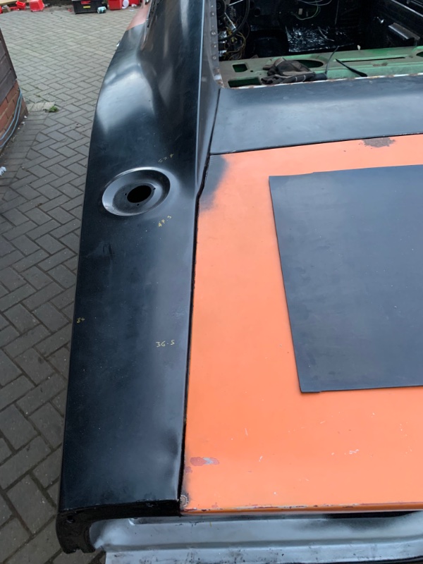

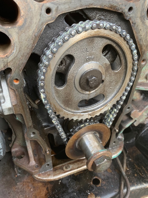

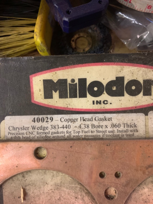

Okay it’s been a while and I have been a busy boy. Not as productive as I’d like in all honesty, I painted up some engine parts because we all know paining fans and pulleys makes the car go faster
But, my goal was to get her running early 2022 and whilst I have achieved that, the plan was more to be putting the key in and moving her around, not bypassing the ballast to keep her running…
I’m getting ahead of the thread… il back Track a tad..
So having decided a new vac secondary, manual choke 750cfm Holley. I decided to go with a slightly bigger carb than I had planned because, as recommended by the seasoned veterans on this page, one does seem to get sucked in to the “let’s make it go faster” bandwagon. It’s all quite addictive and I do see myself upgrading quite a bit in future. I installed all new fuel system, and adding huge amounts of horsepower by spending hours to clean and de-grease the engine bay I managed to get the confidence together to fire her up.
Whilst she ran, and she ran well! She did reveal a few issues for me. My concerns are…
Milky residue under valve cover so I need to investigate the head gasket. It may well be because it’s been sitting for so long however I think il have to do the gaskets as the car came with a nice set of pure copper Milodon gaskets and I can’t help but think why would they be there otherwise!
The car would not stay on with key ignition unless I had the key in “crank” at all times. I had to bypass this at which point the car stayed running. I have installed new ballast resistor, ignition relay and ignition coil because, well, they are cheap and easy to do and why not at this point. I have not tried re starting the car since doing these but I’m hopeful that has sorted that issue.
Huge leak from valve cover, a cracked corner of the valve cover was present so replaced them as the existing covers were in quite a state, quite happy to do that as, because, well…. Race car
I have an oil leak where the sump meets the timing chain cover. I installed a double roller timing chain set and realised that the bolt that meets the cover to the sump was threaded and believe this is the issue. I won’t be changing the timing chain cover at this point, will just put a nut in order to get it tight enough to stop the leak.
After installing the Holley the carb was binding when throttle was activated. I over come this by fabricating a 5mm thick aluminium plate between the intake and carb. Works a treat now but I may well take the intake for machining at a later date.
I need to force start her! I literally need to poor fuel in the carb to start every time. Fuel delivery LOOKS to be good, not really sure the reason for this, if anyone has an opinion or better still, a fix
I’d love to hear it. I have not done any adjustments to new Holley. Literally just thrown it on.
Radiator leaking all over the place. A new aluminium rad should be delivered today or tomorrow. I know this isn’t for the purist but I honestly just want the car to cool well and at this point most of my car was made in Taiwan so at this point that Im just happy the car may well see the road again
Good things, all the dash seems to work! Bizaare! And, When I did trick her to run, she ran well. I didn’t expect to start her and off for a drive, so none of the above surprise me and pretty much on parr with my expectations. Hopefully il be able to get these bit installed this weekend and post some new pics and footage. If the wind doesn’t blow me away, it will be a productive weekend…
Managed to acquire transmission Kick down parts from our one and only blue il have to piece together.

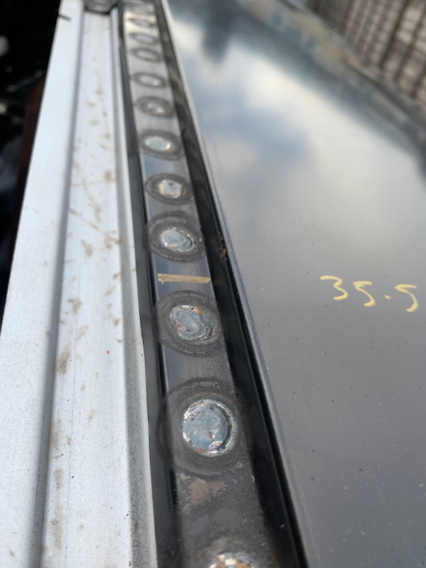

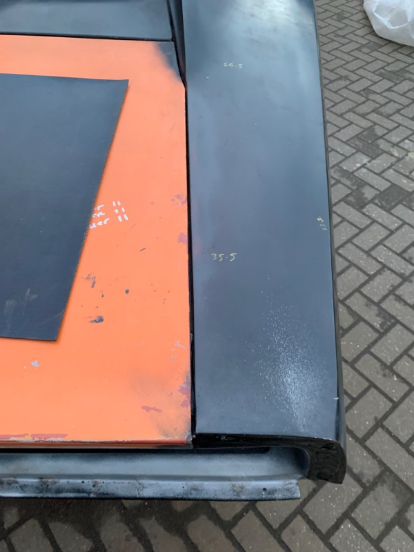

So much has been done that I’m forgetting to mention. Ordered inner fenders from AMD, installed Trunk extensions, heater box and blower motor rebuilt/installed, All new hoses, fluids, oils, u joints, wiring, dash restored and re installed (part re installed anyway) Iv done some gap adjustments, and so much else. Il throw some pics in below, I have not stopped!

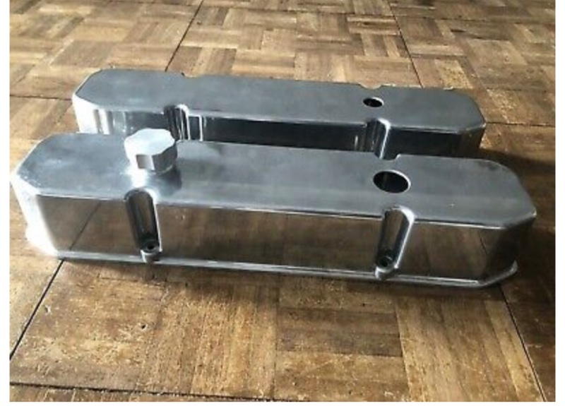

Happy to take those nasty old valve covers off your hands if you want rid of them! I wouldn't use the copper head gaskets, there's no need and regular composite are perfectly adequate and hassle free.
