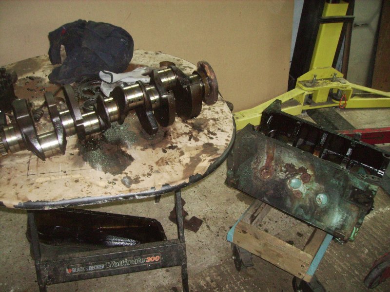

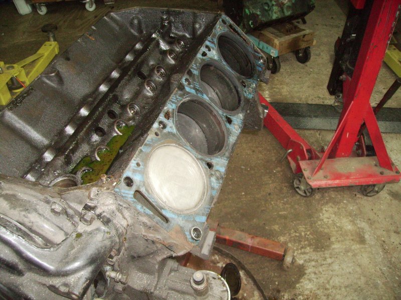

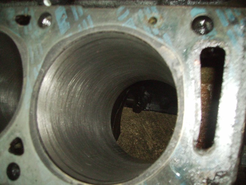

today we turned the 'dead crank' engine back up the right way and took the inlet and heads off. at the stage we're at it's worth popping the pistons/rods out and fitting new rings too so.... the bores are good as were the other 2 and all are standard. now it can upside down again to finish the strip down to a bare block. the heads from the one we're using are nice big valve versions which is nice.

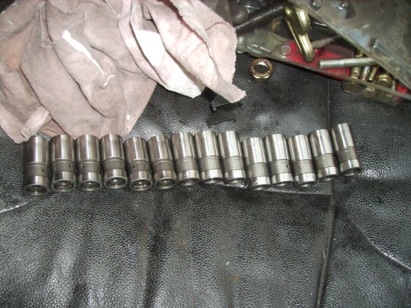

that's the engine stripped to the bare block and the bores honed. we also honed the lifter bores with my brake cylinder hone to make sure the lifters can spin freely when it's running. we're not taking any chances this time. the lifters from cam' number 1 have been stripped, cleaned and reassembled too. ash' will take the block to work and steam clean it inside and out (core plugs removed) as well.

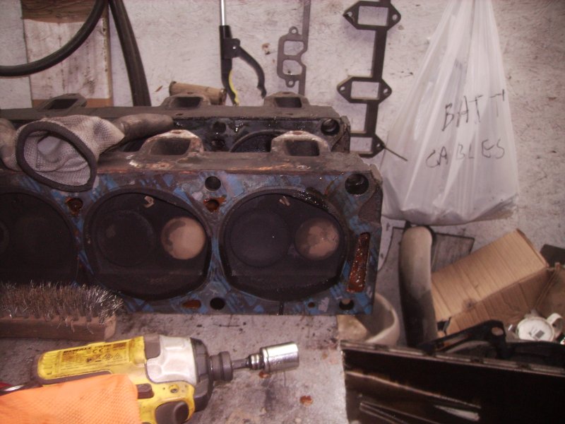

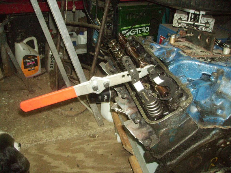

today we pulled the 'top' off of ashley's engine so we could go through the lifters to find one more 'good' one. we only found 2 out of 10 that had the slight crown on their base that they should have, 6 wouldn't even pull out of their bores! the 2 were stripped apart, cleaned and rebuilt so we now have a spare just in case. we need to remove the valve springs in situ after bedding the cam' in with the old stock ones and i've bought this compressor that uses the rocker shafts to lever/pull against. it'll come in handy for the same job on my 318 and later ashley's 440 too so the under £20 purchase price was worth it. we had to strip a set of rockers from a shaft for the job but we have plenty, lol.

Posts: 5927
Re: big block to go in ashley's zephyr
Have you got a link for that compressor tool? I could do with one to sort my valve stem seals out without removing the heads.
mygasser
Posts: 1520
Location: faversham, kent
Post by mygasser »
yes mate and it's cheaper than i remember at £12.49 inc' delvery. :thumbright: it compresses those uprated 428 cobrajet springs easily so better than the price would suggest too. don't forget a length of 'cotton' rope to fill the cylinder at bdc so when turned over it jams the valves up in place. some use compressed air but that means using your noisy compressor so rope's easier for me.

Posts: 5927
mygasser wrote: Sun Oct 05, 25 12:30 pm yes mate and it's cheaper than i remember at £12.49 inc' delvery. :thumbright: it compresses those uprated 428 cobrajet springs easily so better than the price would suggest too. don't forget a length of 'cotton' rope to fill the cylinder at bdc so when turned over it jams the valves up in place. some use compressed air but that means using your noisy compressor so rope's easier for me.
neil.
https://www.ebay.co.uk/itm/266460931945
Thank you. I knew about the rope trick, but not about the tool to compress afterwards. I wasn't sure how to do it!
Just ordered one.
mygasser
Posts: 1520
Post by mygasser »
i've got the old g clamp type compressor and more recently one of these for in situ guide rubber/spring changes https://www.ebay.co.uk/itm/388191170714 ... R-r4t464Zg
that wouldn't compress the upgraded 428 cobra jet springs though, so it was helpful to have the engine apart and then i saw the 'hook under the shaft' type and thought i'd try it. we'll bed the new cam in with stock springs on ashley's fe ford engine and swap in the the heavier ones using the new compressor. that's the plan anyway, lol.
