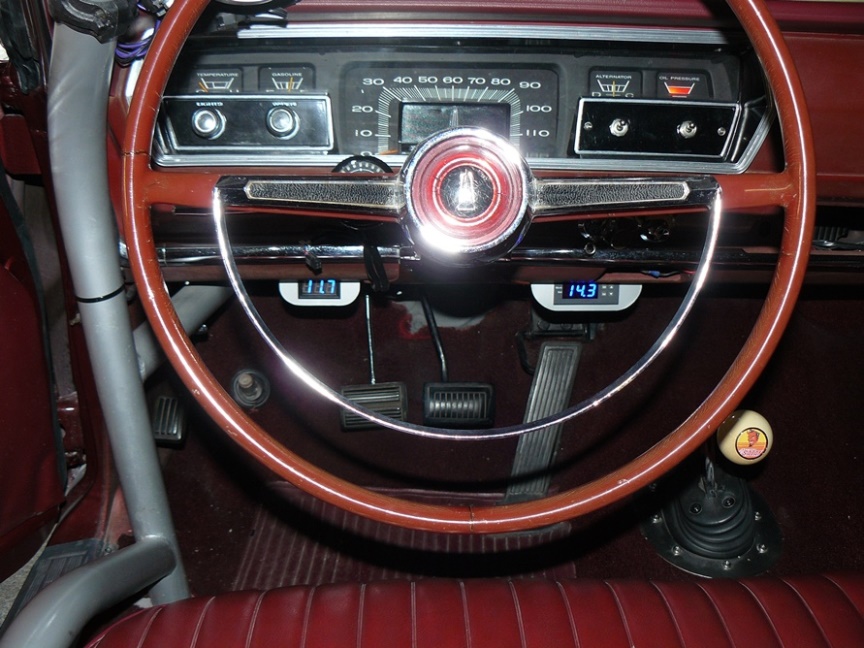

Digital temp gauge (actually the fan control unit) and £1.86 voltmeter fitted
Temp & volt gauges.jpg (209.2 KiB) Viewed 1453 times
fan control unit ??? Tell more link don't be shy
Another cheap and brilliant Dave999 solution Will :thumbright:
Info here...
http://www.moparuk.com/forums/viewtopic ... controller
Dave's link to the ebay item is long dead, this one's the same though...
http://www.ebay.co.uk/itm/10A-12V-Digit ... 1e863d9409
Scroll down this page to see how I fitted the sensor...
http://www.moparuk.com/forums/viewtopic ... &start=255
Posts: 9563
12 volt version of a central heating or greenhouse heater control :)
pay no more than £ 15 all in
unscrupulous peeps flog em as auotmotive fan controlers at £150-200....
naughty naughty very naughty
can't take credit for the volt meter....think that was morgan.... :)
expect Chinglish instructions or indeed nothing but fag packet diagram on ebay link.
has internal relay switching but i'd use to control proper automotive relay to switch on yer fan. they pull 40 amps plus on startup

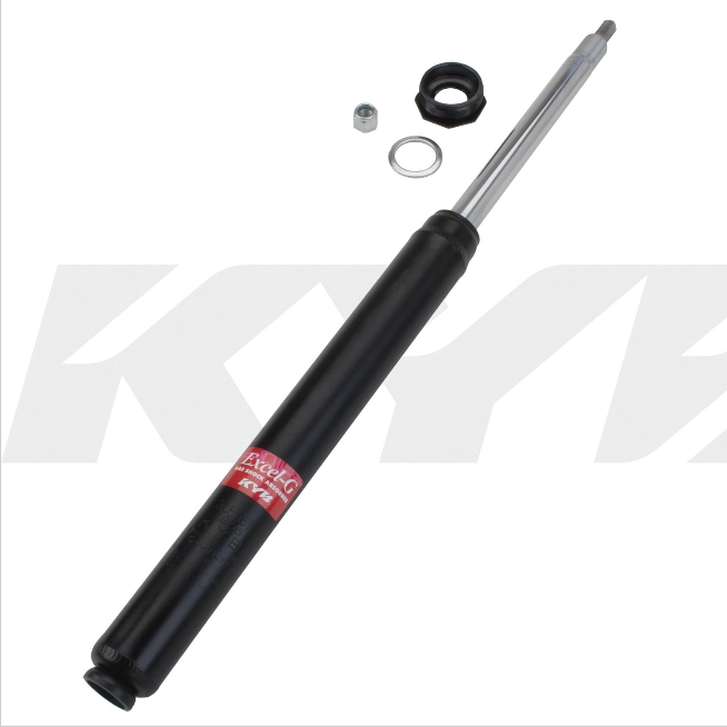

The AM struts are based on U.S. Datsun 810 series cars, they use the same shocks as the 280ZX, amongst others.
There's a great parts search tool on on nissan4u.com with exploded diagrams and part numbers. There's a replaceable cartridge and by cross referencing the part numbers I found a KYB item available from Rockauto.
So, full of excitement I ordered them from Rockauto.
Within 5 minutes of this, I found them on Jegs. Good news- they're almost double the price of Rockauto.
Bad news- they show the dimensions. At 16" compressed they're a good 4" too long :?
Dammit. Order cancelled. Back to plan A. Oh, hang on, I didn't have a plan A :evil:
KYB 365013 shock insert- close but no cigar....PNG (139.66 KiB) Viewed 1329 times

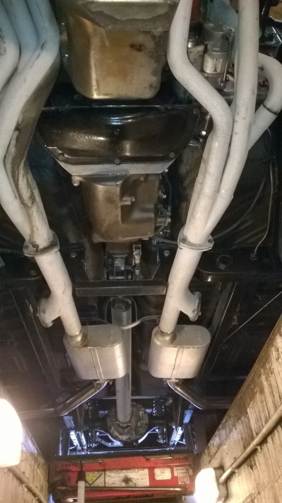

I've had an enquiry about my exhaust routing so I thought I'd put a pic up here...
Belve from below.jpg (198.94 KiB) Viewed 1228 times

Cheers mate nice shot..
