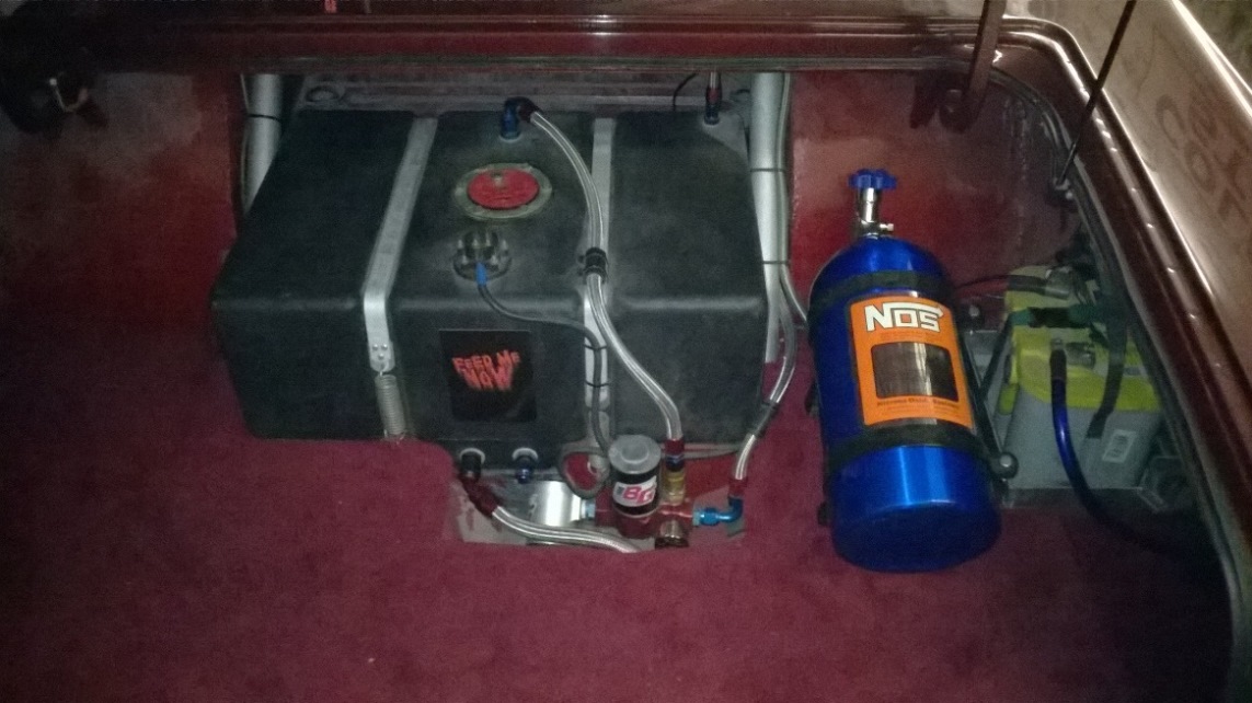

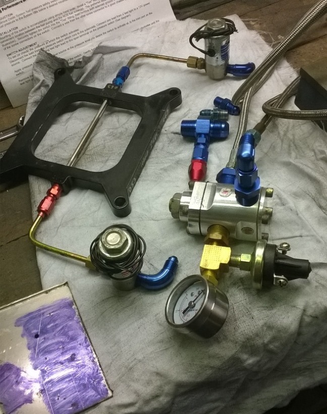

Oh, I'm sorry, did I not mention my nitrous kit?
:headbang:
I bought the basic kit a while ago from a member and have been gradually putting it together and buying the remaining bits I need as they've come up cheap on fleabay.

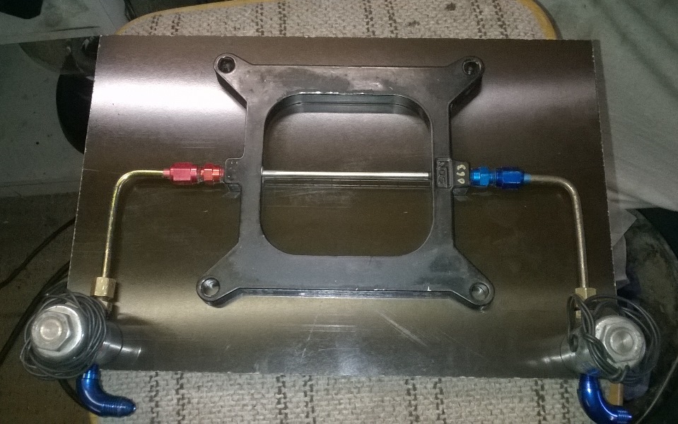

I'll be replacing the 2" carb spacer with a 1", a 1/2" with 'ears' to support the solenoid and the N2O plate.

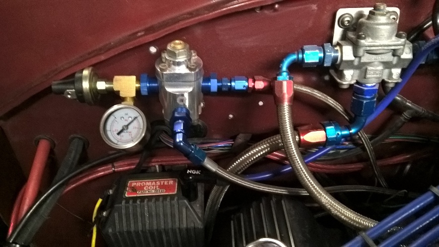

I'm teeing off the main fuel line at the reg, running through a separate reg with gauge and N2O safety shutoff to the plate.
Currently jetted for 100hp, I may drop to 50 to try it out. I won't go over 100 until I can swap to forged pistons.
Tufnal sheet.jpg (213.24 KiB) Viewed 1694 times

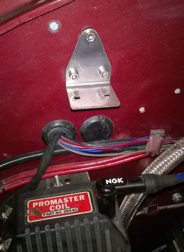

Reg bracket.jpg (236 KiB) Viewed 1694 times
Shiny bits.jpg (200.11 KiB) Viewed 1694 times
N2O bottle.jpg (212.32 KiB) Viewed 1694 times

Nice one Paul that should wake the old girl up a bit !!!!
And add a bit more strain to the gearbox :D

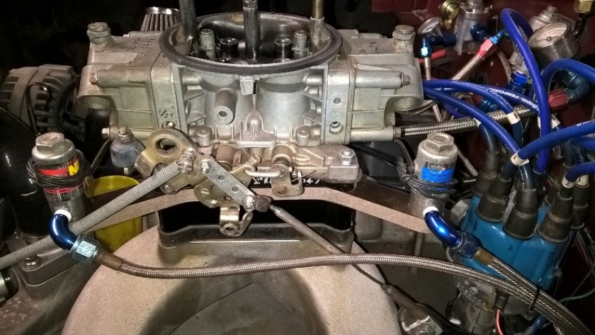

I've replaced the 2" carb spacer with a 1", plus my home-made solenoid mound plus the N2O plate makes it back up to a 2" riser.
It's not fully plumbed in yet and I've not wired it up but it's looking the part :D
N2O solenoids mounted.jpg (242.08 KiB) Viewed 1552 times
N2O Fuel reg.jpg (239.11 KiB) Viewed 1552 times

How are you activating it? WOT Switch?
If it is a DP then sometimes it is easier on the Secondary arm.
Yes wot Pete. Thanks I wouldn't have thought of that!
