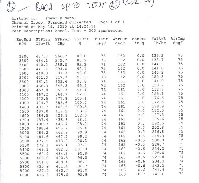

Had the motor on the dyno yesterday
492.8 TQ @ 4700 RPM
490.5 HP @ 5600 RPM
Did 8 pulls in all including one with fuel at -37 c ( had no effect at all on a carb`d motor but will definately work on a rootes blower according to Dennis who has had cooling issues with Steve Nimantis` blower set up ). Slight oil leak from the rear seal but no dramas.
Big thanks to Dave Billadeau for all his work ... he`s done a lovely job and would recommend him to anyone. I`M VERY VERY HAPPY WITH THE MOTOR :D

Jon Connolly
Posts: 3116
Post by Jon Connolly »
Hi Latil
Thanks
Surprisingly, race gas had absolutely no effect at all, so premium unleaded it will be.
C/R is 11.2.
Will also get a lambda sensor on the exhaust with a handheld so I can keep an eye on its state of tune

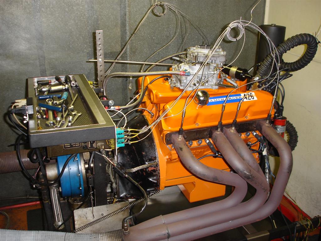

Where was that outdoor pic taken Jon? Or more to the point, who's/where is that 64 plym? :love10:
BTW, I was gonna ask where you got it dyno'd but, seeing the pics, I dont need to ;)

Jon Connolly
Posts: 3116
Thanks all
Rob Twin ............ That 64 Plymouth is right up your street, really nice car ( HEMI TOO )
