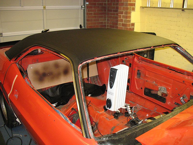

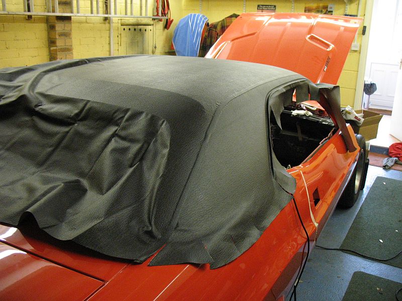

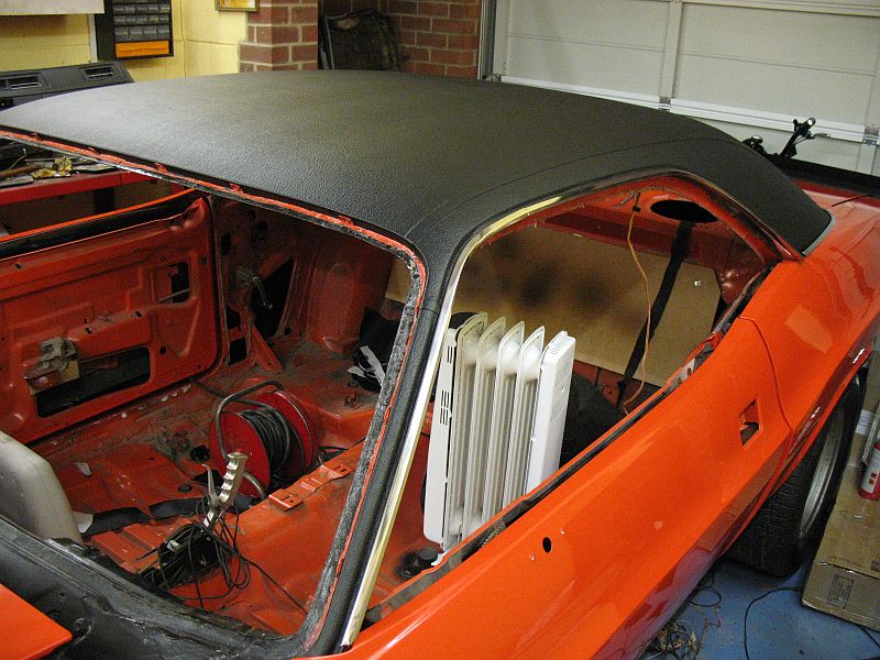

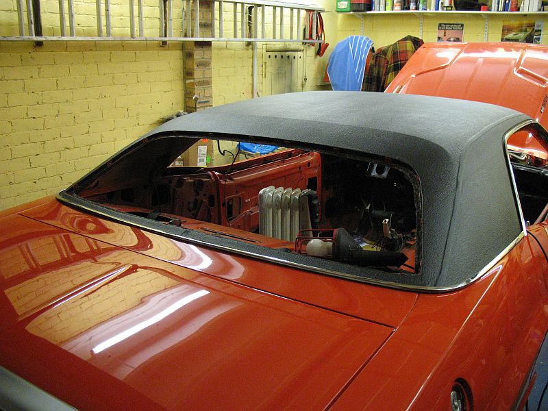

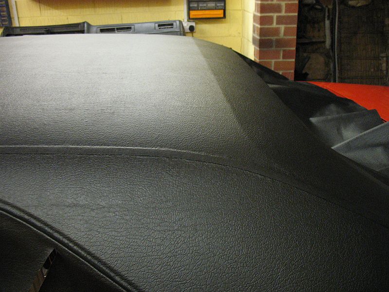

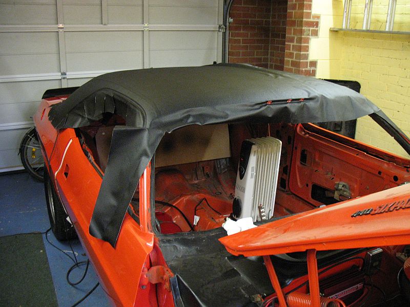

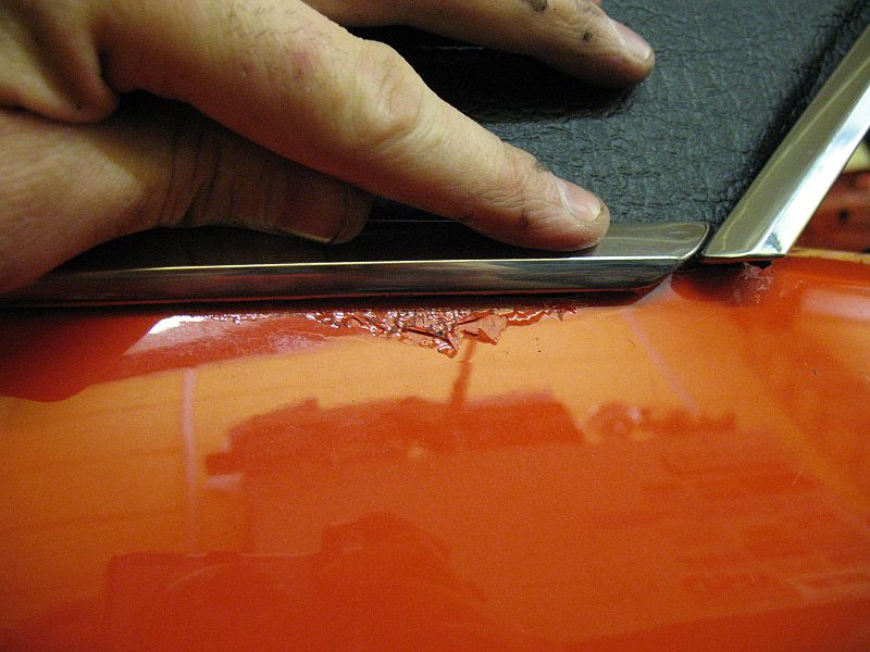

Oh well. The vinyl top is now on.
Not as hard as I thought it would be actually.
But a hell of a lot more hard work than I expected. About 3 hours work in total. But I had to take a couple of rest breaks. Man it was heavy work. Made more painful by getting the hairs on my arms glued to the roof a few times. :lol:
The trim in the photos is not screwed down. Just pushed on to hold the edges.
One bit of DISASTER though. The body paint has melted on a spot where I accidentally overshot some of the spray adhesive. I was holding the spray can very close to spray up the bottom edge and the solvent in the spray must react to the paint.
Don't know what i am going to do about that. It was all going so well as well. :(

Sorry to hear about the hiccup. What are your options? Will you have to get the quarter resprayed?

Bananarama! Dave! Sorry to see that! But it is fresh paint, so should blend OK.
Is that a solvent based glue? I am surprised if it is! I used some glue for that once, it was messy, but no solvents involved!! Great job though!

Jeff wrote:Bananarama! Dave! Sorry to see that! But it is fresh paint, so should blend OK.
The solvent is in the propellant. It seems to evaporate mid air. Like that party string stuff. It says on the tin use from at least 10 inches away but I was within one inch trying to squirt a little shot under the edge.
It is good stuff. I was impressed with it. Very accurate adjustable spray pattern. Very low fume. Didn't stink the house out and I didn't have to open the doors to stop getting high.
Adam68 wrote:Nice job Dave , notice the heater.
I had two heaters in there. There is a electric fire behind the passenger door. I switched them off half way through the job because I was sweating with the effort.
But the heaters helped warm the fabric. I also did some concentrated effort with a hair drier to stretch out the bad creases as much as possible before starting. It was still pretty wrinkled up before i started glueing though. I forgot to take a photo of it at that point.

Ahh I see. Real bummer Dave. But, as I said, easily fixed. Get one of the smart repair guys round to have a look at it. That is, if you dont want to take it back to the body shop.
