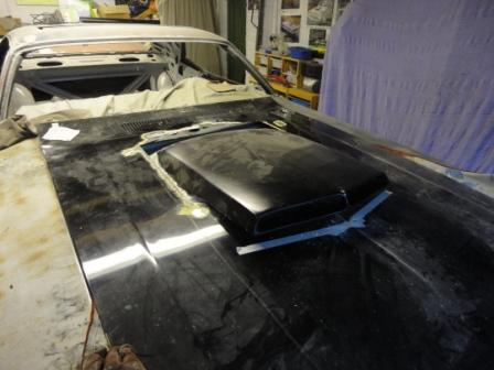

Hood scoop is on, now paint prep.

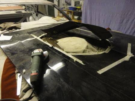

Rewinding a few weeks, this was real clenched buttocks time, taking an angle grinder to an otherwise excellent bonnet.
Clenched buttocks time.JPG (33.36 KiB) Viewed 2515 times

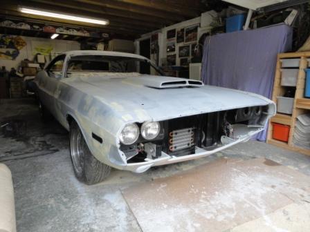

Worth the worry though, but did it make a mess or what? There is so much metal to cut through with the frame as well. Several discs later.
TA scoop.JPG (33.49 KiB) Viewed 2515 times
