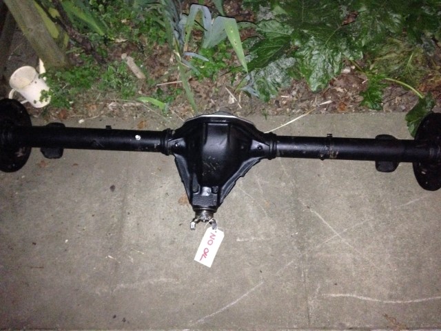

off to Antons or saturday for some exhaust surgery
but in the mean time have been visiting a chap called Geoff
gave him
Borgy warnery M78 housing from a valiant
Torqueline Torquelock for a VL Holden commodore
a big box o shims
a bigger box of bearings
Ring and pinion from a 92 firebird
a bag o bolts
a crush sleave eliminator from a ford 8 inch something or other
valiant wheel bearings
moser axles.
and said make work, please
he said the end of your pinion is too fat, i'll need to cut a bit off
once i'd workd out it didn't involve physical violence i said yes.
and last night i collected the fruits of his labour
and much to my relief my reaserch into what i could stick in it paid off
you can build a nice thing from bits of everybody elses axle
notice the white cover....so i can prentend to be a military landrover.
hey and when you turn the pinion...both wheels turn the same way
and they should all the time unless one of them comes off the ground
3.45
3.45
IMG_1206 (Small).JPG (101.05 KiB) Viewed 1640 times
John
Posts: 1904

is he an axle guy Dave? I'm needing some new gears in my Ford 8"
Johnny Dart
Posts: 852
Post by Johnny Dart »
Dave , that looks like my Dana, is it a "made under licence" jobby ?
Posts: 9561
Bryan wrote:is he an axle guy Dave? I'm needing some new gears in my Ford 8"
oh yes
rear ends a speciality according to his adverts
geoff hauser :)
i had plans to build it myself but with engine stuff taking up my time and such a mishmash of parts AND the fact that the mock up showed that the fat barrel of a centre i wanted fitted collided with the flat end of the pinion i spotted that i'd over stretched in my ideas and gone way beyond in expections of my own patients and ability
hence the only man i knew would have all of the sundries to hand to cover off anything i had missed got the job.
6-7 hours labour + 1 breather and job done
pleanty of places can put in the gears for you, couple of candidates on here. Just mine appeared to have the potential to be a Pig of a job and possibly need parts that most would have to get from america so i let Geof enjoy that challenge.
as it turns out wsn't a challenge geoff said "that was not too bad" and he didn't need to get anything in. and his labour cost is pretty bloody reasonable
Posts: 9561
Johnny Dart wrote:Dave , that looks like my Dana, is it a "made under licence" jobby ?
Borgwarner Australia...made them from mid 60s in a range of models where the name dictated the size of the ring gear. M60 6 inch M75 7.5 inch M78 7.8 inch or 7 3/4 they did M88 and M90 as well
they did beam axles IRS centres in open, cone based LSD and now do Hydratrac (TVR dodge Viper etc)
opend factories in indonesia south africa and kept base in australia
company split in to tranmission and axle sections trans section became part of the whoile T5 T56 Tremec thingy
the axle section became BTR engineering
then Spicer Axle Australia part of Dana
their products used in
ford holden Chrylser australia
GM US cars carmaro Firebird and later Monaro/Pontiac US police cars
TVRs
Morgans
Lotus carlton
Nissans
toyotas
southafrican military jeeps.
so if a car Was made in australia there will be a borgwarner M axle for it
escorts and cortinas got a 7.5 inch LSD that is way stronger than the english and atlas axles
viva got similar as the Torana
mines a 7.8 inch Borg warner M78 that was good for 280 Ftlb with 25 spline axles and a cone based sure grip
should be a bit better now with the 28 spline fatter axles and a centre similar to a truetrack
Dana UK no help at all with parts. they didn't even know what the axle was :)
