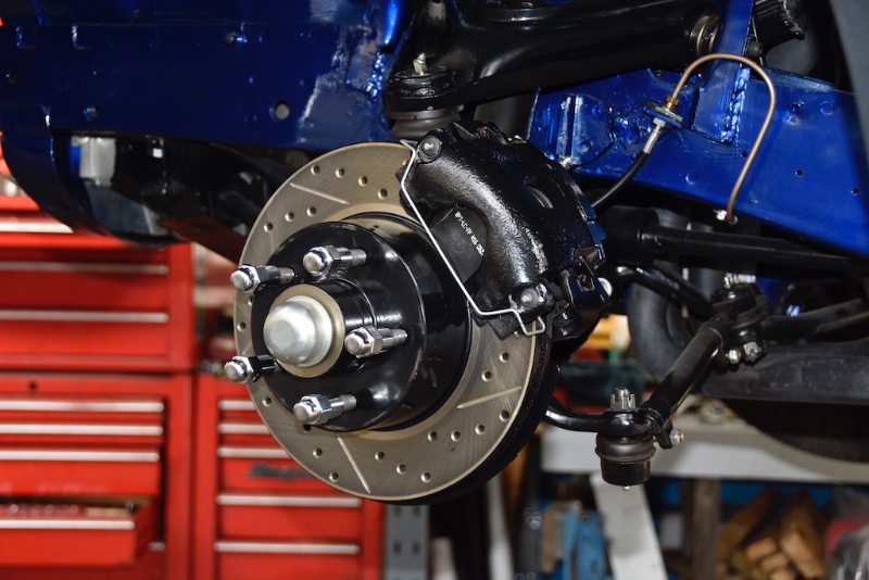

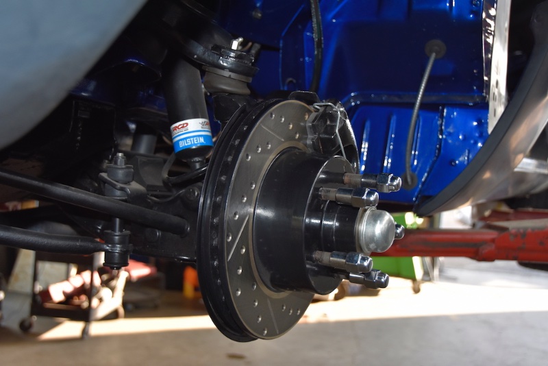

Completed the brake upgrade to discs from the old drums
_DSC4519 copy.jpg (116.89 KiB) Viewed 2804 times
_DSC4518 copy.jpg (140.01 KiB) Viewed 2804 times

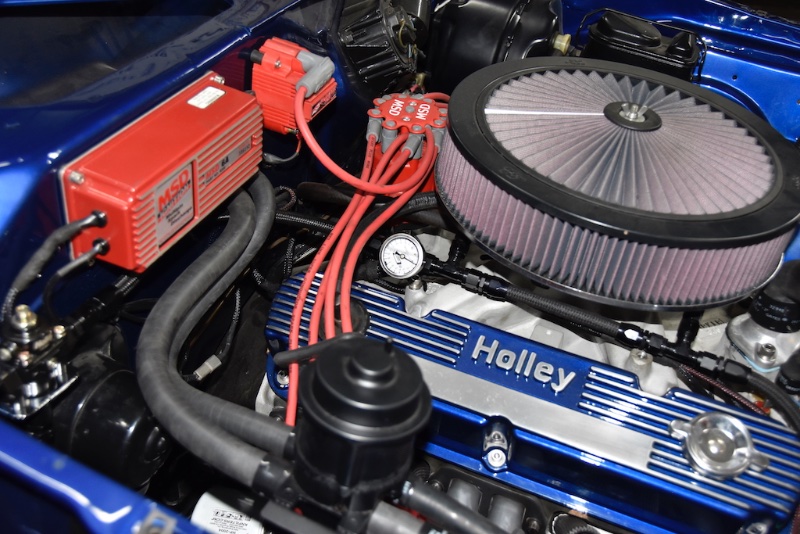

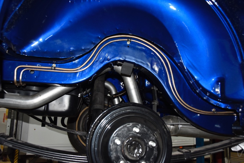

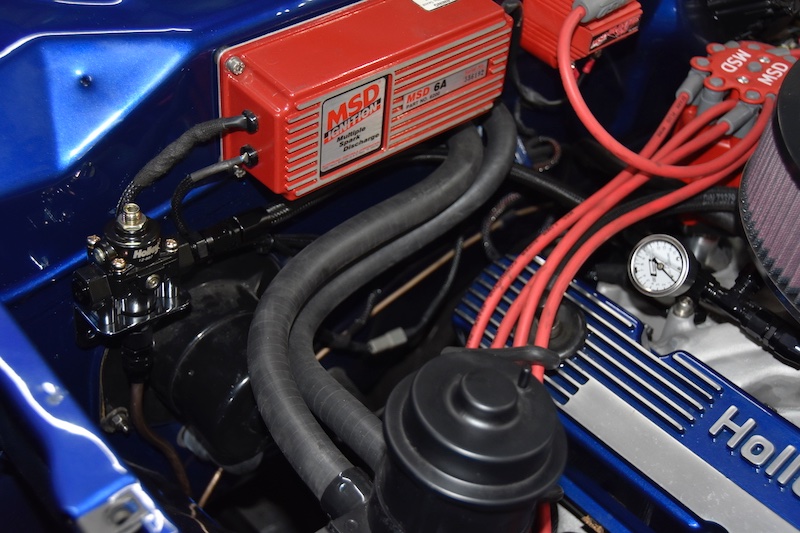

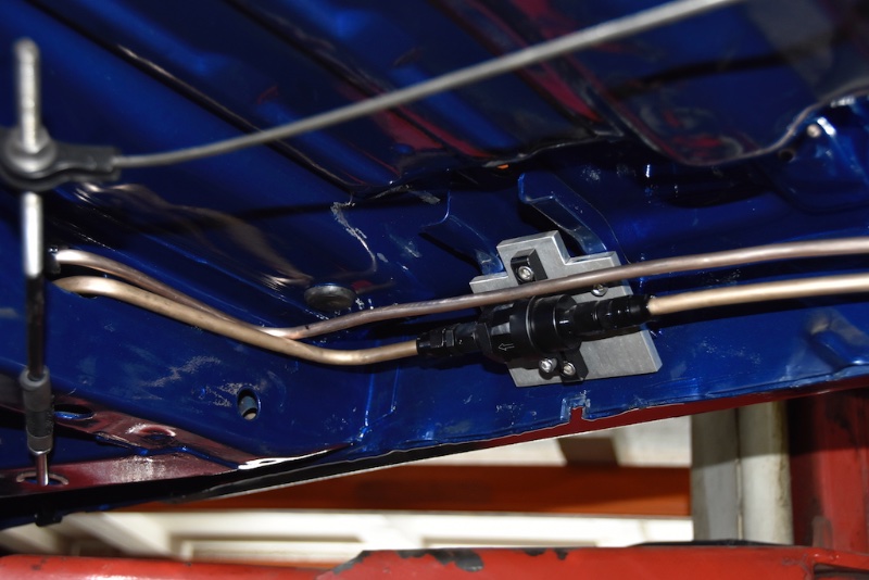

Run new 3/8 fuel feed and a 5/16 return line - really struggled to get a descent line with the long lengths of pipe without kinking!!!
Fitted an inline filter midway .
I've tried fitting a fuel pressure reg on the return side of the carb - Seems to work even though Holley tell me it's not correct , but I'm gonna try it anyway.
It all seems ok so far but not tested the road fully .

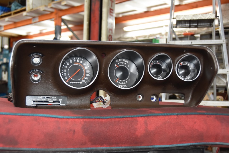

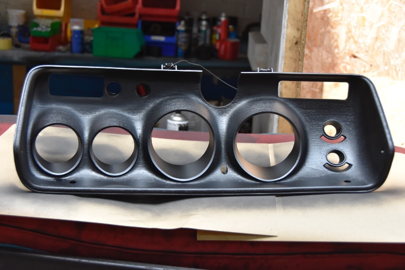

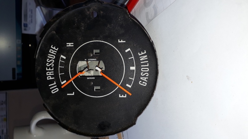

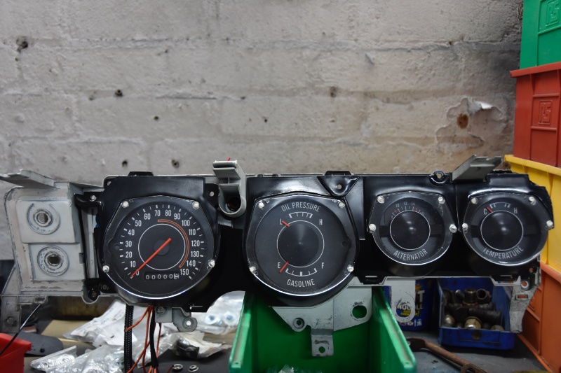

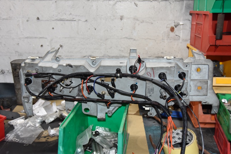

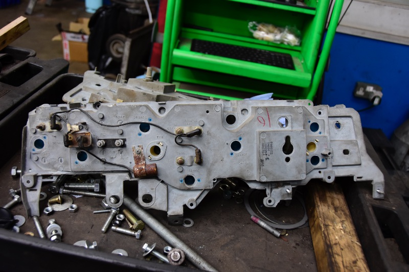

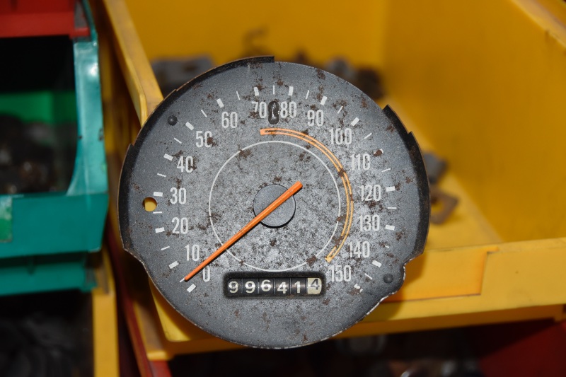

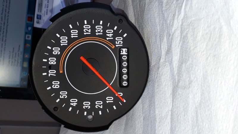

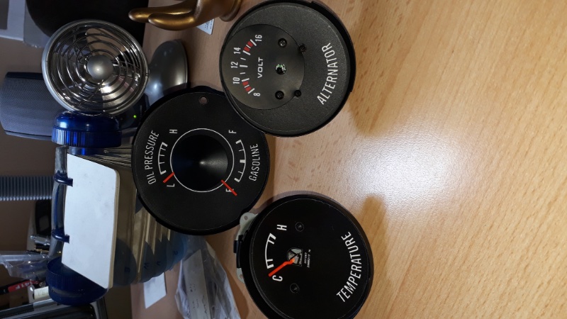

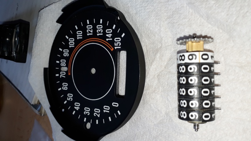

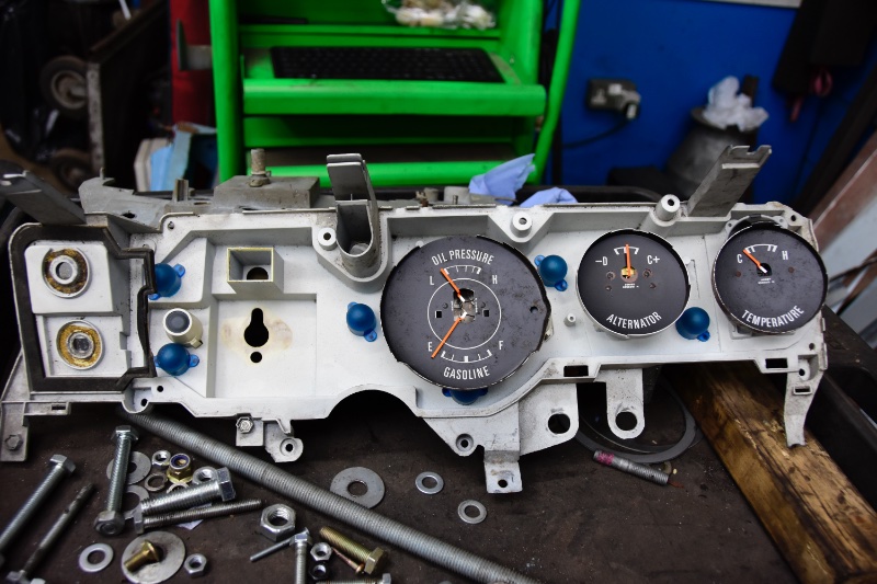

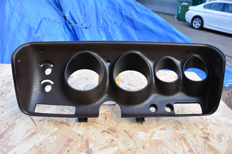

A few more pics from the instrument cluster rebuild
Pretty scabby looking so striped cleaned and painted in Matt Black then applied the Decals - the only fiddle part was the strips of numbers for the mileometer especially when you have sausages for fingers!!!
The miles on the clock before were over 99.000 so I decided to re-set to zero
Also painted the needles with fluorescent float paint.
If you notice on the Alternator facia I've swapped out the Ammeter for a Voltmeter- bit of messing around but nothing to serious

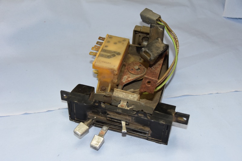

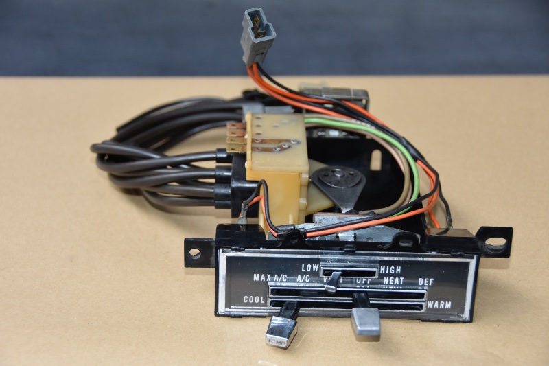

Cleaned up and rebuilt the heater control
Repaired the cracks and made a section for the dash facia so I could fit the old original radio back in - then painted it satin black and lightly coated it with a brown plastic paint then with a corse brush dipped in thinners dragged it over the wet paint to create a wood effect(amazingly it worked OK )

Dash looks superb. Where did you get the decals for the gauges?
kma176
Posts: 526
Location: Caterham - Surrey
Re: Kev's 71' Satellite Sebring Plus
Post by kma176 »
MattH wrote: Thu Sep 03, 20 9:10 am Dash looks superb. Where did you get the decals for the gauges?
www.performancecargraphics.com
