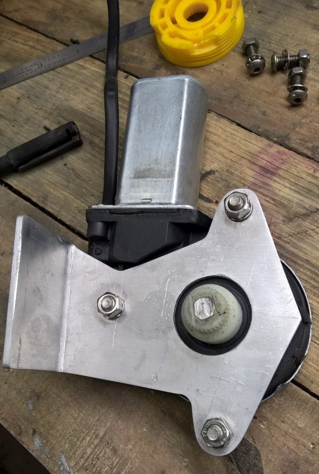

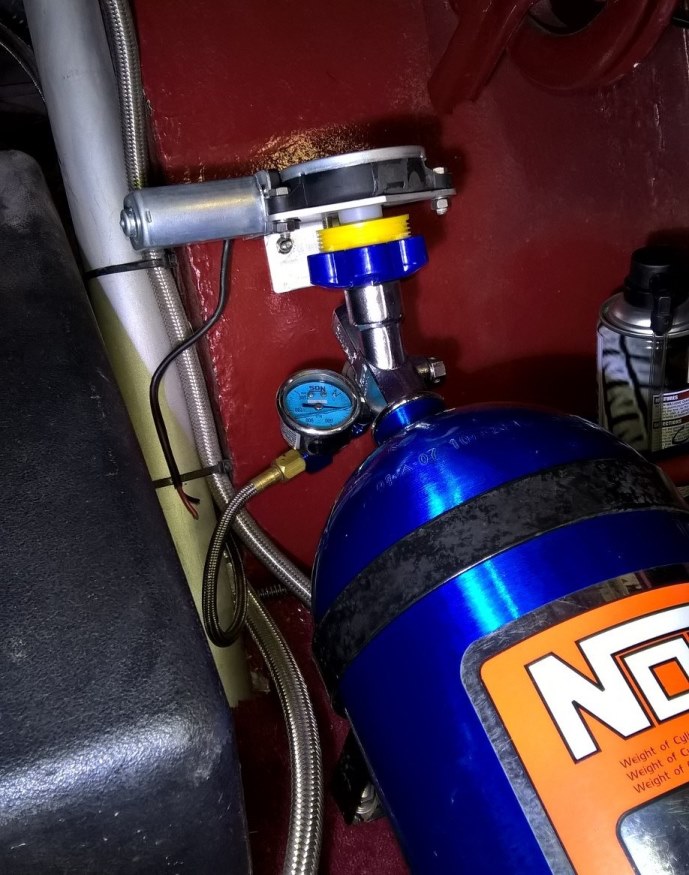

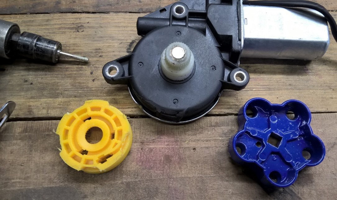

Then... my mate Kai was fixing the window in his Ford Fester and ended up with a spare motor which he donated to the cause.

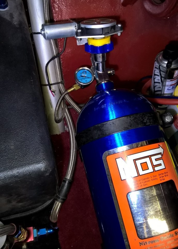

So a couple of evenings furtling and I almost have a free remote opener!
I turned the bottle knob upside-down and ground the wheel of the window mechanism (yellow bit) so it slots inside it. I made a bracket to mount the motor to the wheel tub. It's rigid enough to operate, but has enough play to allow for a bit of flex, and the bottle will slide out without having to undo the opener mounting bolts
Mechanically it works great, I just need my brother-in-law to come up with some clever electronics so it operates forward and reverse, and auto-stops.

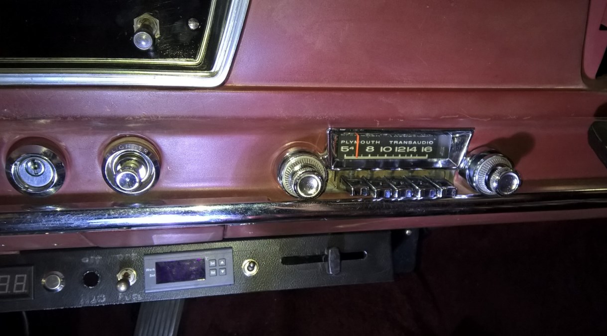

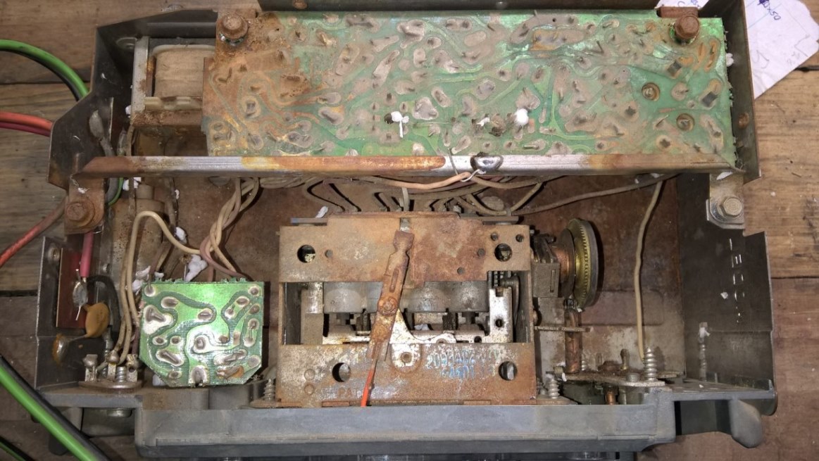

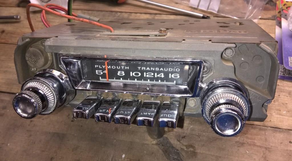

Found an original radio for the Belve
As you may gather from pic 3, it doesn't work. But then it was $30
It was also missing it's knobs but I knew I had some that would fit. Just the chrome fascias go for $70 so I knew it was a good deal.
I'd like an FM stereo/ auxiliary ouput conversion, but £360 seems to be the going rate

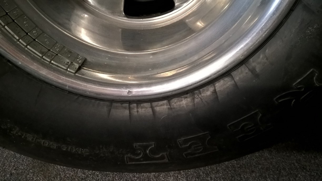

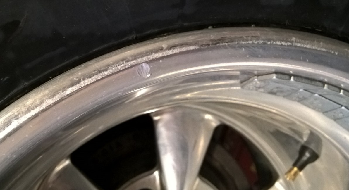

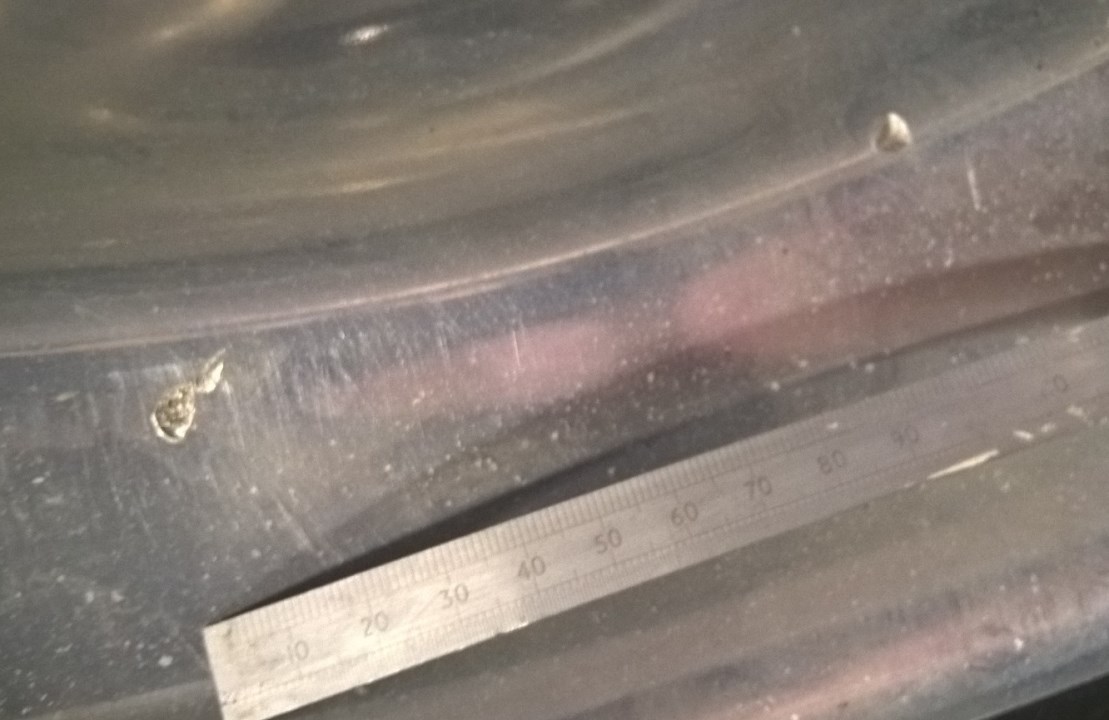

I picked up a nail in a rear tyre
Of course, as with everything on my car, it's...complicated.

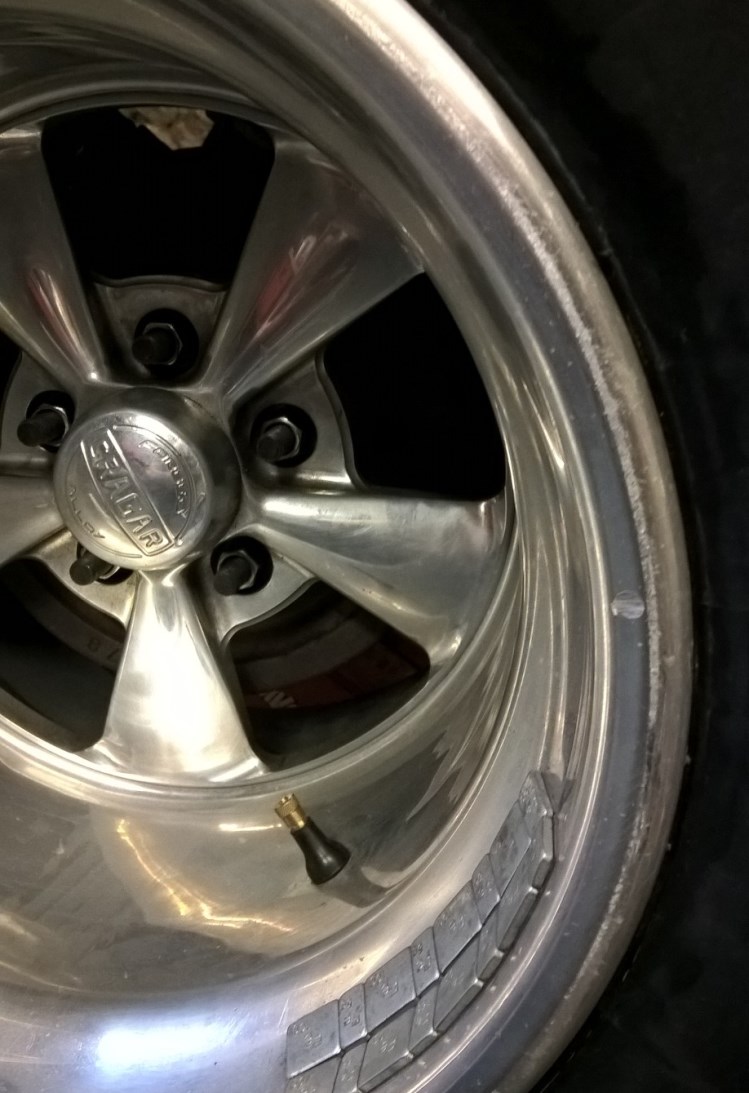

To get the wheel off I have to jack the car high and drop the axle. Nowhere local can fit it on their machine, so it's a 20 minute drive to an ATS that's used to tractor and lorry tyres. Well they fixed it, but bashed the bloody wheel too! 3 chunks knocked out of it and the rim scraped to hell. I didn't notice until I got home, so off I go back there for them to deny all knowledge. So now I'm waiting for a call from the manager on Monday, I think I'm going to have a battle on my hands...

Well I got in touch with the area manager and emailed him photos. There will be a full investigation, which is good. Their main defence was that the tyre machine couldn't have made those marks.
Well luckily I noticed these lever marks on the tyre so I have proof they didn't use the machine!

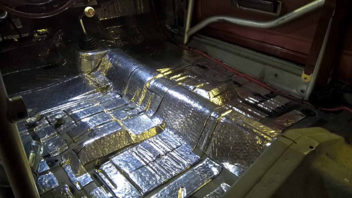

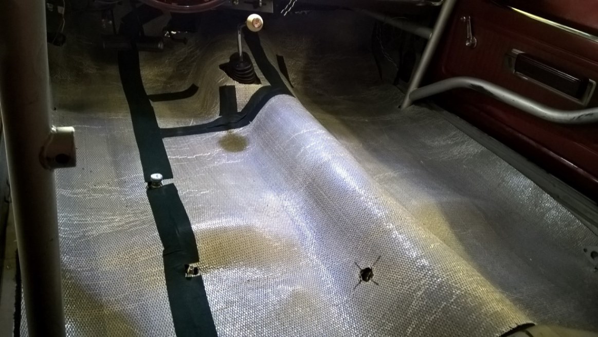

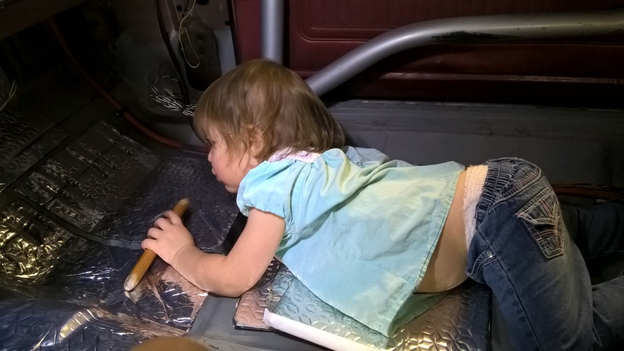

So here's the floor Dynamatted (Actually Skinz- same but cheaper) with my usual helper...
Then carpet underlay. £13 sq m, 10mm thick rubber crumb. No more wet dog smell, lots of sound absorption properties, very comfy underfoot
I did a neater job of relaying the carpet, quality control was on hand as you can see

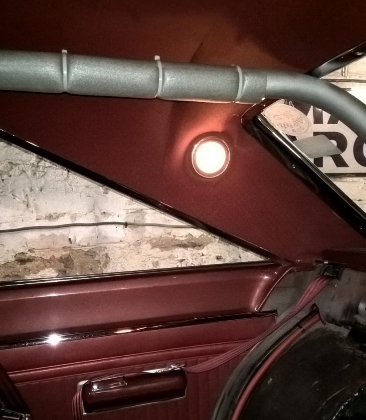

While the carpet was up, I got some wiring sorted-
The C-pillar lamps now work off the door switches. I might wire in a manual over-ride switch otherwise the battery will forever be flattened by the girls playing in the car!
My remote nitrous bottle opener now works from a dash-mounted switch. I haven't figured out an auto-off so I have to count 1.75 seconds to open or close.

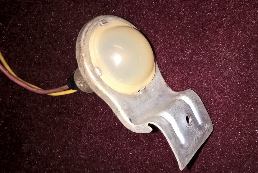

There's one under-dash lamp too, I need another if anyone has one?
