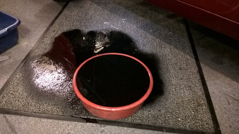

Another important lesson... Check your continer is of adequate size for the quantity of oil in your engine...
- WP_20171014_001.jpg (163.57 KiB) Viewed 2717 times

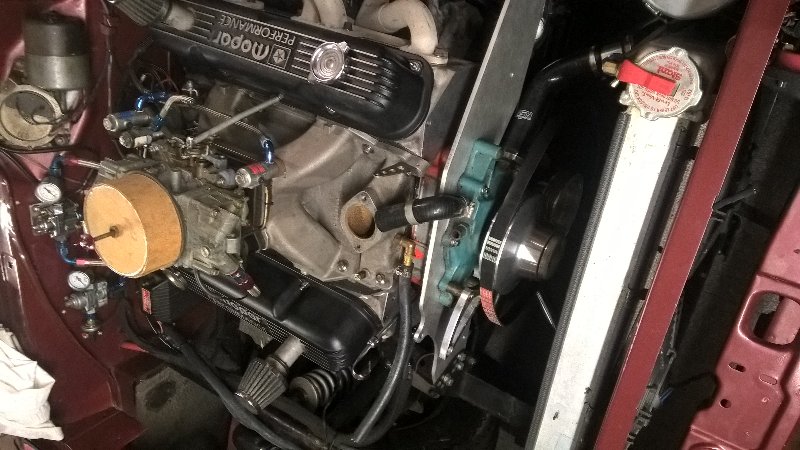

Well after a shaky start I made some decent progress this evening
- WP_20171015_00_45_02_Pro.jpg (151.66 KiB) Viewed 2715 times

So what have you done to position the cam in the correct place ????
Re: db's 66 Belvedere
Oh balls, don't be throwing doubt in my mind again mate!
I've screwed the bolt into the end of the cam with the dished washer so it pulls the gear onto the cam. I can't remember now but the gear must sit against a flange or shoulder on the cam? Anyway the chain lines up and there's no fore/aft play so I'm sure it's right now.
