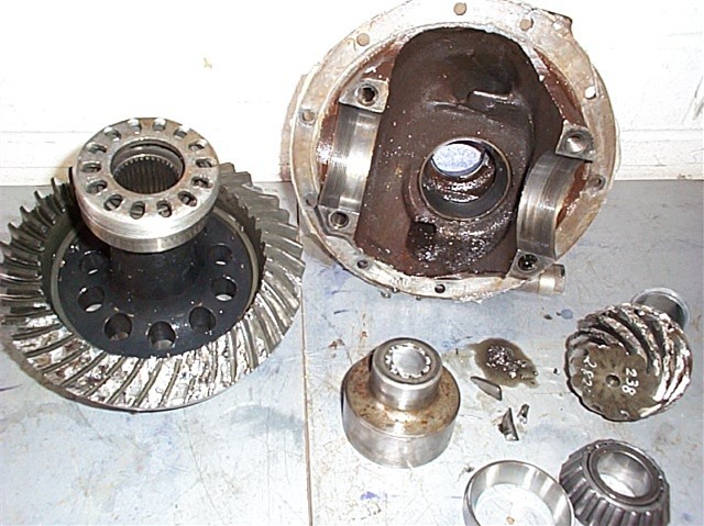

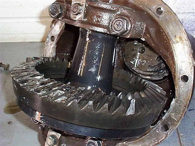

Here's some pics of Johnny Mental's 742 centre section which was behind a Blown Nitro Chevy small block in The Happening slingshot...........(Running in the 7s)
ring and pinion2.jpg (99.1 KiB) Viewed 374 times
ring and pinion1.jpg (107.93 KiB) Viewed 374 times
