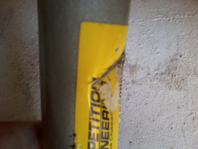

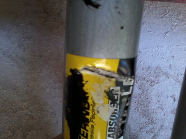

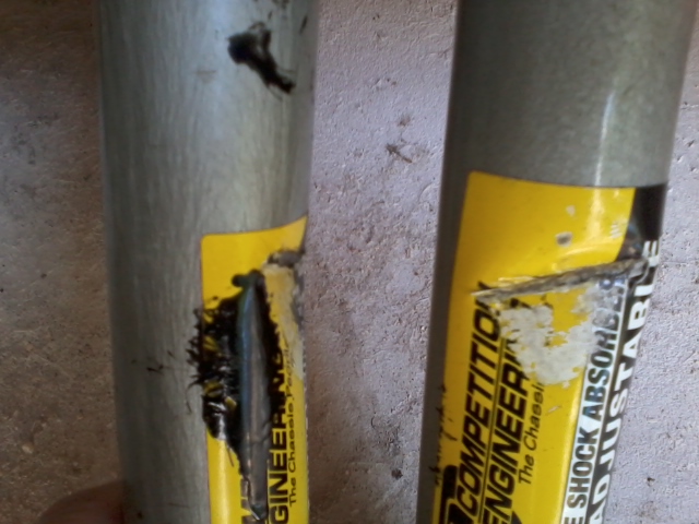

Well the garage is built and water tight so i finally got the car out of storage and got on with doing the things i have been gobbing on about..First order of the day get it to run straight.... first job fit Caltracs and mono,s.....During the strip down find the shocks bent....this is stopping them from any movement,and possibly why the car started to take a tilt now and again...So a phone call to my old mentor and A bod guru and hopefully problem is solved ,well almost...

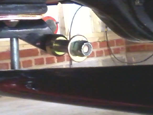

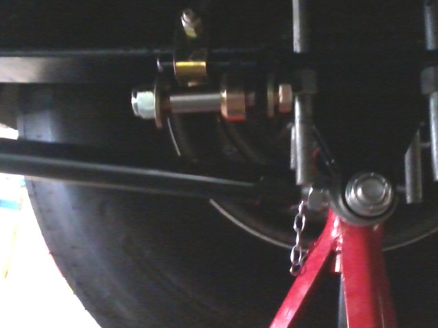

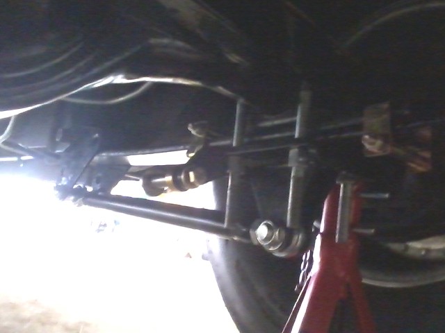

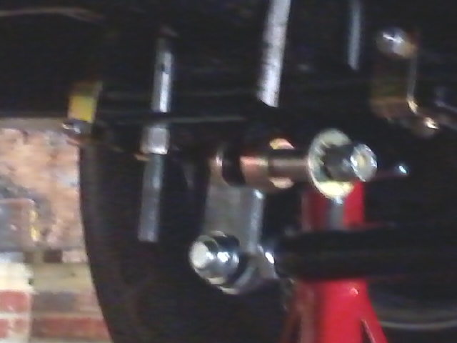

Blue advised me to mount the shock mounts towards the front .So the shocks will be on the front of the axle.Allowing the shock to move freely.I must admit i did not fancy cutting two slots in the brace,sort of defeats the purpose of it when its cut. So all fitted no dramas and no hammers needed...

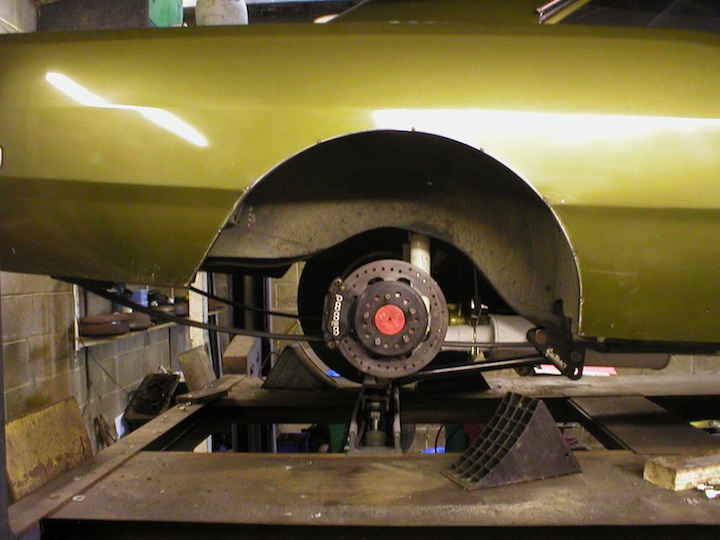

Not a great shot Pedro, but you can see how I got around the back brace issue.
