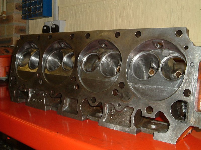

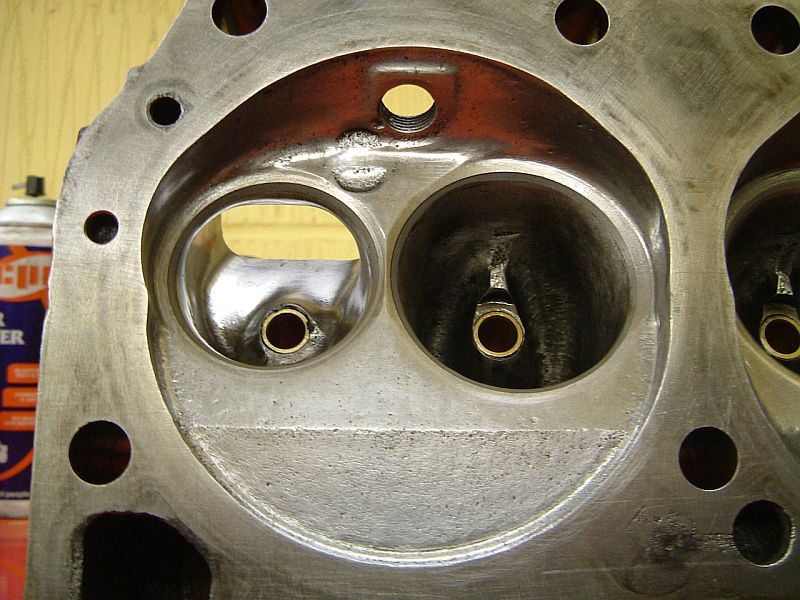

Mainly for the curious and the guys still learning I thought I would post some photos of our cylinder heads. I have just cleaned up this one.
The heads are the most important part for making power. If they flow too little they limit the power you make. However if they flow too much than you need for your application then they do not work as well and you can actually loose some power. In particular at low rpms.
These are stock type 1968-1970 "906" cylinder heads. They have been fitted with slightly bigger than stock valves and hardened valve seats for unleaded fuel. the ports have then been "ported" by Dave Hughes to his "Stage 1" spec.
This entails opening out the port bowls to the size of the new valves and enlarging the stock port runners slightly. Anything in the stock casting that gets in the airflow (like the valve stem guide) is smoothed. He leaves them with a smooth surface finish on the exhausts and a slightly rougher finish on the intakes. He also cuts valve reliefs into the sides of the chambers to give some airflow around the back edge of the valves.
I have then taken them a little further by polishing the exhaust runners even more and smoothing the combustion chambers to get rid of the rough cast finish. I also blend the floor of the chamber into the valve seat and blend the valve reliefs in a bit better. These reliefs are matched with notches cut into the top of each cylinder just above where the top piston ring comes to.
There are two reasons for smoothing and polishing. One reason is flow. the better the airflow the more fuel and air gets in each cylinder so you make more power.
The second reason is to reflect heat.
The more heat is contained in the engine cylinder during combustion the higher the gas pressure and the more torque you make. Also less heat gets into the water jacket.
The same with the exhaust. The more heat is kept in the exhaust the cooler the water in the engine and the faster the exhaust moves down the exhaust pipe. This draws more spent gas from the cylinder making more room for fresh air and fuel.
These are small things but all these small things add up.

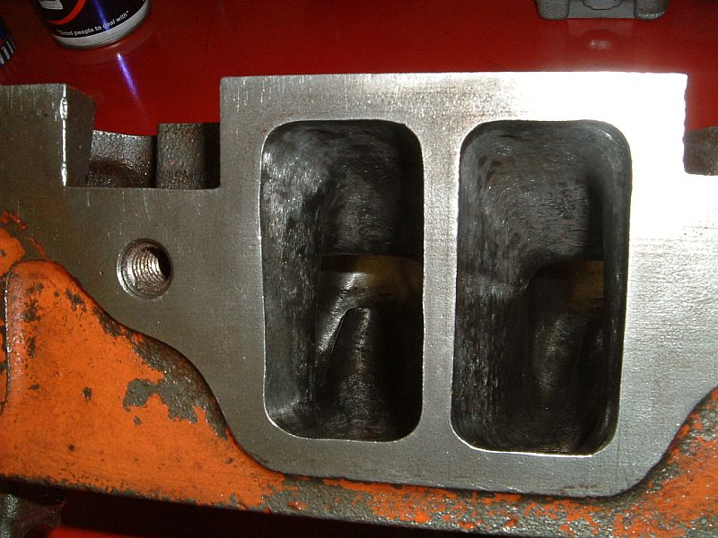

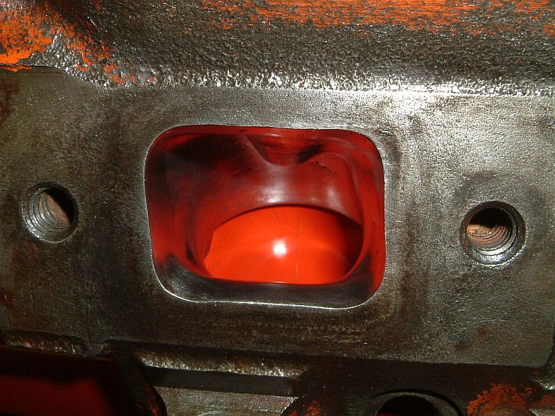

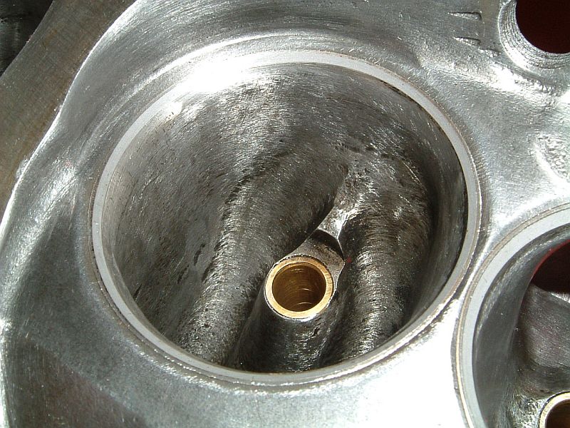

- Surface finish in the intake bowls is left on the rough side. this helps keep fuel in suspension.
- Intakebowl.jpg (138.48 KiB) Viewed 7999 times

- This one intake valve seat gets a little thin in one spot but is still within spec.
- Chamber.jpg (109.43 KiB) Viewed 7999 times
- Head
- head.jpg (105.54 KiB) Viewed 7999 times

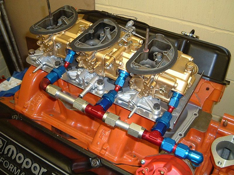

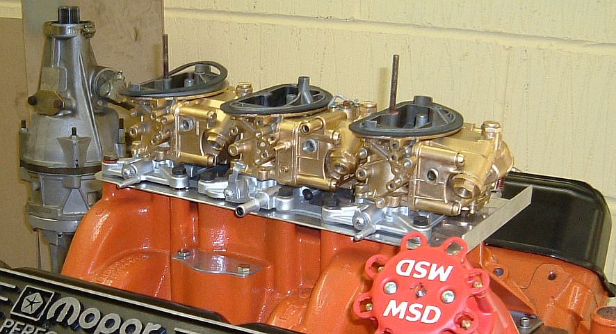

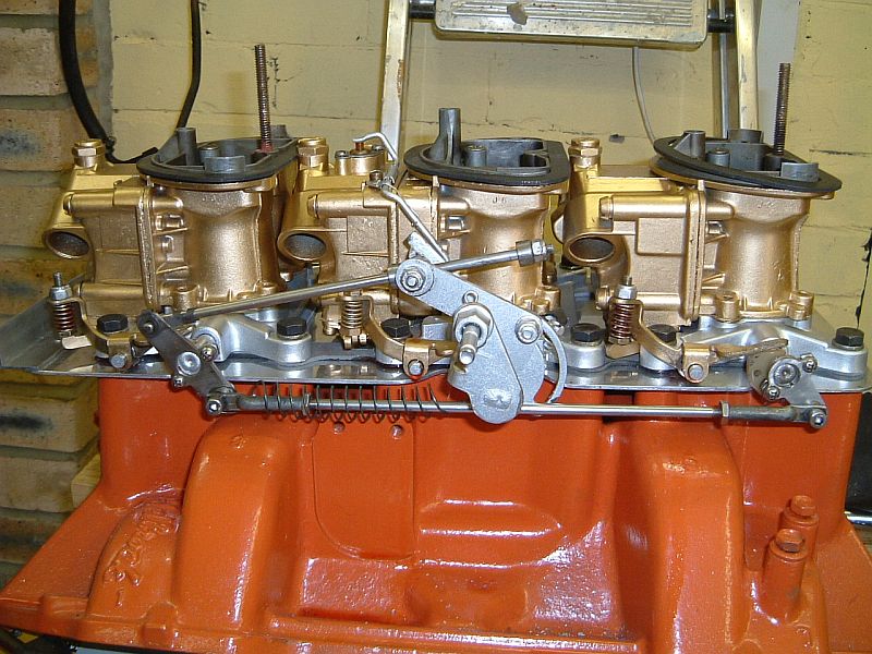

Here are some shots of the manual six pack set-up. It is not quite finished. This is just a mock-up to get the rather complicated linkage working as it should.
- I just want to stress again that with the air filter on you can't really see any of this.
- DSCF0005.jpg (110.56 KiB) Viewed 7938 times
- Note the lack of any of the vacuum diaphrams you would find on a normal six pack.
- DSCF0003.jpg (111 KiB) Viewed 7938 times
- DSCF0001.jpg (126.91 KiB) Viewed 7938 times

This looks a mess.
I am trying to run -8AN right up to the six pack and then branch off on -6AN into each carb.
I have managed it but I think it looks ugly. It does not help that I have found one of the carb adaptors is a bit thicker than the rest (center carb) so it kinks the "fuel rail" slightly. I will move thet one to the far end I think.
And yes Duncan. I am going to take the gold paint off the carbs and give them a bit of a polish instead.

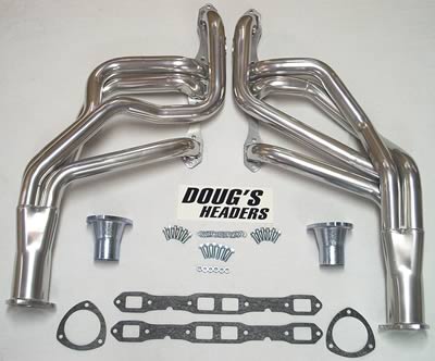

Thanks mate. I still have not made up my mind but probably Dougs as they are a few hundred dollars less that TTIs and I have not heard of any fitment issues. Bit of a gamble. But time will tell.AllKiller wrote:Fingers crossed, Good luck to ya Dave and Diana.
Ceramic headers they sound nice, what make ??
I'm still wondering if 2" primaries are too much for my engine or not.
- Dave-R
- Posts: 24752
- Contact:
This is why I am wondering what to do. I do not intend to change the heads in the future. I don't want more power than it has now. I just want more efficiency and refinement from the engine. So what I want is something to work with the current combo. And last a long time.Blue wrote:I'd go for the 2" Dave, if you don't you"ll be wishing you had in a couple of years time when the wicks been turned up a bit more, do you see aftermarket heads in your future?
I may re-build the short block one day with lighter pistons and rods but that is about it.
My understanding (from memory) is that larger primaries will give less low end torque but more top end horsepower?
The new cam however should give more low end torque and slightly less peak horsepower than before. But the loss of horsepower is at the rpms above my shift limit anyway and average HP over my shift rpm will be higher.
So I am wondering how the 2" headers (3.5" collectors going into a 3" system) will effect the power curve??
Dave so the one on there now or were..... 1.7/8" s or 1 3/4 ?
Low to mid grunt is smaller and longer tubes
High end bigger and shorter tubes

Not really.AllKiller wrote:hope that helps
Yeah the existing ones are 1-7/8ths So only 1/8th smaller than the ones I am thinking of.
I don't know the length of the tubes but they look something like the photo below.
With well over 500hp at the crank I am probably boarderline between the current size and the 2".
