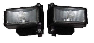

they are indeed handed
and you can put them on updside down
however the reflectors will need to come out again in order to swapsie
unless the holy grail has been found
and you have discovered an alternative light which fits
in which case you will be very popular in australia..
bezel is multi use fits either side either way up

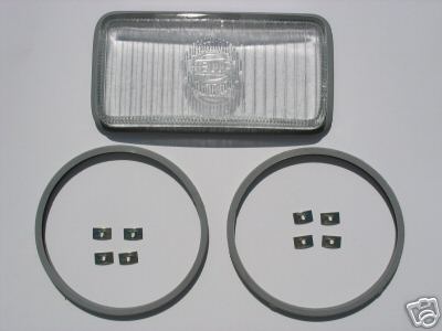

its the outer part of the lense bezel sandwich
lens
lens seal
reflector
Bezel
held together with
small metal push on washers
they tend to eat into and eventually corrode off the small metal spikes they sit on which are cast into the Bezel
meaning most lights are held toghter with bathroom sealant
a better method is to drill a tiny hole from the screw housing on the ouside of the bezel up the side of the reflector to a small reciver hole at the top
and use spring steel rod across the edge of the reflector
bend over spring steel at the screw end so it catches the screw head
this ebay chap does the seals
http://myworld.ebay.co.uk/hoon265/?_trksid=p4340.l2559
his are expensive
but much cheaper than Ray and Ray at PP&R
the bezels in the pics from PP&R are the correct way round
you deffinitly have the bezels fitted as that smooth bit next to the lens looks identical to mine....just mine is on the correct way round
and its chrome there and not black

RT lense seal and clips.jpg (14.5 KiB) Viewed 674 times

Dave as ever you are on the mark, I am missing the pressed C front flat light surrounds. Anyone have a pair ????
The rectangular finned bezel has been fitted the wrong way round, on the driving lights now rectified.
