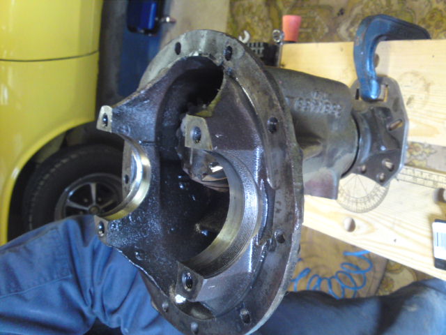

Lots done this week.............. new Centreforce clutch kit installed, along with the 71 e body box and pistol grip shifter, new shift levers and rods from Brewers, a new prop and a rebuilt and expertly set up Suregrip installed by Bacca, been a good week :thumbright:

Went out yesterday afternoon for a shakedown and see what it's like, Bananarama! me what a difference, shifts really smooth and positive, although I had got a shifter rebuild kit and new quick shift levers from Brewers, but the most dramatic change is the clutch pedal, when I first pushed it down I thought the friction plate wasn't even moving it was that light :shock:
The old box was in a bad way, almost all drivetrain vibration has disappeared, its super quiet too, got to adjust the pedal cos its far too high, a little bit of judder on take up but it'll prob settle down.
New Suregrip is well cool tho, but I was a little surprised when it still boiled the rears even in 2nd........... looks like I'll be pestering John S for his drag radials......... Can't wait to get it on the strip now :D

What ratio is in the axle Ade?
Can I have a drive of it next time I see you? Never driven a stick shift Mope 8-)
Soon be the Nats :Absynth: :pub: :woohoo: :thumbright:
Adrian Worman
Posts: 4376
Location: Milton Keynes
Post by Adrian Worman »
charger01 wrote:What ratio is in the axle Ade?
Course you can shagsy, it's got 3.23's in it which are a pretty tall, may still go with 3.55's if I think it's gonna get some track time, but the ratio is perfect for travelling across country to shows etc and still murders the tyres in Stony Stratford high street ;) :lol: :lol:

Nice Ade,GLAD TO SEE YOU BACK ON THE ROAD SO FAST ,I have those 3:23,s and I can still smoke em at will and a bit lazy out of the hole but the cruising at high speeds is so nice, i /we must bet be getting old I remember when 3:91,s or 4:10,s were the norm,I wish I had an O/D :( :thumbright:
