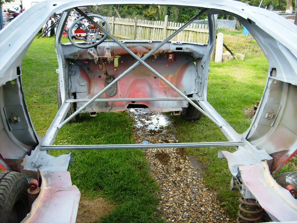

Jon Connolly wrote:50 x 50 x 1.5 mm box section now mig welded in place full length under each door shut ... this is to give rigidity to the bottom of the car to allow 2 pickup points each side straight into the box section
This will also be a good interface for finishing floor edges and supporting outer sills
Jon,
As the body is completely separate, irrelevant to the chassis, 50 x 50 x 1.5 Box section, seems a lot of excessive material for a body support, or is this part of the chassis ?
Jon Connolly
Posts: 3116
Post by Jon Connolly »
The box sections only weighed a couple of kilos each, happy to put them in rather than the body get bent
It isn`t part of the chassis per see but I do intend to support outer sills from this and mount the chassis via otriggers to this
FIRST TIME I`VE EVER DONE THIS ... NO DOUBT JERRY BICKEL WOULD DO IT DIFFERENTLY ;)

All rear arches and inner skins are out
Next it will go on THE BENTLEY SIZED JIG be squared up before the nose gets cut off, firewall removed and rear spring mounts cut out

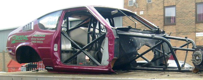

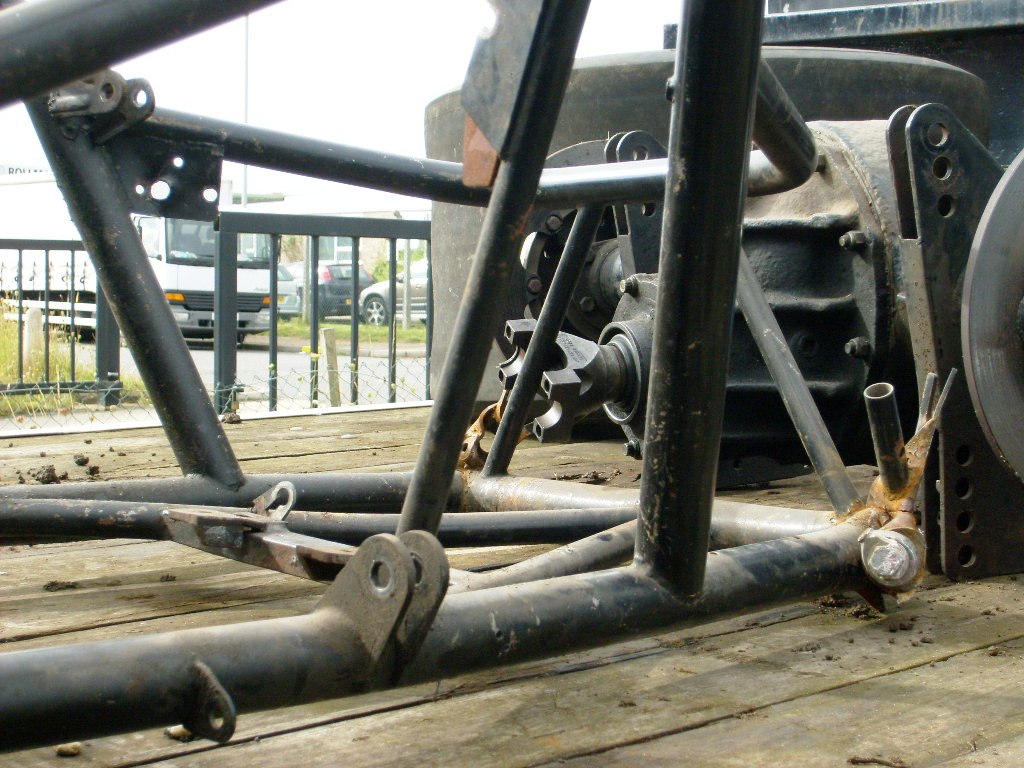

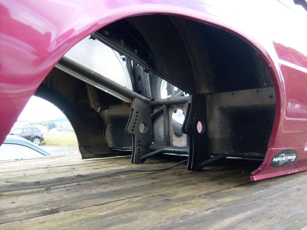

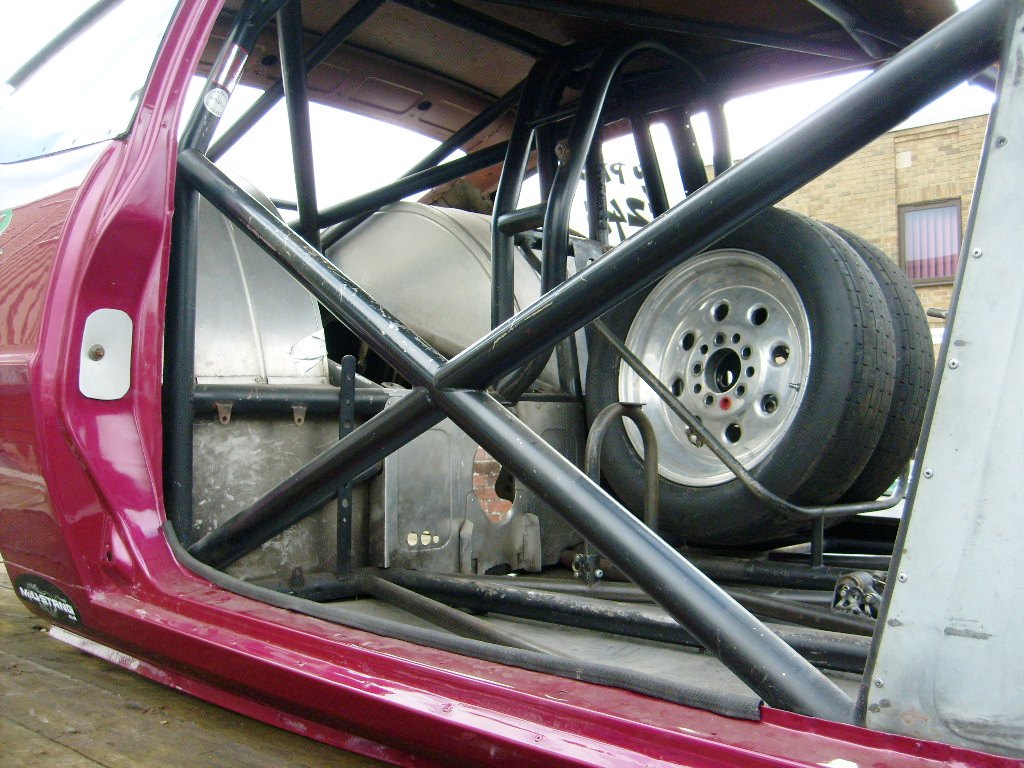

Jon Connolly
Posts: 3116
Blimey ... 4 months since I`ve been near this :oops:
Got the Plymouth Arrow this morning on the truck and Hiab ed it up in the air so could see all around and underneath it. The wheelbase of the Arrow and Daytona are a bit different and the rake of the screen is a bit different but should be able to " lose " the changes in the rear arches and the passenger cell. The front is damaged and will be straightened prior to cutting to suit the Daytona.
The cage still has a current tag to 7.5 and as I`m not touching anything behind the firewall should be fine ??
The Arrow body will be cut off and thrown away
Adrian Worman
Posts: 4376
Location: Milton Keynes
Post by Adrian Worman »
Nice to see it coming together Jon :thumbright:
Jesus built my hot rod
72 Challenger
65 Barracuda
Posts: 13000
Wow, that looks like a bullet proof tube chassis...tagged to 7.5 as well Jon, exactly what you need! ;)
