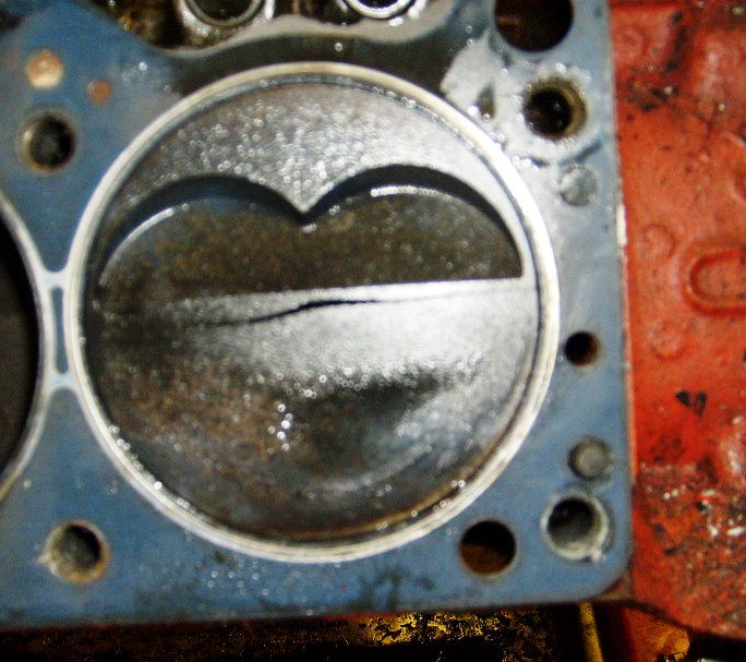

Well well well ... The previous owner had used the wrong bolts in the torque convertor. This threaded all the torque convertor lugs so he decided to spot weld the bolts in.
End result is the torque convertor was out of balance, bolts came out mid run and tried to eat the end of the camshaft seat, put the whole rotating assembly out of balance and broke a piston clean in half. Torque convertor in the bin, flex plate in the bin, block is ok
ALL FOR THE COST OF USING THE CORRECT 4 BOLTS !!

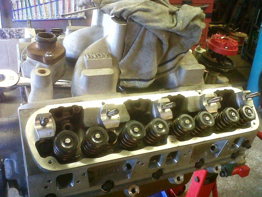

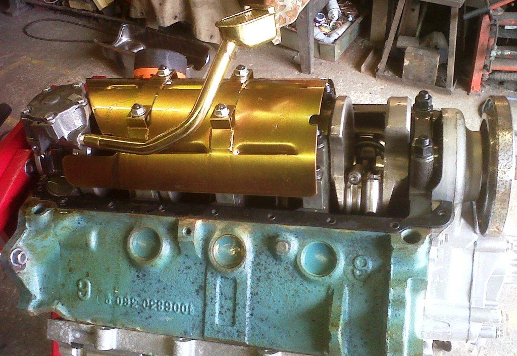

Just prepping the new motor to go in ( 408, 4 bolt main, forged assy, Indy heads with BB offset rockers ;) )
Just got to fit new auxillary gaskets, retorque everything, remote filter, set valve lash, machine and fit flexplate ( cut down 727 to suit 904 ext ), fit new torque convertor, install engine, fuel lines and rewire.

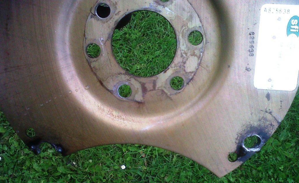

Here`s the route of the original problem .. a flexplate bodge which caused the whole rotating assembly to be out of balance.

New flexplate - 727 int balance cut down to suit 904 trans
