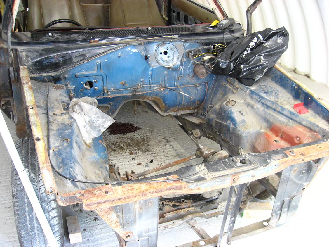

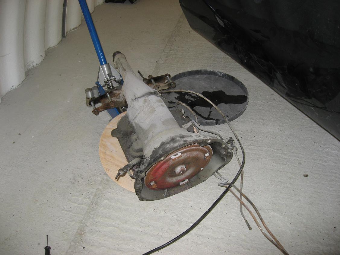

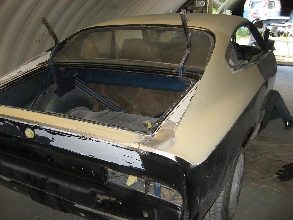

Spent some more quality time with the Charger yesterday...body's coming on nicely.
Resize 4.jpg (118.06 KiB) Viewed 1659 times
Resize 3.jpg (76.71 KiB) Viewed 1659 times
Resize 2.jpg (183.07 KiB) Viewed 1659 times
Resize 1.jpg (185.61 KiB) Viewed 1659 times
David Ward
'72 Valiant Charger in restoration

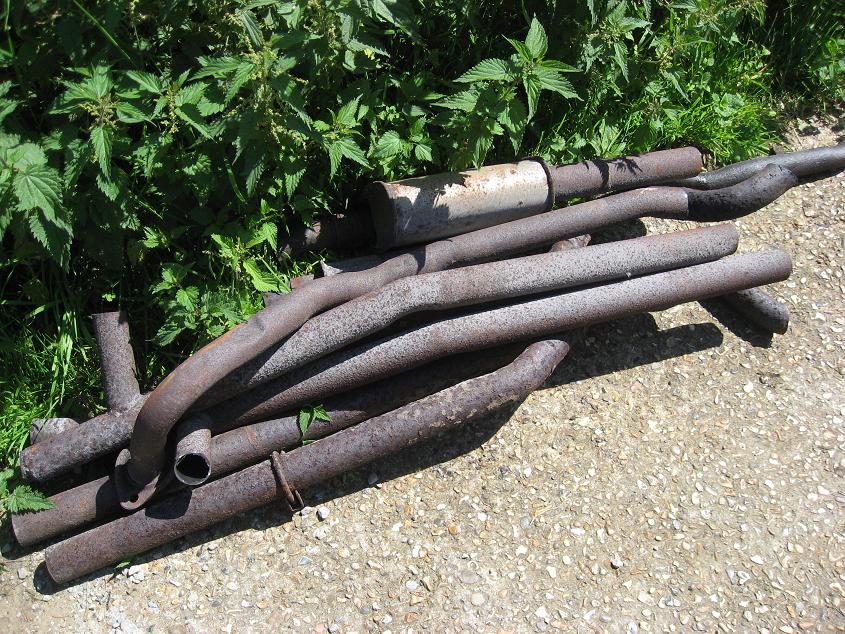

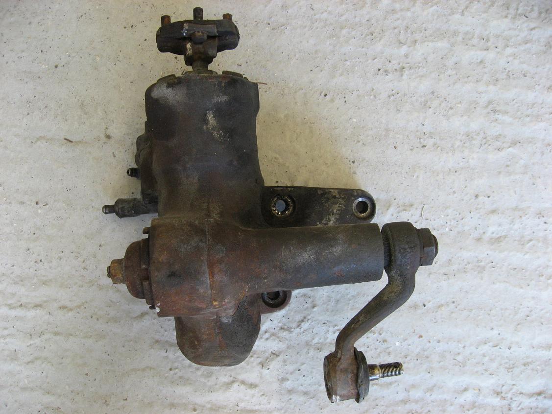

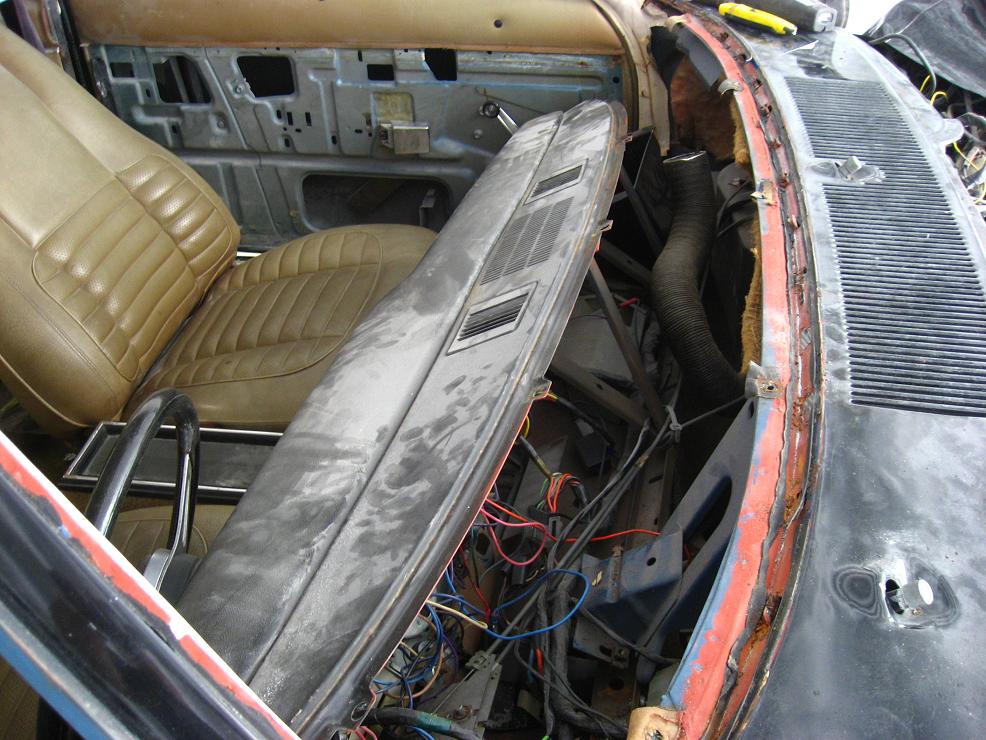

and some more...
Resize 7.jpg (135.89 KiB) Viewed 1652 times
Resize 6.jpg (135.02 KiB) Viewed 1652 times
Resize 5.jpg (101.23 KiB) Viewed 1652 times
David Ward
