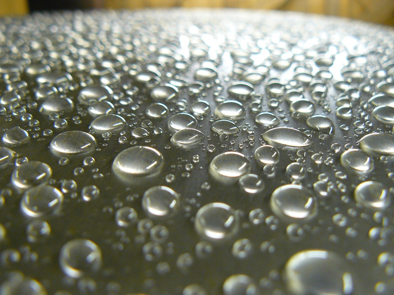

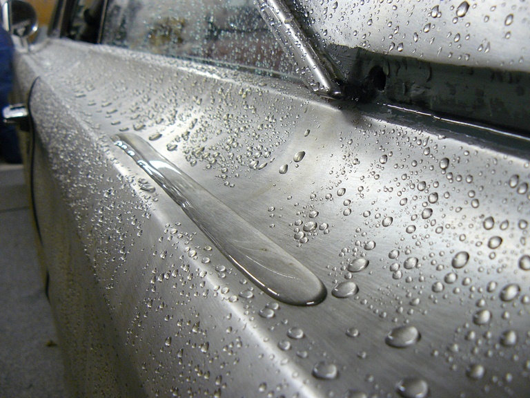

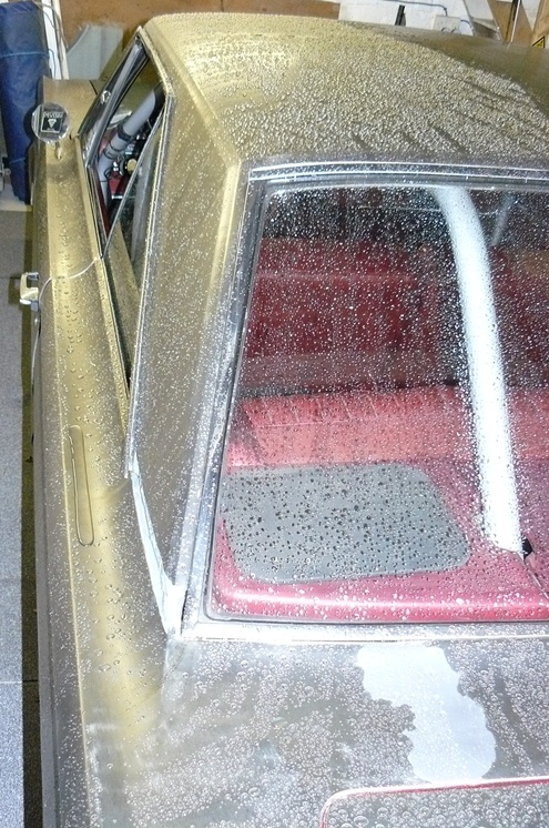

hi Dave, no leaks mate, just the Gibbs :thumbright:
I just went out to check on the car. None of the rain had come off so soaked up what I could with cloths and wrung them into a bucket. I took about half a gallon of water off the car! Amazing!
You can tell where I didn't put the Gibbs on properly :shock:

Bloody hell !!!!
Good stuff

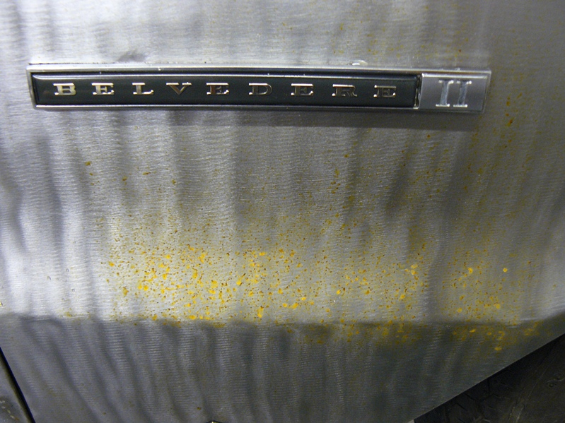

Well the top half of the car stayed rust-free apart from a few tiny spots.
The lower half though has gone pretty orange now it's fully dry. I'd say it's down to salt getting thrown up by the wheels as the worst is behind the arches. I've scotchbrited, cleaned and re-applied Gibbs wherever it needed it.
So as has been said already, it ain't no miracle but it's pretty damn good considering the car spent the whole day out in the rain, was driven around for a couple of hours on salty roads, then left wet in a garage overnight.

Great beading on the car DB.........Was the 8 year wait worth it? :thumbright:
