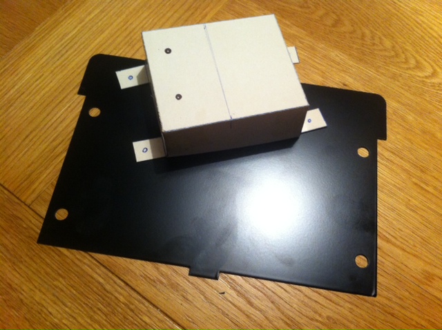

Headlamp Relay Conversion
What was the small metal case made out of Steve ???
Looks factory mate. Well done.
I won't believe the baked bean tin story !!!! :D
Posts: 7454
I made up a template then transferred that onto an old filing cabinet divider from the skip at work and hammered buggery out of it in the garage. Stuck a few holes with grommets in it and mounting lugs etc, and sprayed it up. Hope it works!!!! :thumbright:
Looks great mate. Better than ugly relays cluttering things up. :thumbright:
Posts: 7454
yeah....hoping to hide it down by the battery tray, out of the way but accessible if I need to get to it for repairs etc...should look ok when its dulled down a bit....couldnt find my satin spray to match the engine bay area...doh :oops:
